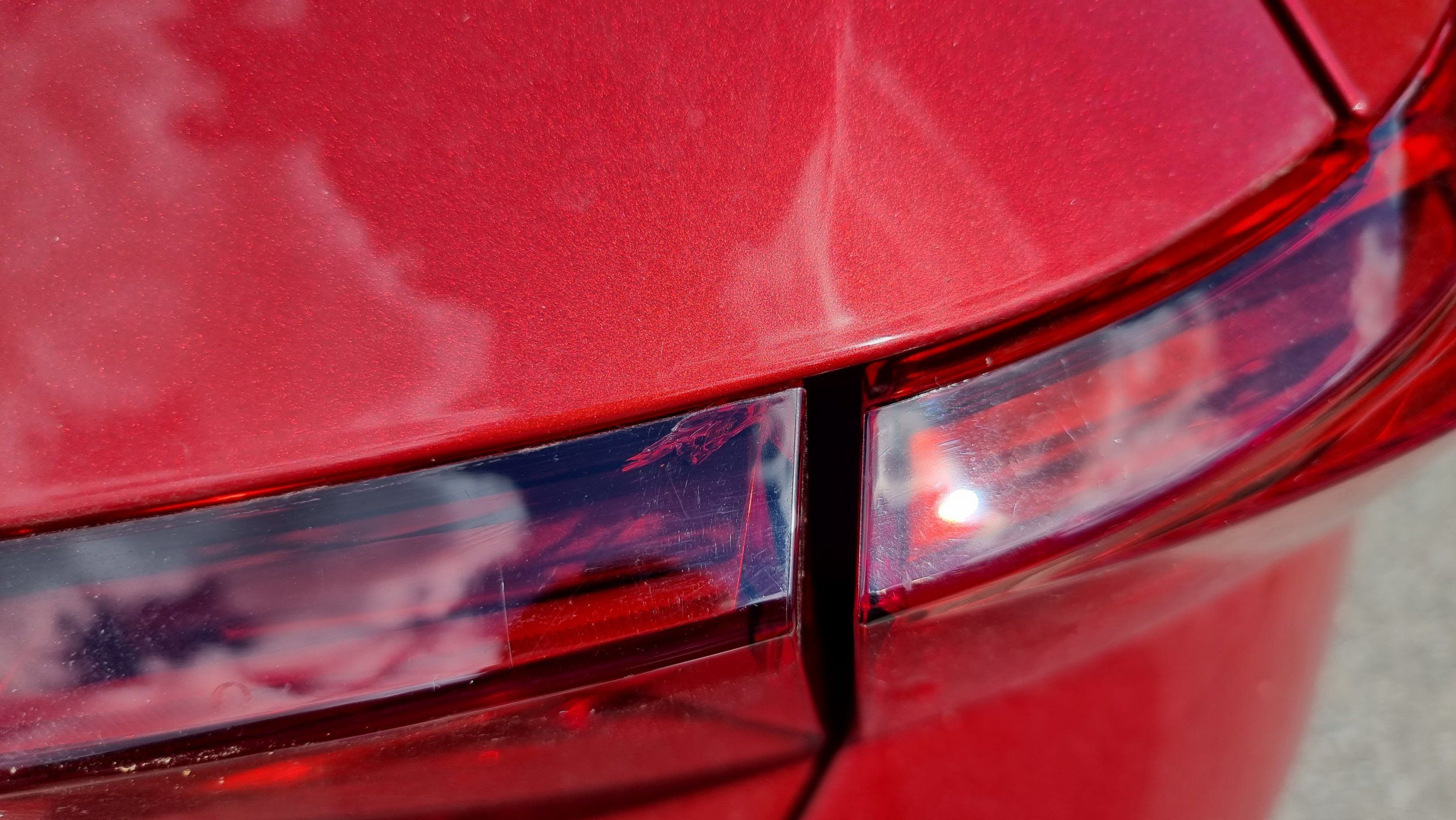

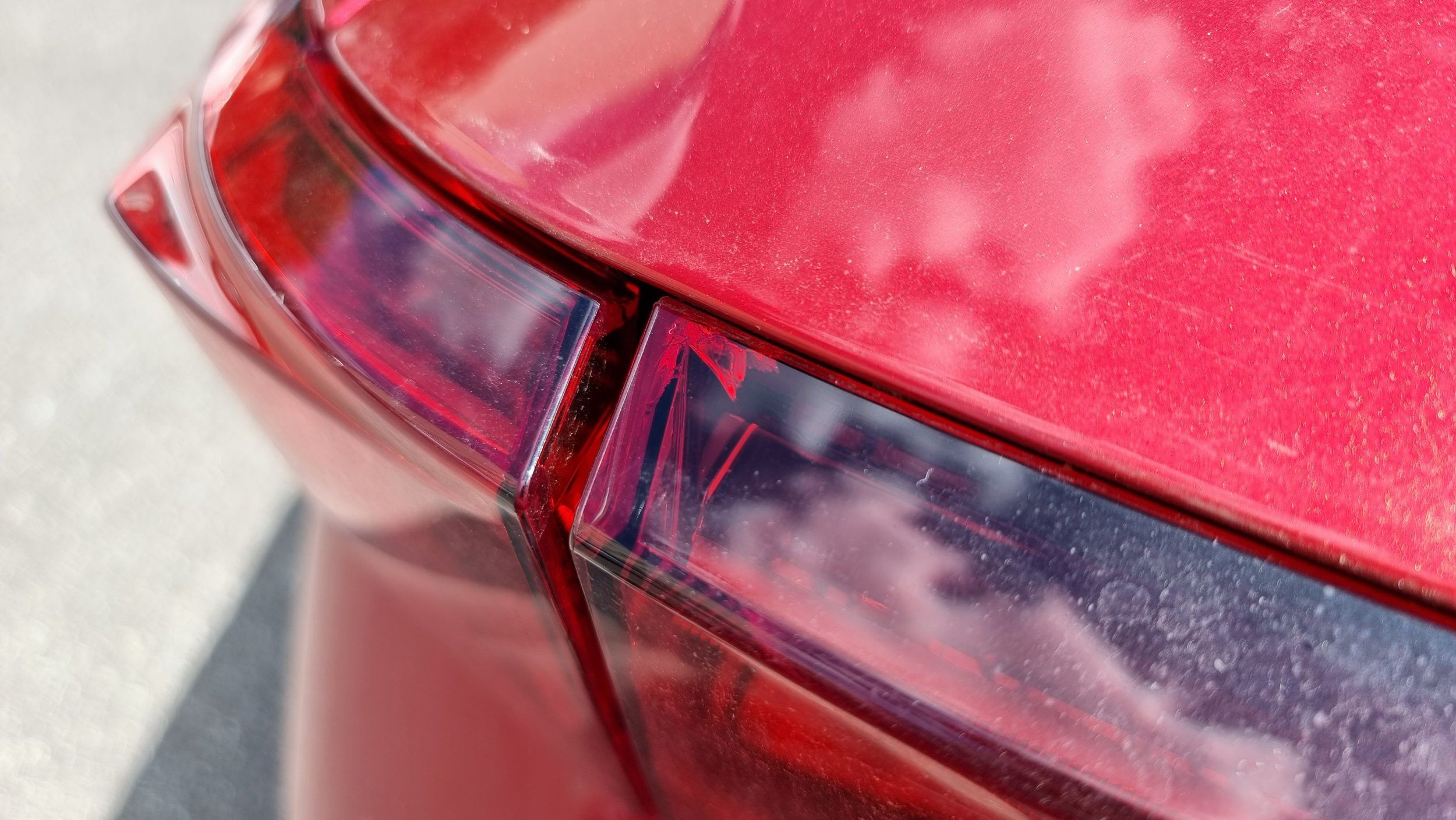

Hi guys! I just noticed that the light strip on the back of the car has 2 cracks, one on each side. I'm not aware of any mechanical damage on them. Can it be a manufacturing issue? Did you notice this on your cars? Is it covered under warranty?

It's on both lights in the same place - I'd say the light cluster has been over-tightened at the factory.

This seems to be a seat issue. The mk3.5 Leon Cupra had issues with cracked upper brake lights. Some got them replaced under warranty, but most didnt.

Cupra mate, I feel for you but would also need to warn you of an uphill battle with uncertain outcome. If you go Legal, then, they would ask you how long you had the car and when you noticed the cracks (the longer the period or, if you are not the 1st owner, the less your chances of success). They would also send an expert inspector to assess the situation. If the inspector finds scratches on your lights or in the surrounding lights area, then your probability of winning would be greatly diminished. Over tightening is a week argument as torque power tools are being used at the factory (at least this is what they will argue). Maybe you need to assess what is the legal bill you will be called upon to pay against the cost of replacing your tail lights. Or, try and negotiate with them once again if you reckon you may have a chance. Wish you the best of luck whatever course of action you decide to take.
Might be an idea for the owners to back off the torque on the bolts a little if there is access, however on the Leon that had this issue there was no bolts, the unit was clipped in, well away from the lens itself.

Cracking plastic is an issue SEAT have.

Just noticed similar cracks on my Leon Mk4. Car was produced in May, collected beginning of June.
Bump, this exact same issue happened to my mate. He thought somebody had hit him so had Seat replace at his cost in May 2022. Now it's happened AGAIN with the new unit, water is now in the cluster. Reverse and both night time lights are now broken.

Mine did not get worse for the last 4 months. While visiting my local dealership for an oil change I reported the problem. The response from polish importer is that it's caused by the wrong shampoo used for washing the car. xD Dealer documented the stuff and advised to observe if it's progressing.

I don't have this with my Cupra model as there is a ledge on the top of the boot lid for closing by hand. I only noticed this 'crack' after looking when my indicators were going really fast after a jet wash. I could see a crack in two places and condensation obviously shorting the lights. Its a year old so Im somewhat annoyed after a string of other issues, this is the final straw.
