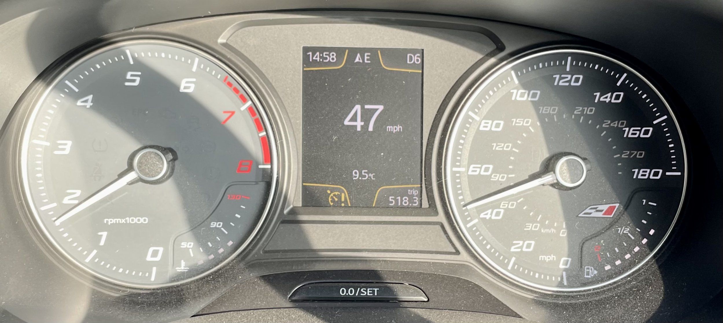

Anyone any ideas why cruise control has stopped working? No errors on the infotainment screen. Error on the dash. Stopped working mid drive.

To revive an old thread again, it happened again yesterday and today on the motorway. Car threw me out of cruise control, and whacked the yellow error symbol on in the cruise control section (bottom left).
There’s an intermittent P001100. And DCC front shocks were replaced recently, and mechanic says the DCC connector for one shock was corroded, so could be that?
