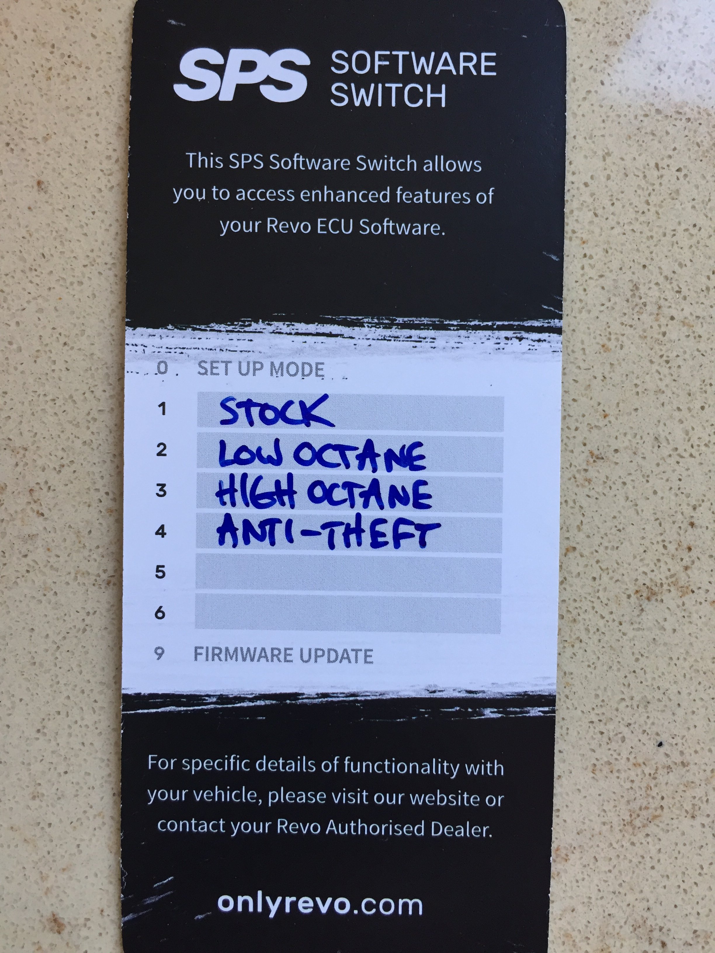

I cant get my hands on superunleaded so on the revo low fuel quality map I'd guess mine is closer to 350.
Next month I plan on rotating the tyres and seeing if octance booster , lighter rims and R600 induction kit can improve on the times listed above.
"I have a stage 1 280 dsg which dynod at 374 and the torque insert."​
If your car is tuned for low octane fuel already, octane booster is a waste of money.
If you were tracking your car and driving it hard for a prolonged time I’d recommend octane booster as a way of giving you more of a safety margin with your engine. But unless the engine is mapped for it, octane booster is just throwing money away.
My bad I probably should have mentioned sooner I have the Revo sps switch with both low and high quality fuel map options.
