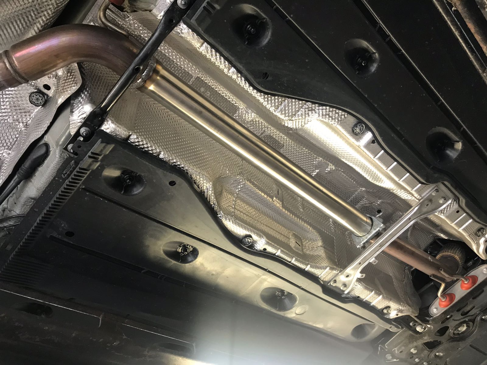

Is there any cutting of the original exhaust required? or is this simply a mechanical replacement, this looks interesting but would be wary of butchering a new car.
There is some cutting required to get the original resonator off but it’s nothing over the top and seems to be easily reversible.

Yes, I believe the original exhaust needs to be cut to remove the resonator. The kit I’ve bought comes with 2 sleeves which fit over each end of the mid section and can be used to re-fit the resonator section if you need to put it back to stock
I should have added that the kit I’ve got (Progressive Parts) has been specifically designed so that it can easily be removed to enable the car to be put back to stock, and it comes with all of the bits to be able to do so easily.

For anyone thinking of doing the Progressive Parts VAGSport kit here's a video of how easy a job it is to do. After seeing how simple a job this is I think I might give it a shot. It only involves 1 cut and 2 clamps. Old resonator can be clamped back in if you need to afterwards to go back to stock for whatever reason you need. Only giveaway will be that you will have an extra clamp in place of the cut you made.
