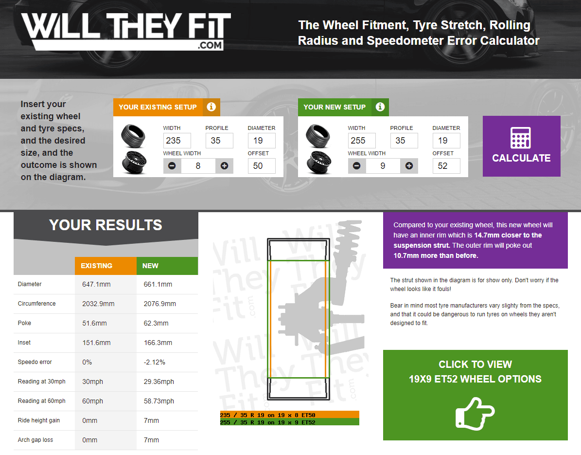

You can use a comparison tool like https://www.willtheyfit.com/
Standard wheels are 8.0 wide and Offset of 50. The Cupra R ST 8.0 wide and Offset of 45, and a lot of aftermarket wheels (Revo for example) also run 8.5 ET45 which give more poke.)

Just taken a look.
All 2012 Audi TTRS are 9" wide ET52:
So lets say you just stuck some OEM Audi TTRS wheels on your car, Would be like running an 11mm spacer.
Certainly gives you something else to work with.
From https://www.willtheyfit.com/
