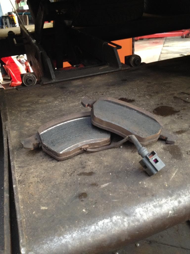

So I treated my cupra to a full service yesterday and would just like people's ideas for repairs. My front lower arm rear bushes are split so need replacing. Don't know weather to go for standard or poly bushes (anyone heard of flo-flex on ebay) I've also heard that TT bushes fit? Also need discs and pads all round. Rears are worn and this is what I found when I removed the front calipers to clean the pads up
[/URL][/IMG] measured the discs and were 280 on the front and I believe I need 312? Mintex drilled and grooved discs and pads all round for £171.96, pagid discs with ATE pads from car parts for less for £144.30. What discs and pads do you recommend? Don't want anything cheap and shoddy as I do fair bit of mileage

If yours is a facelift cupra 1.8T (which your picture and name suggests it is) then you need 312mm fronts. I replaced mine all round with Mintex pads and discs a couple of months ago. Performance is good perfectly adequate for road driving. My only complaint about the mintex discs is that the centre bit of the disc that the wheel mounts on isnt coated so it rusts, I believe some companies provide coated ones. No big deal I am going to paint mine with silver hammerite, but just FYI.
If yours is a facelift cupra 1.8T (which your picture and name suggests it is) then you need 312mm fronts. .
Mine is not a facelift, but has the 312 setup standard, the old pads looked exactly like in the pic. The only true way to find out is via your VIN at a dealer. Otherwise you may recieve bad advise. So many different setups were used on these.
One guy at ECP said I did not need 312mm as thats for the LCR with Brembo 4 pots so mine must be the 280mm. Well how wrong was he? I guess thats what has happend to a few other people, and without the know how or inclination to check they put the wrong discs on.
What are the chances of the outer edge of the pads meeting over the disc?? I'd suggest everybody should check theres before somthing bad happends.
