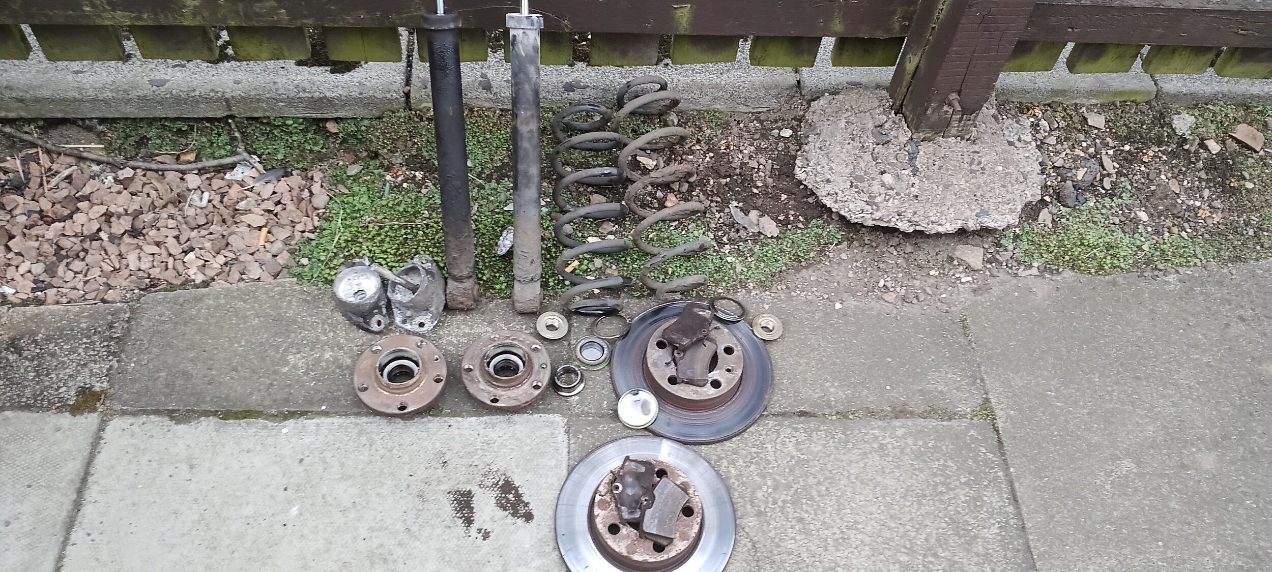

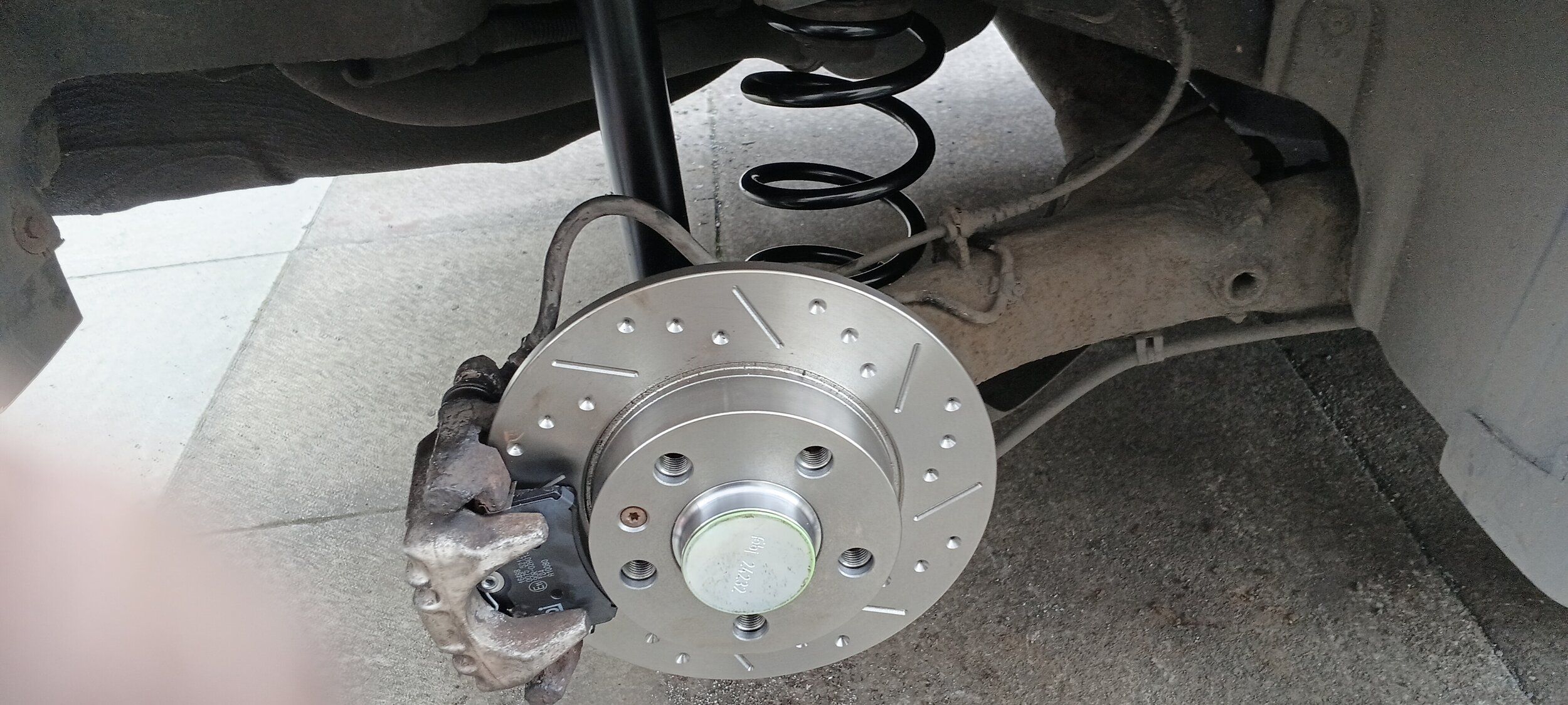

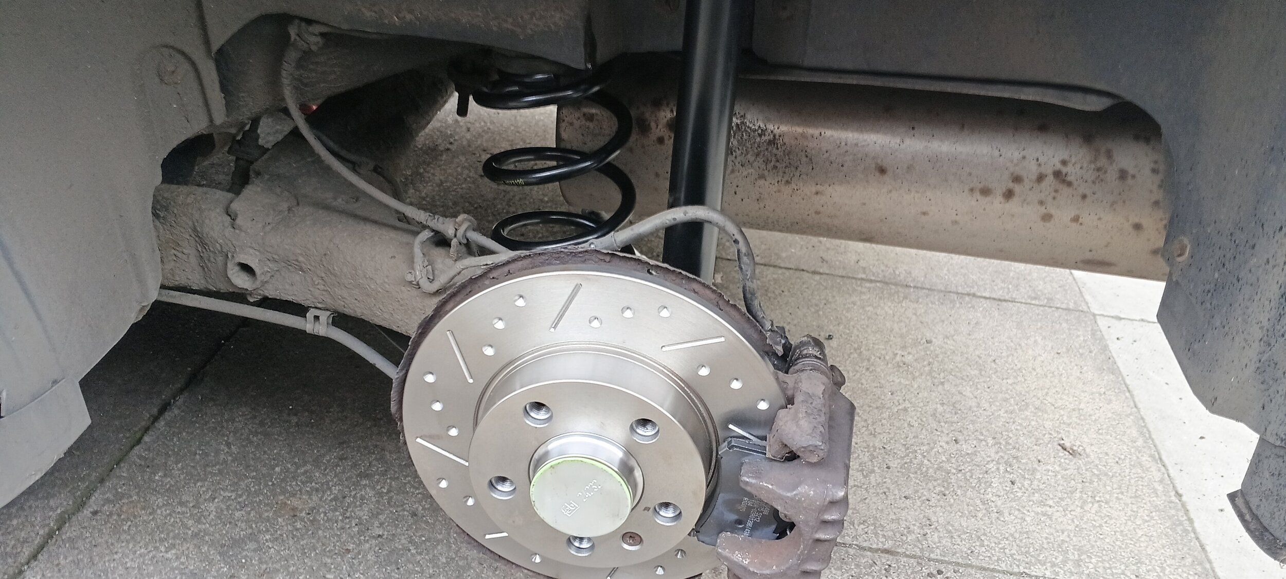

rear end done with
shocks and top mounts, springs, wheel bearings, discs and pads
think maybe next year i'll treat her to a new rear axle and brake hoses and pipes at the rear.

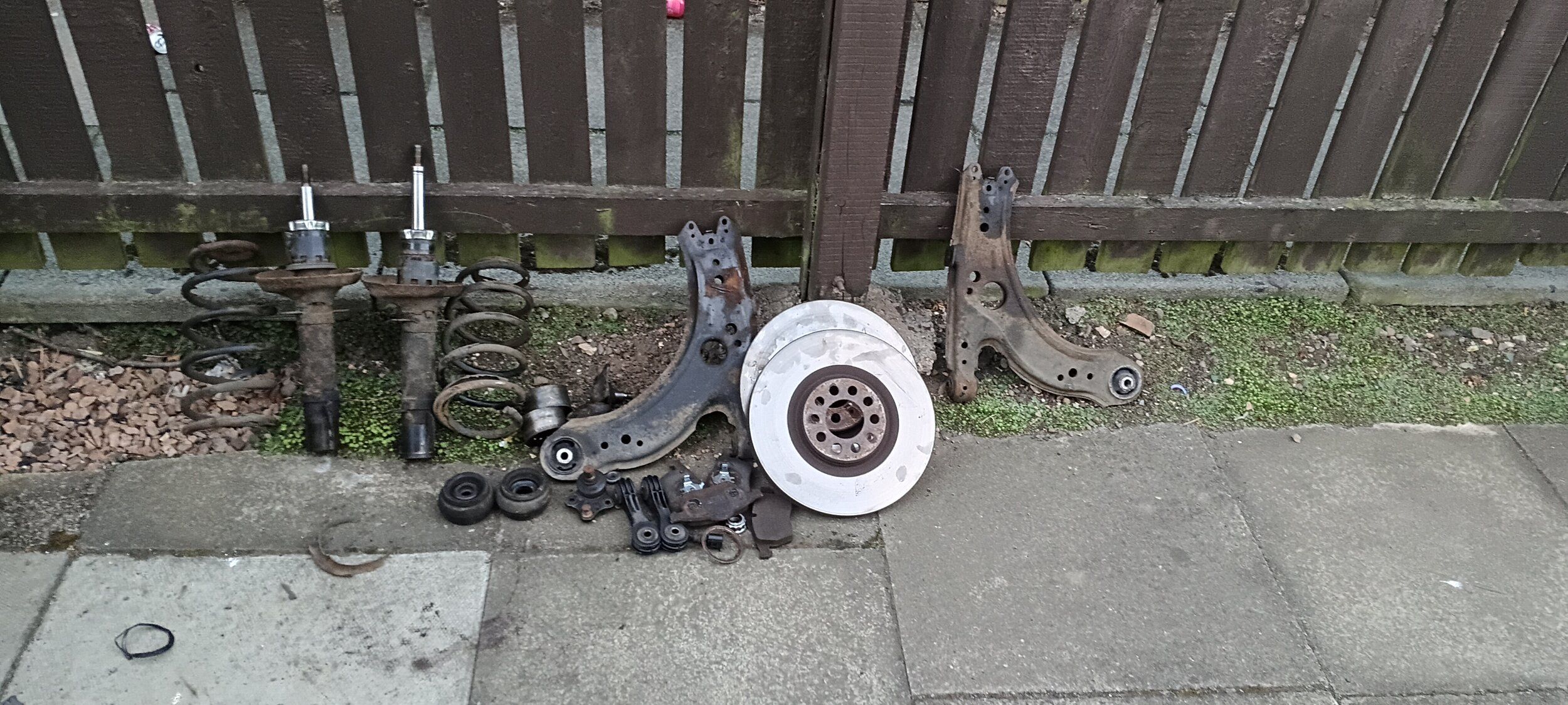

sunday im gonna do the front with
shocks and top mounts, springs, wheel bearings, lower arms, drop links and discs and pads, might grab a couple of track rod ends tomorrow in case they look sh*t then ill get it tracked during the week.
and again maybe next year get a new subframe on her with new brake pipes and hoses too.
today was a nightmare, strut pinch bolt snapped trying to get it out, abs sensor snapped, wheel bearing snap ring became part of the hub after 23 years, what a ballache getting that out,
tomorrow need to source a pinch bolt and nut, an abs sensor and put the track rod ends on and take for it for an alignment then done hopefully.
Yeah she can be a real demon when she wants to... may a copper grease fall on your hands to prevent future snaps ;)
