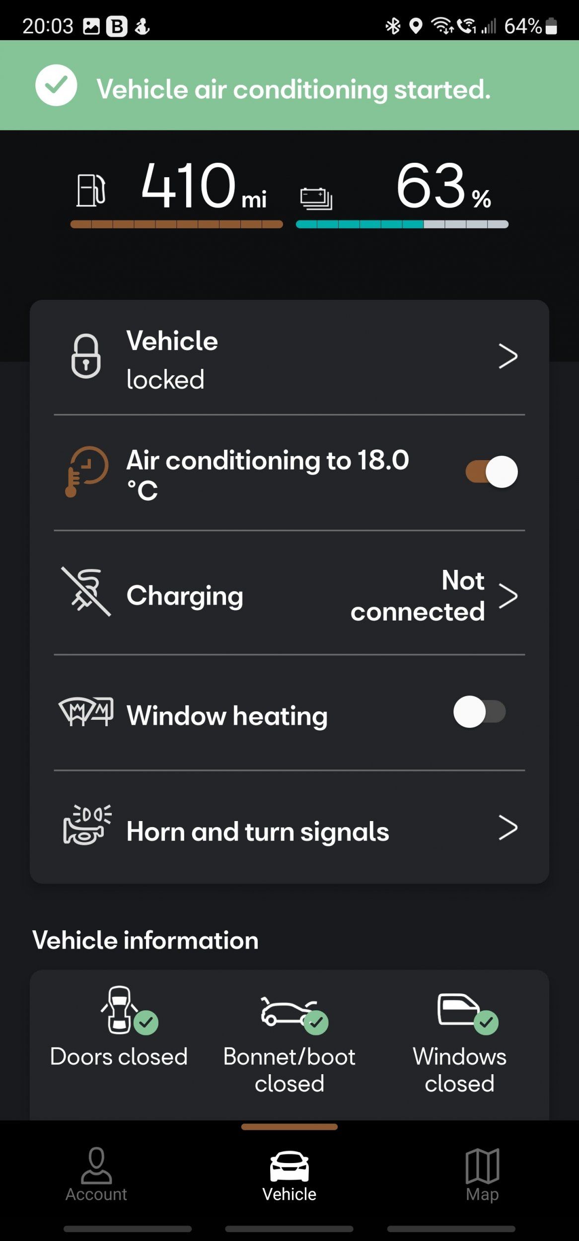

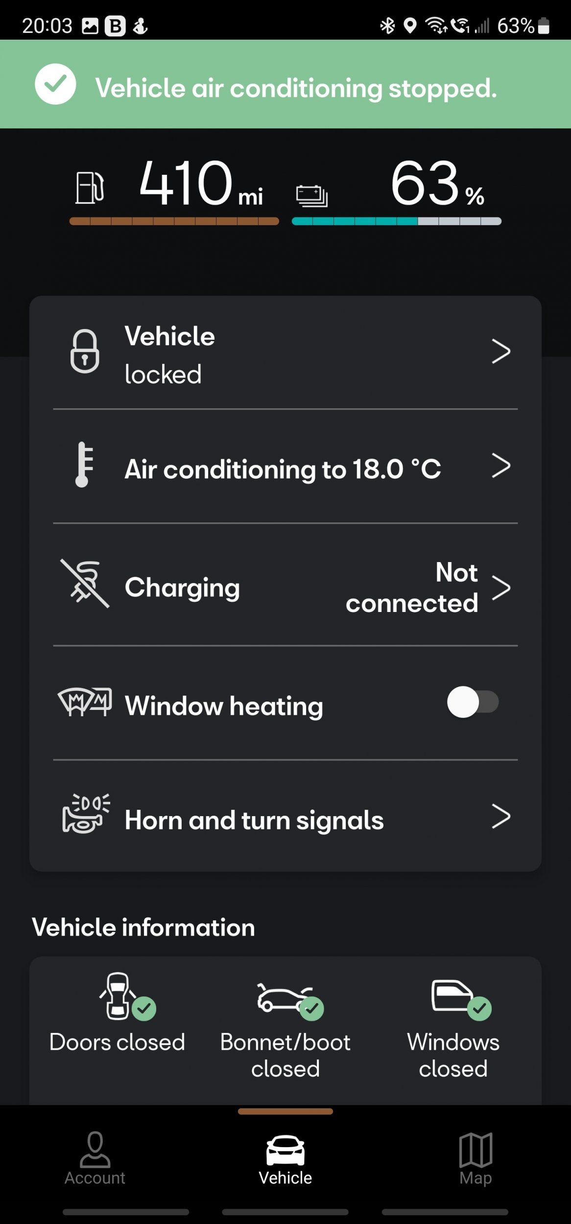

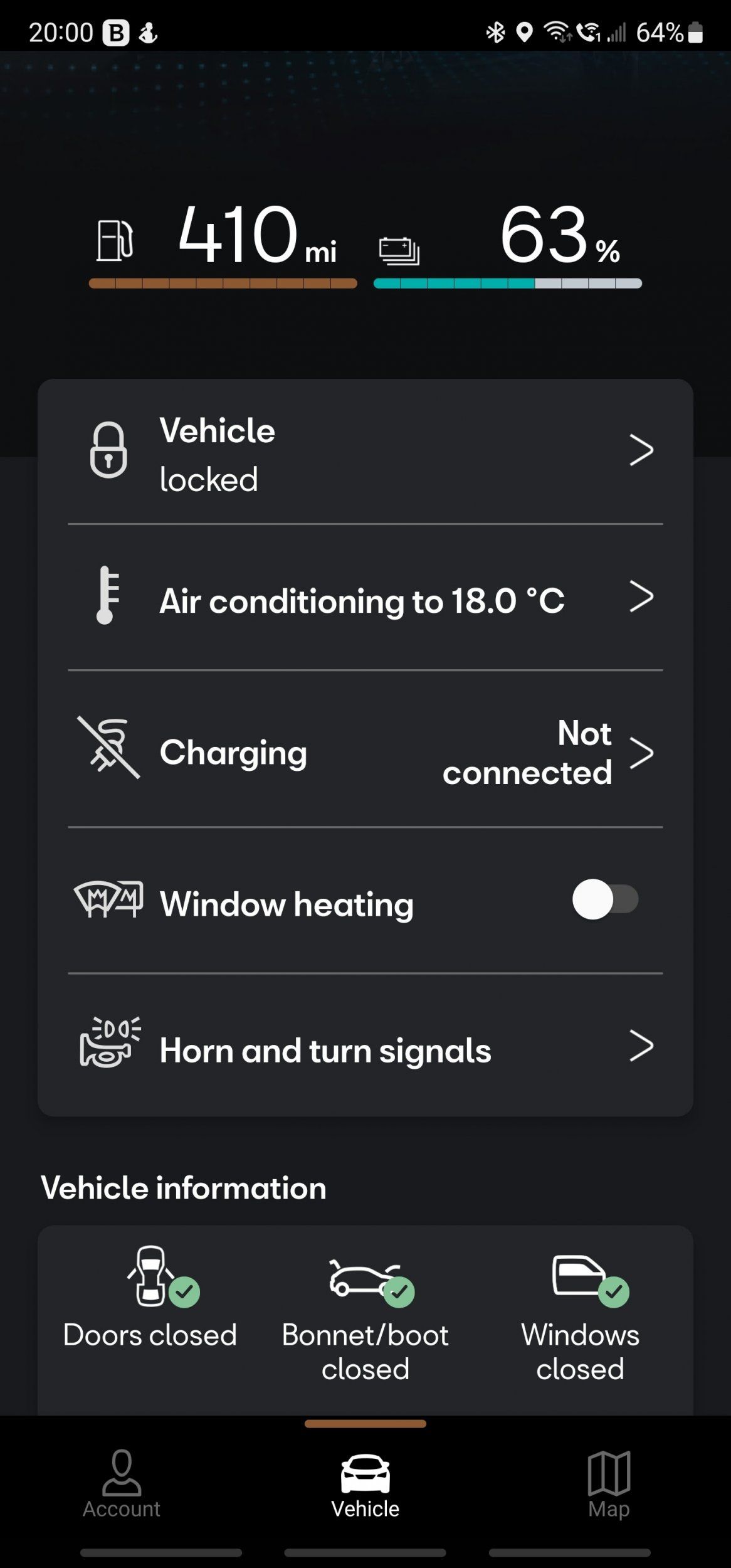

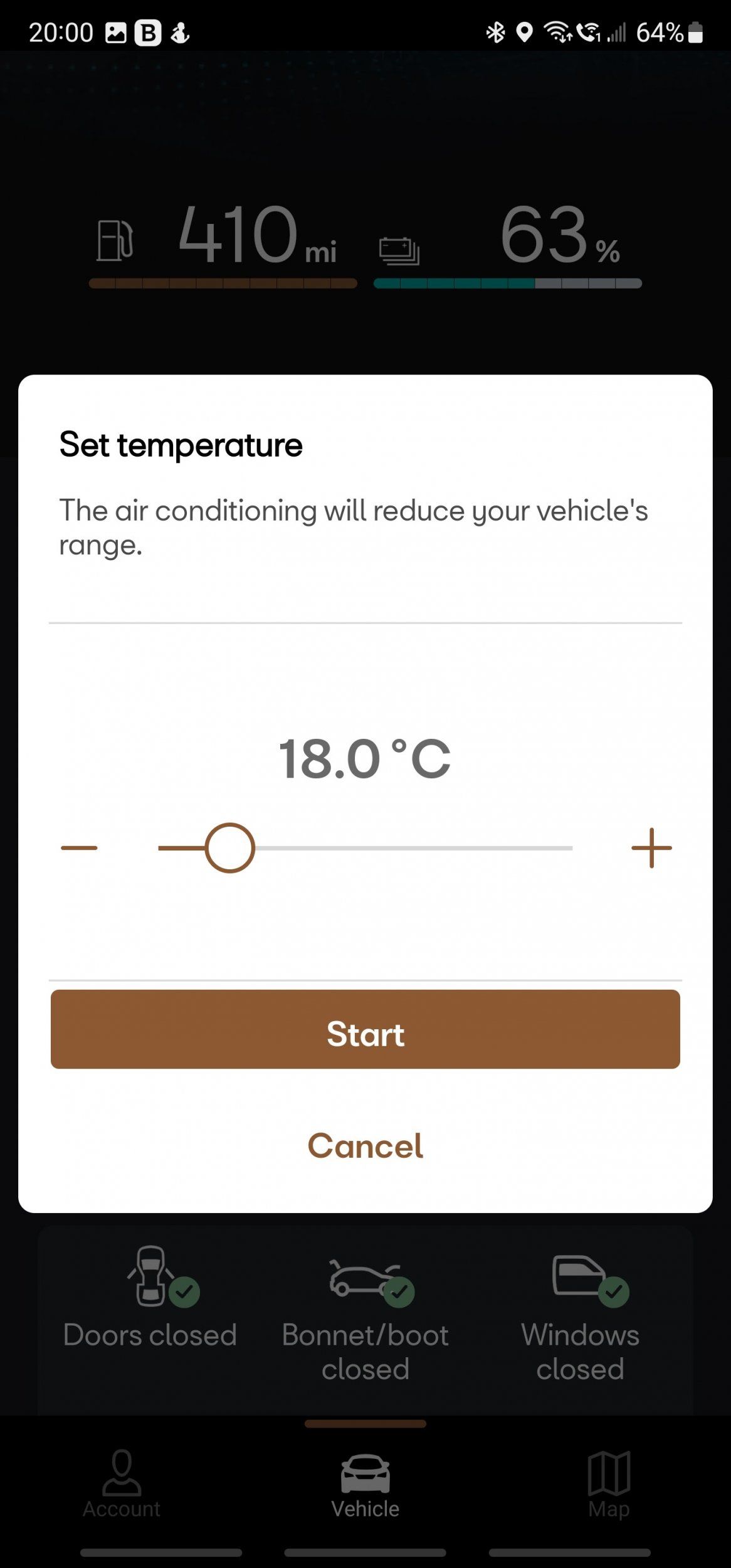

Maybe we are at crossed purposes here?
The app will (should) tell you if the aircon is on. Here are some screenshot of my app.
If you go out to the car in the garage you will definitely be able to hear if anything is running.
Screenshot_20230723_200052_CUPRA CONNECT.jpg Screenshot_20230723_200058_CUPRA CONNECT.jpg Screenshot_20230723_200309_CUPRA CONNECT.jpg Screenshot_20230723_200328_CUPRA CONNECT.jpg

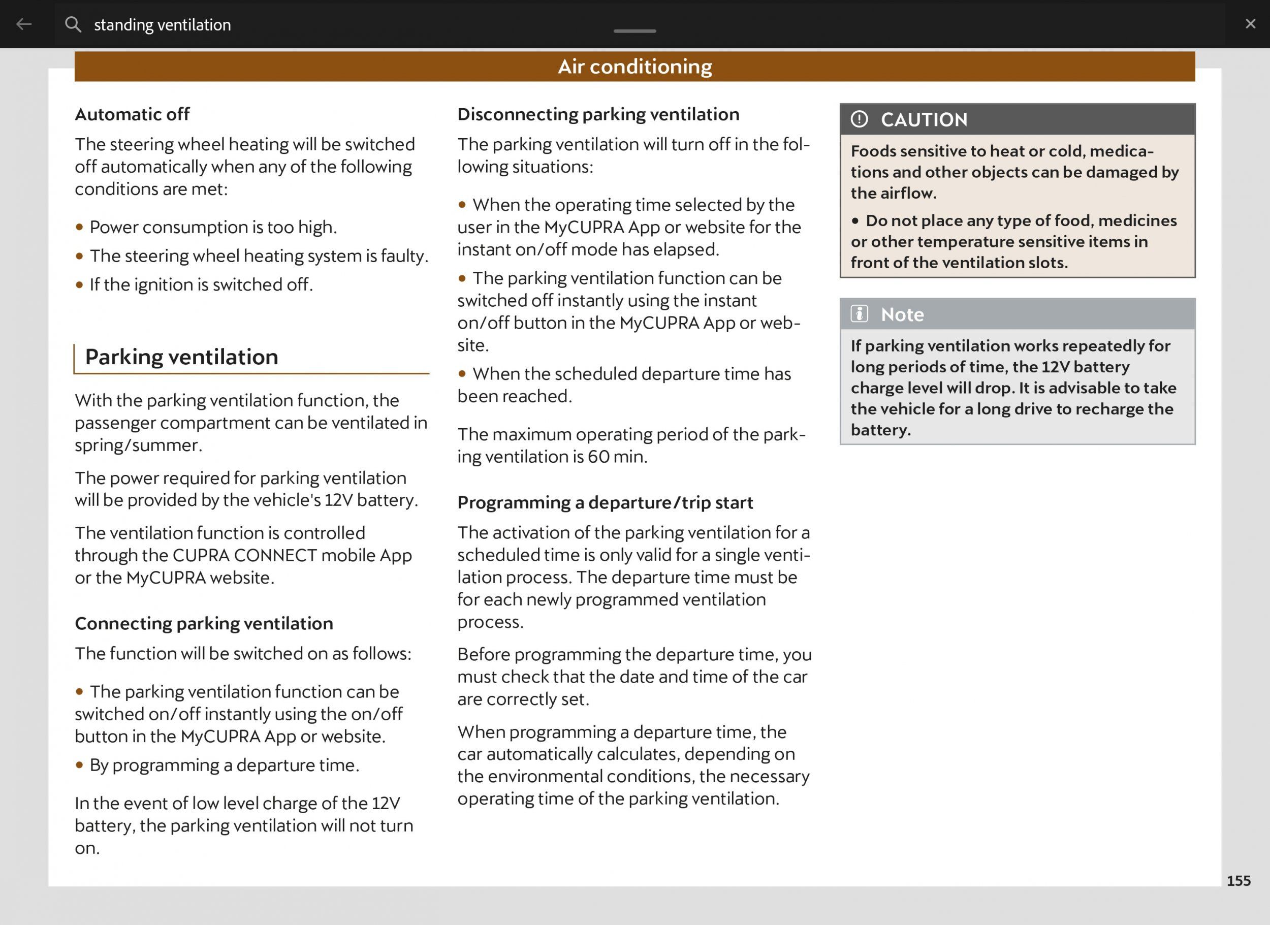

You are talking about air conditioning, but there is another additional function -standing ventilation. I think that's what turns it on. I found some information in the manual.

OK, but you originally said you had shut yourself in the car. Sensors can operate aircon etc as I suggested previously, you can if course override this.
Nothing in the car should self activate if it's locked with no one in it. All I can find is this:

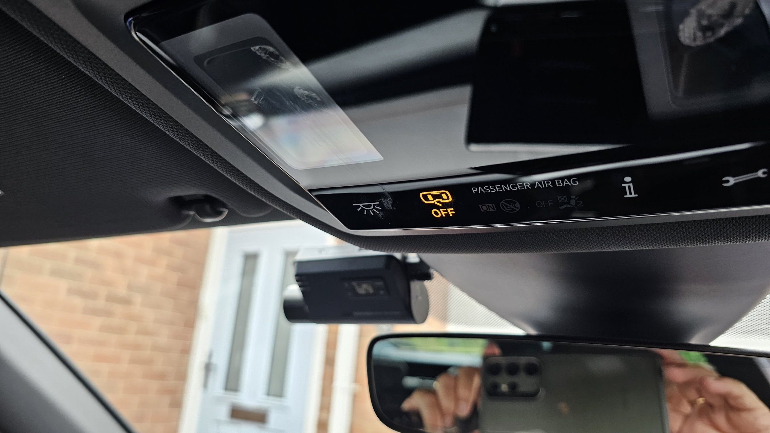

I still have an orange light on the ceiling of the car with a painted car and an OFF inscription. The manual says it's off, but mine is on. Is it really a glitch of the car due to the fact that the charging hatch is open.
oldgitdave
Mar 27, 2022
508
234
UK
I found a discussion of this topic on this forum. It is strange why these signs are needed if there is no one in the car.

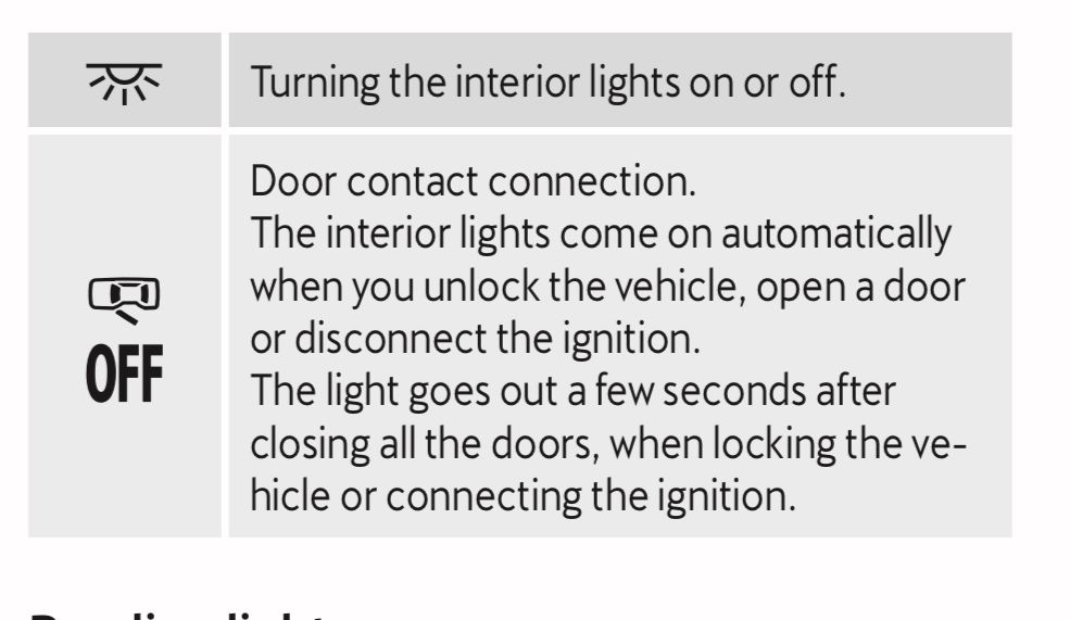

I still have an orange light on the ceiling of the car with a painted car and an OFF inscription. The manual says it's off, but mine is on. Is it really a glitch of the car due to the fact that the charging hatch is open. View attachment 37608
You mean this right?
That means the interior lights have been switched off manually. Press it and if the car door is open the interior lights will come on and the orange car light will go out. Press it again and the interior lights should go out and the orange car and OFF will light up orange.
