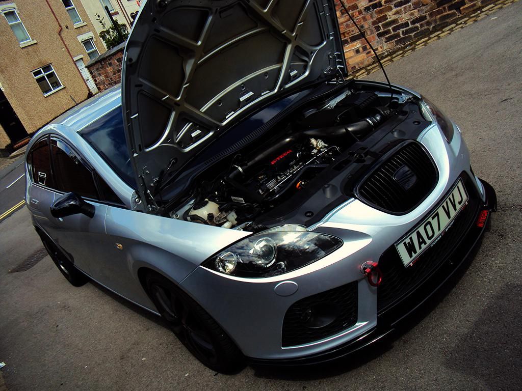

also added my R-T.E.C.H stickers today. should add at least +10bhp each sticker haha
along with my JDM tow hook.

whats it like noise wise etc without the bonnet sound proofing on and have you sealed the black plastic surround?
do you get any leaks onto the plugs etc with no engine cover on
i run mine without the cover also and my sound proofing is all white n mouldy looking,not nice when you try n keep it in mint condition
cheers
thanks mate.
noise wise:
Start up..... sounds like a diesel haha its a little louder but not much.
Driving.... all i hear is the Revo intake sucking in gallons of air.
yes when i removed the engine cover i noticed alot of water on the coil pack, so put bag over the coils closed the bonnet and poured water along the strip i noticed it was coming out of the 3 middle holes so all i did was put a little clear silicone over the holes which sorted the problem.

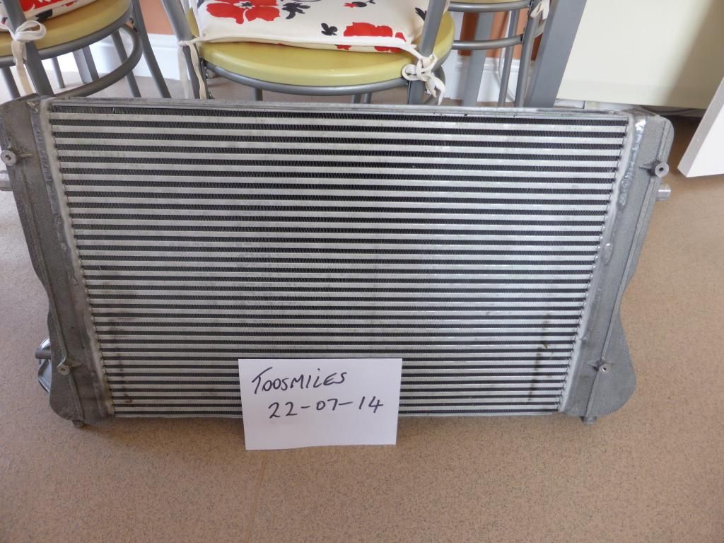

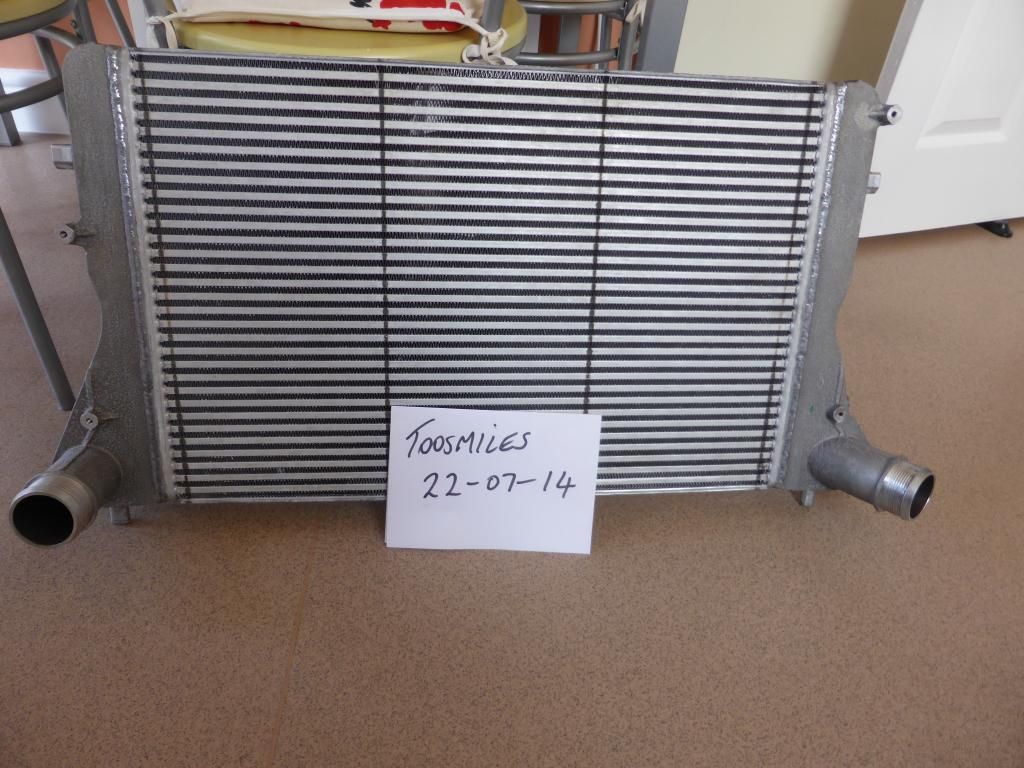

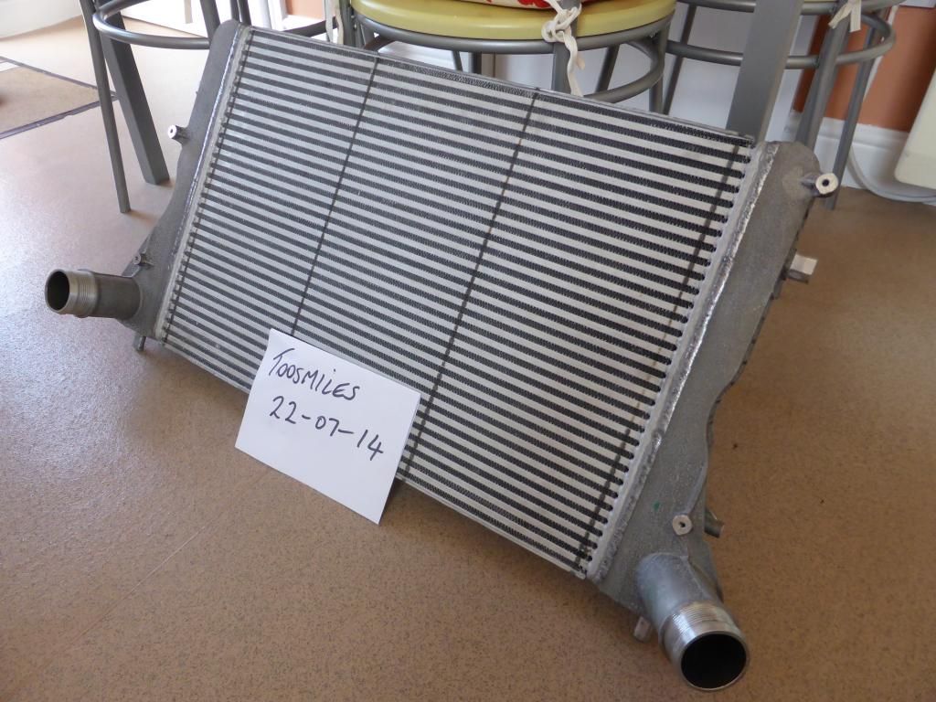

so after looking on the classifieds on various forums this little beauty popped up, a good as brand new S3 intercooler from toosmiles.
I thought sod it im having that and went go pick it up had a cracking conversation with toosmiles (your car is a work of art mate) so killed 2 birds with 1 stone and all that and took the family to sunny rhyl while i was there.
I fitted it today, was quite straight forward tbh as i removed my aircon previously. i just had to buy x4 m6x16mm bolts and x2 50-70mm jubilee clips and i was good to go, took me about 3 hrs taking my time from start to finish and got sunburnt in the process.......note to self don't work on car topless

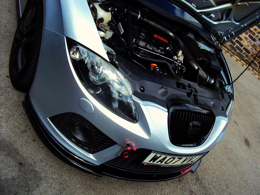

Looks mean as fook with the Front mount on show a touch
Did you use all the oem boost pipes with the S3 cooler?

yea you use the oem pipes just peel the metal sleeve off one end and cut about 2cm off and you need different bolts m6x16mm.
