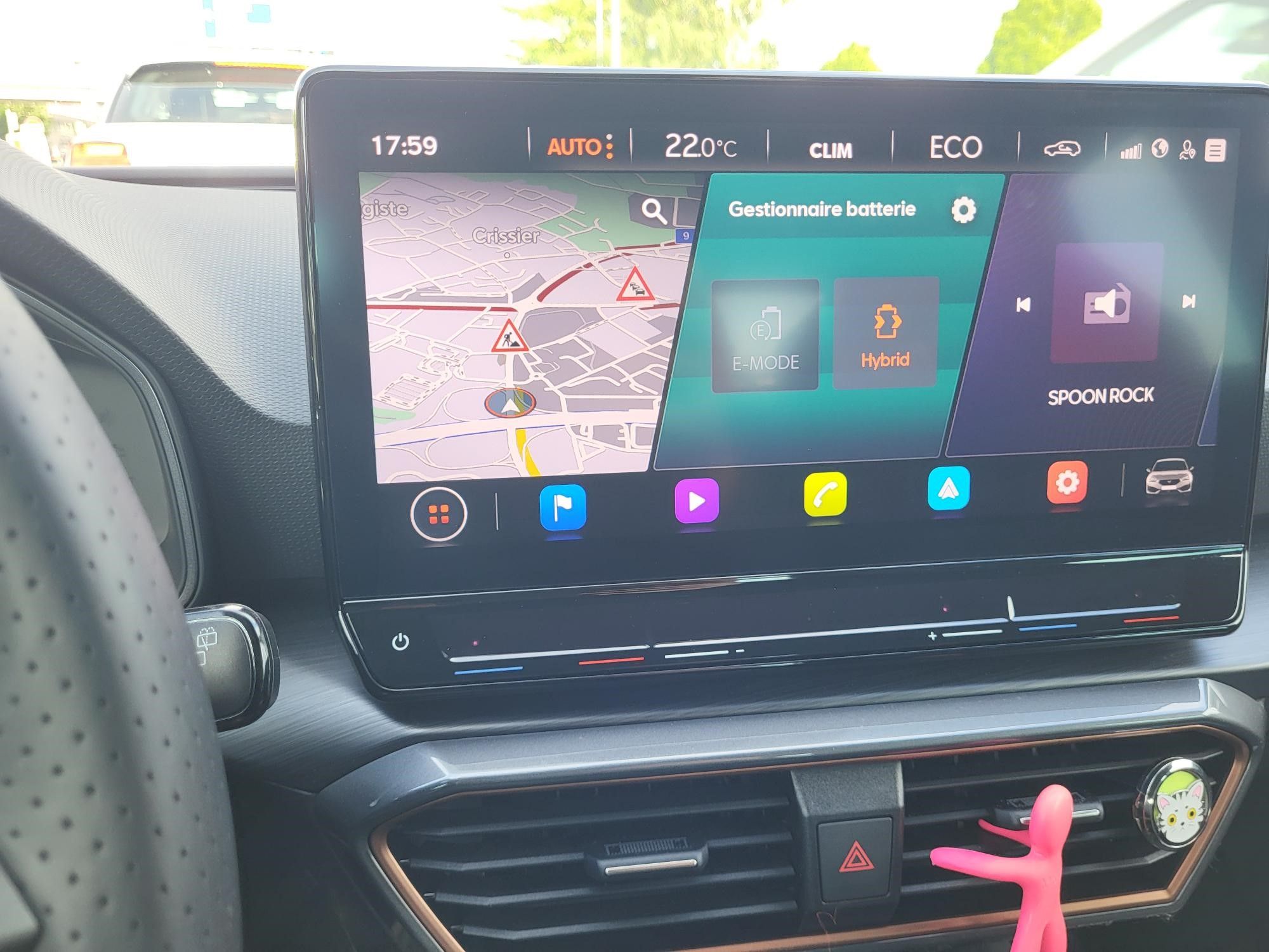

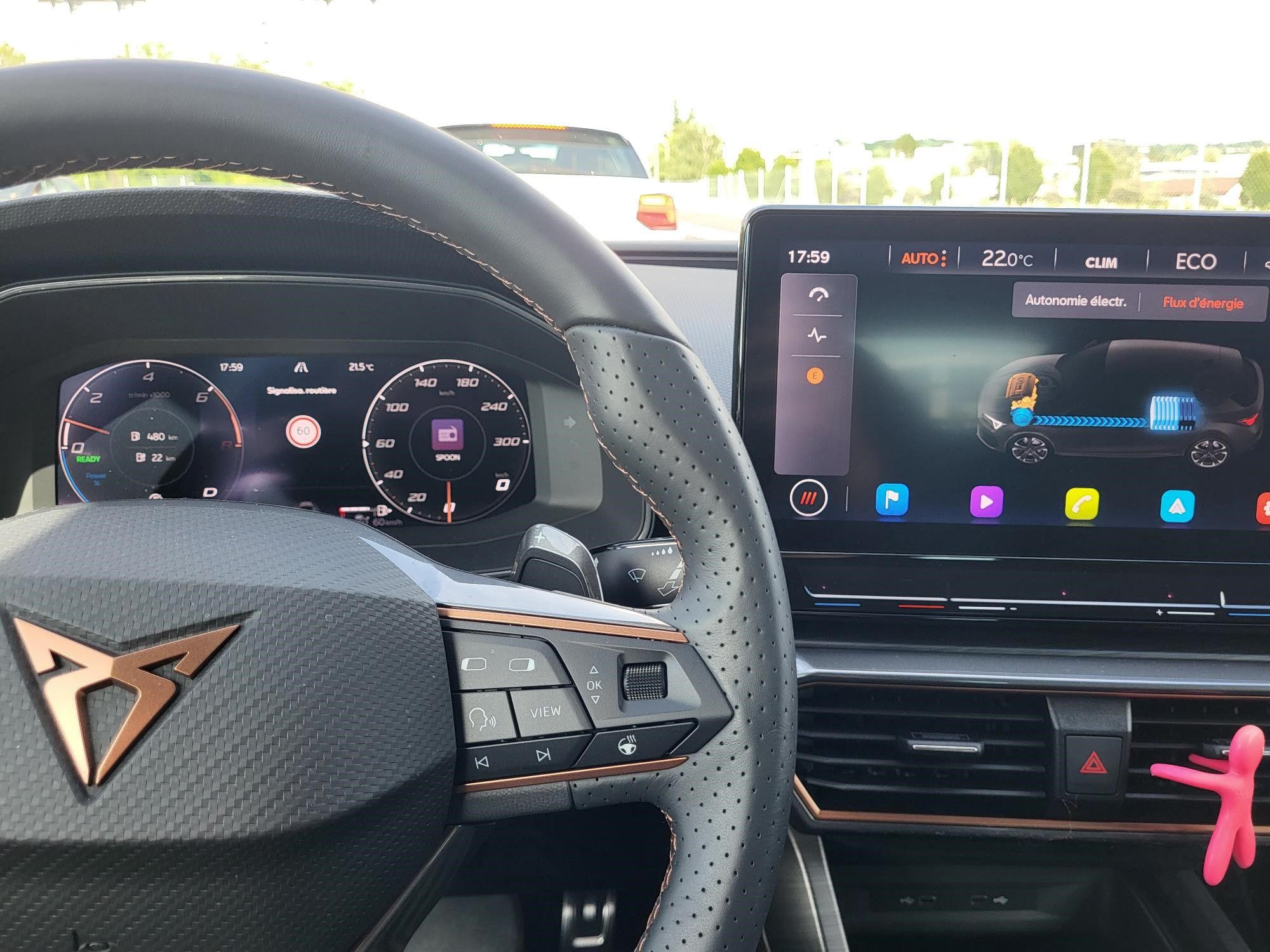

Hi, I'm a happy owner of a Cupra Leon 1.4 e-HYBRID, I noticed that while driving sometime the fuel engine starts and the electric motor becomes unavailable for the next 3-5 minutes. An this even if there is still more then enough capacity in the battery. I asked my dealer you checked the error code during the first yearly service who didn't find anything. So my question is, am I the only one and should I continue to complain to my dealer, or is this some kind of mechanism that is intended so the the engine does not start for "nothing" and thus disable temporary the electric motor.
Thanks in advance for any hint.

No, nothing on the dash

Once the engine starts it must get up to a safe temperature before it can turn off again - annoying but it's protecting the engine from wear and tear.

Thanks, yes, I was thinking of something like this, so as long as it's not a defect, it's fine for me
Behaviour where the engine starts then disables the electric drive motor for an extended period of time can also be attributed to GPF regens (where applicable).
