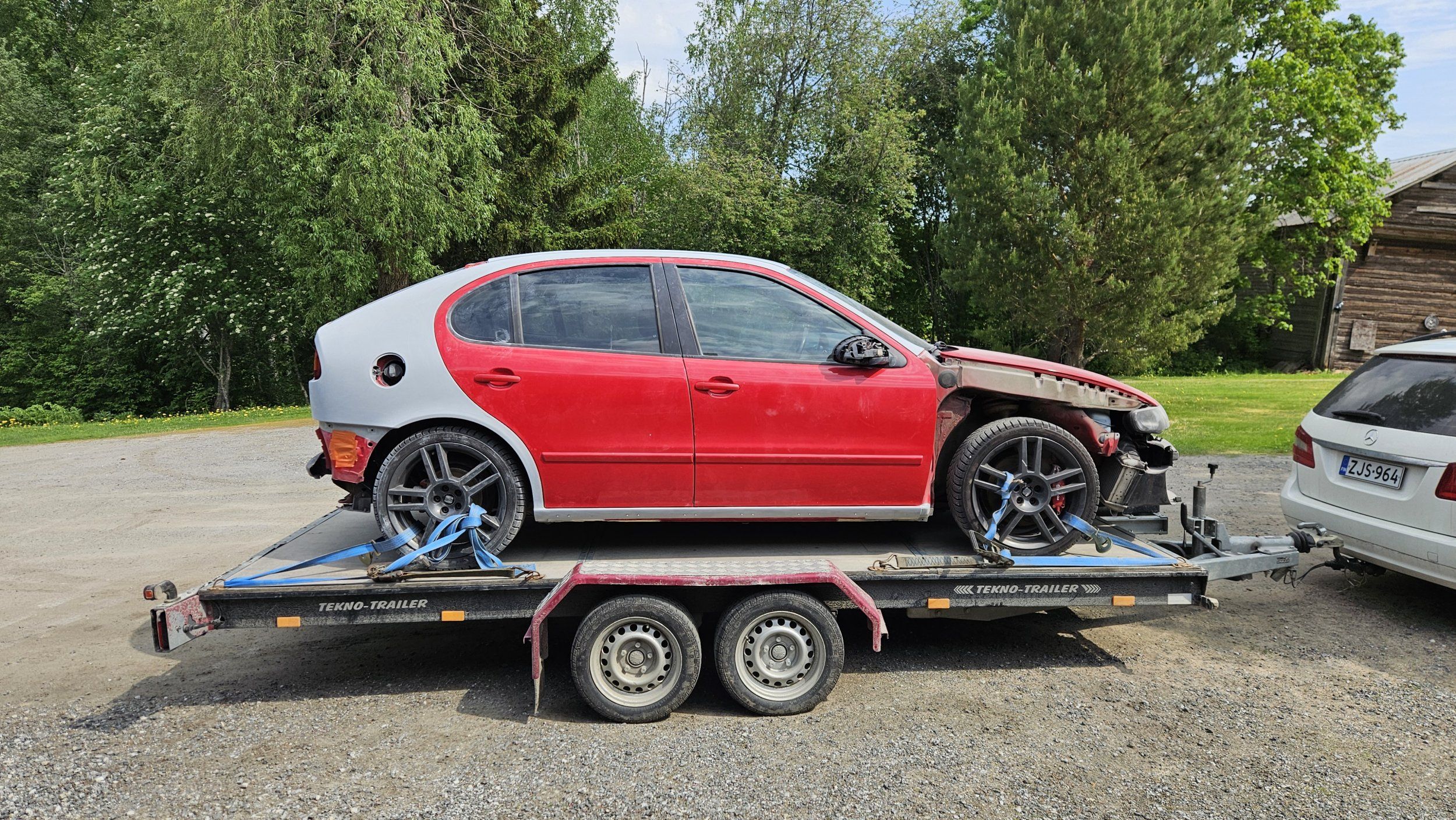

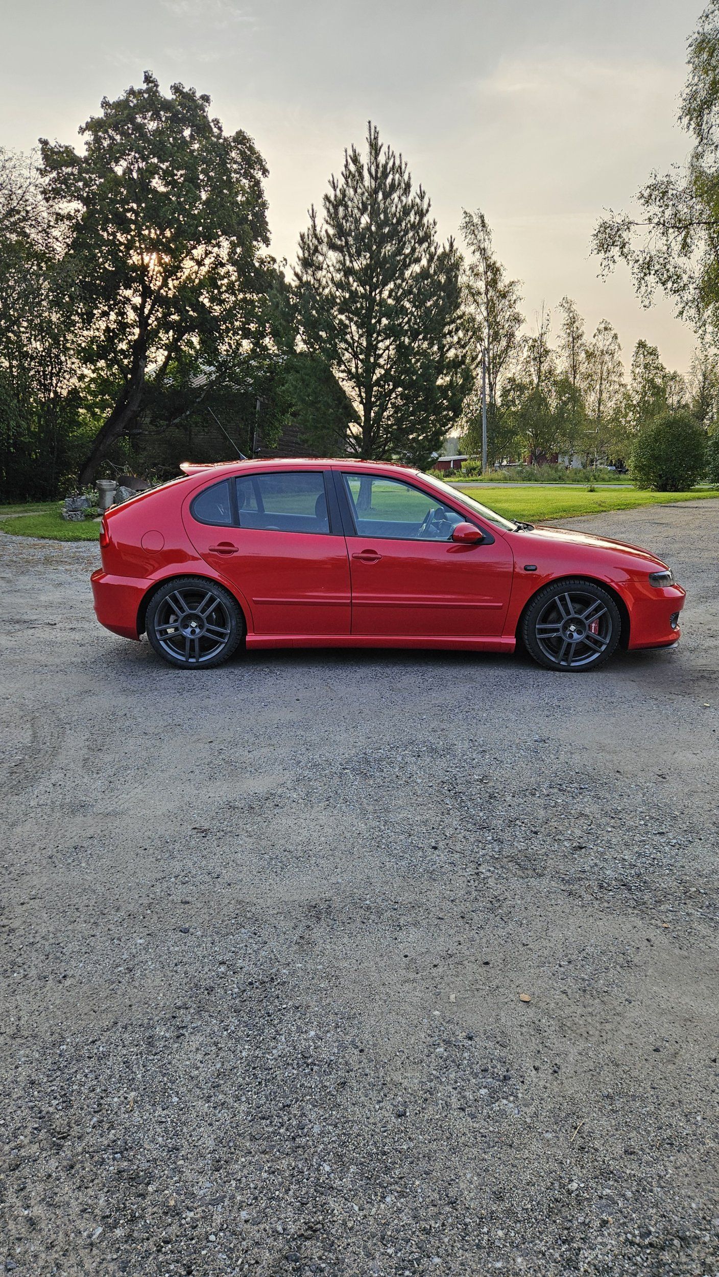

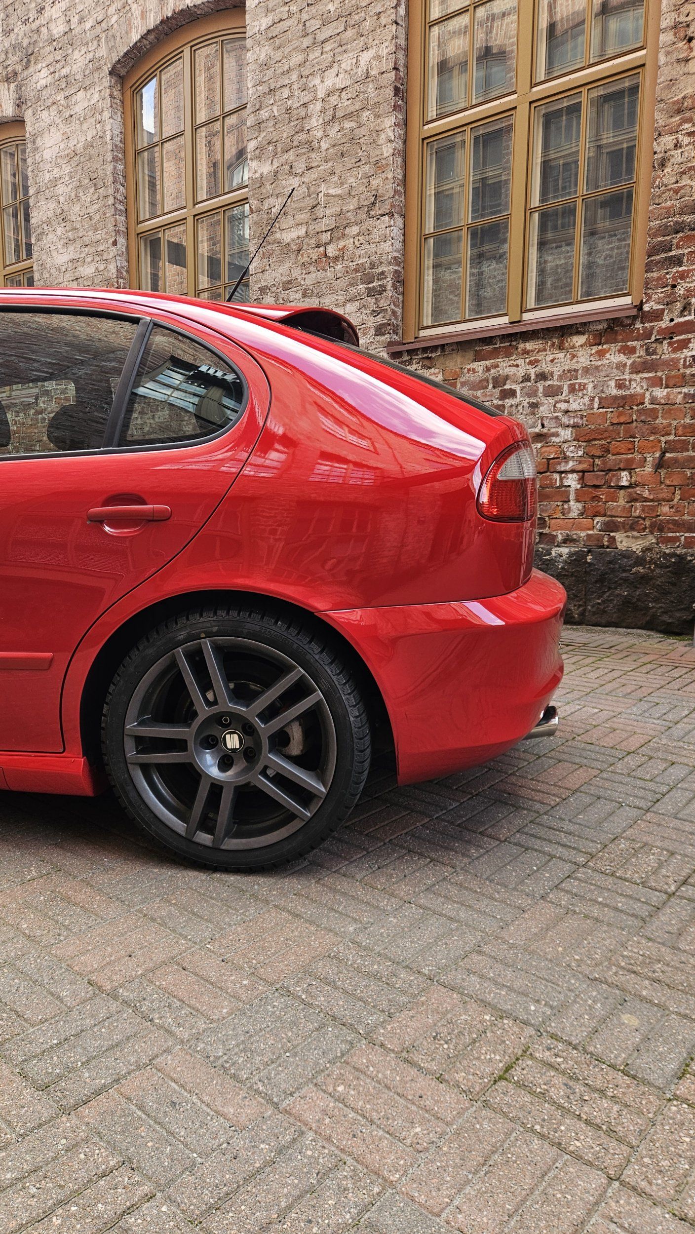

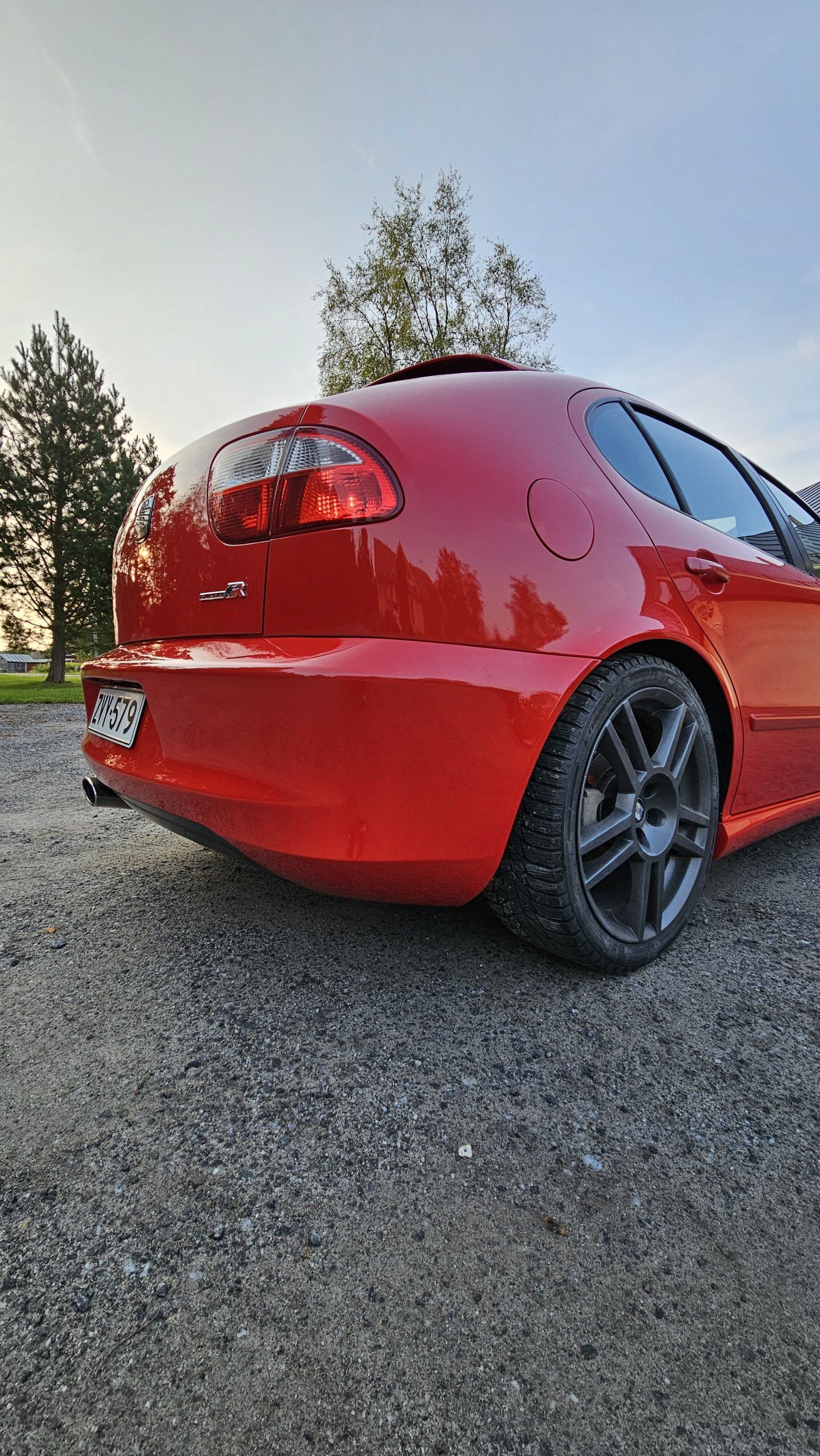

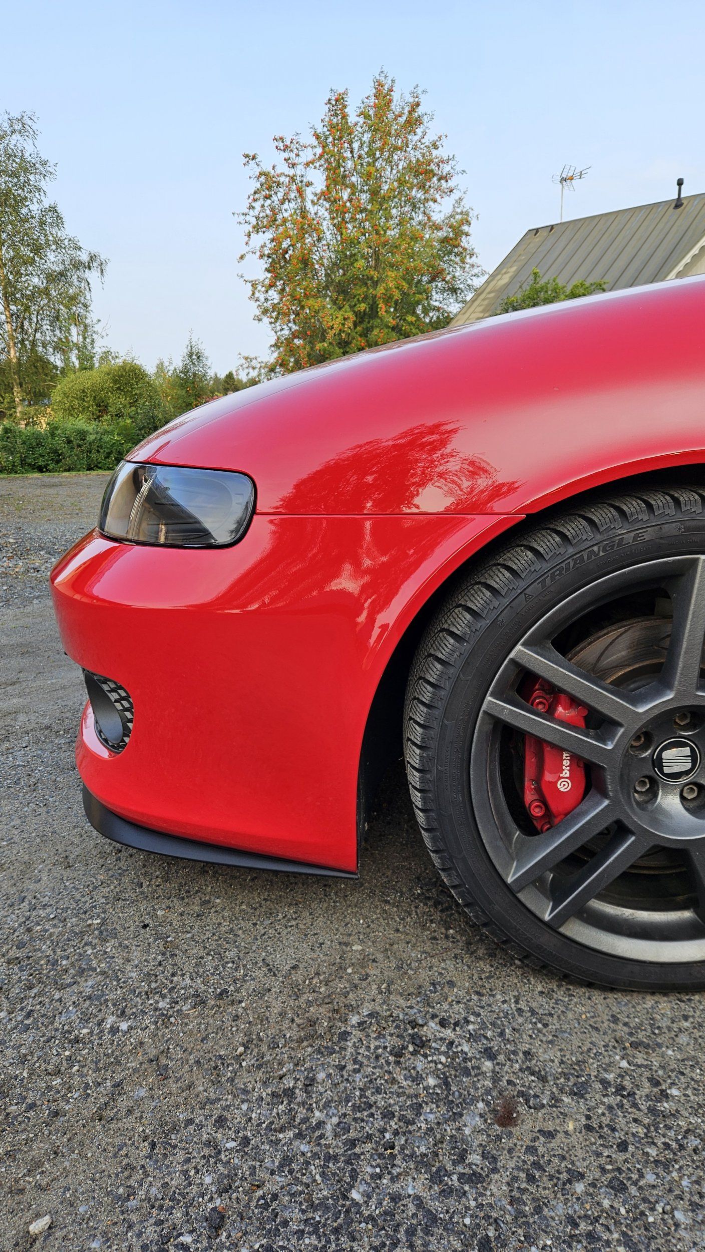

Drove 1.9 TDI Leon for some years, loved it, then upgraded to Cupra R a year ago. BAM too fast, lost the license for some weeks and decided to use that time to stop the rust and repaint. Publishing shortvids of the progress in case you are interested. They are in Finnish but less talk and more content anyway.
Top coat will be done in a paint shop as I do not have a proper filtration ventilated space. Doors and hood will stay with current paint, other parts will be painted.
Part1: Starting situation, disassembly and sandblast
Part2: Rust repairs
Part3: Body epoxy & filler sprays
Part 4: Plastics and front arcs. Ready for paint shop!
Part 5: Paint job results with a few imperfections to work on
Part 6: Reassembly
Final result
Questions, comments, suggestions are welcome!

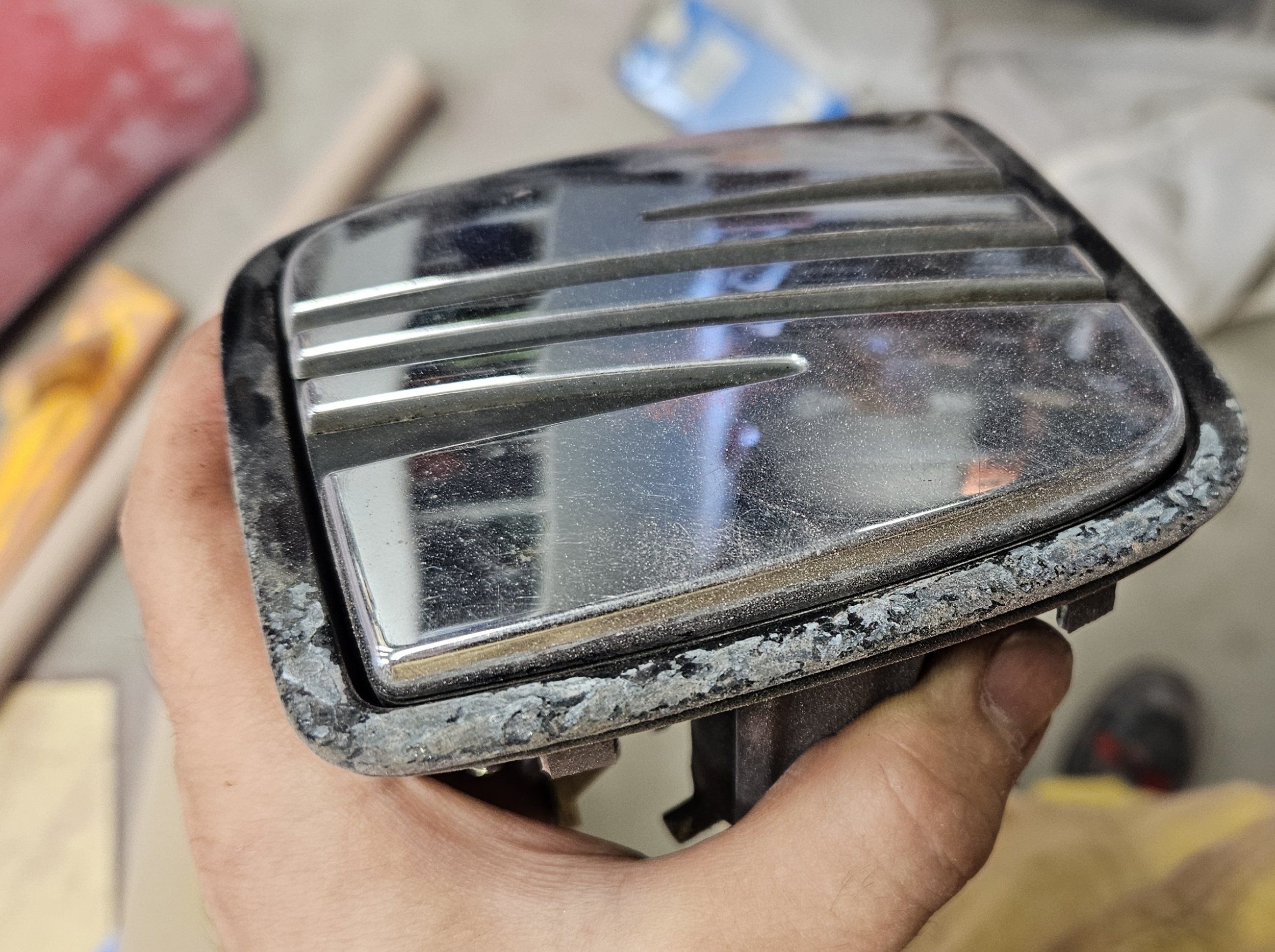

Has anyone repainted the trunk handle? I quickly resprayed some of it last winter with some cheapo spray while fixing the mechanism and seems all of it has oxidized off.. Will a standard 2K epoxy prevent this if I now do it properly? Or is this some weird alloy that needs special treatment?

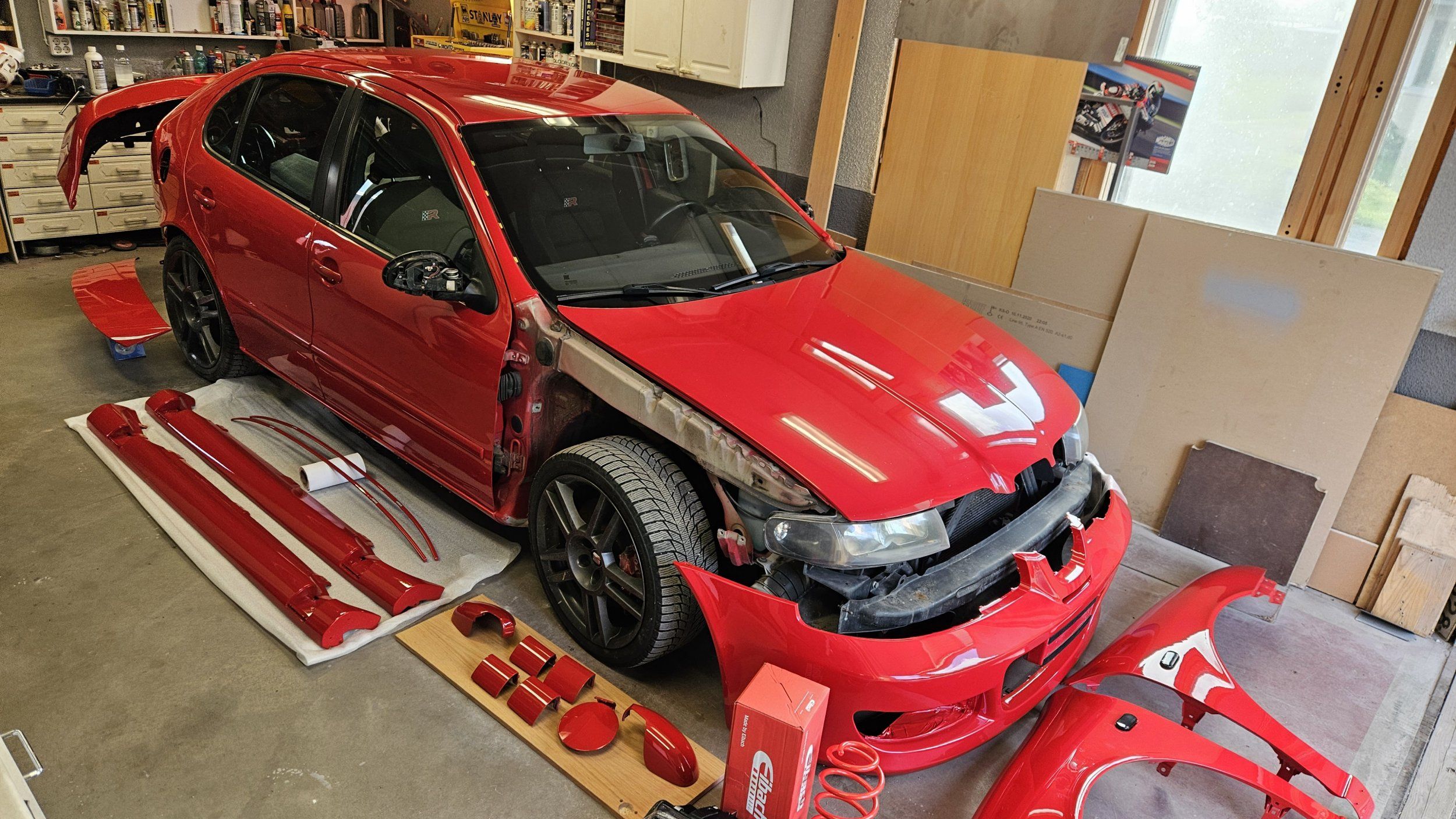

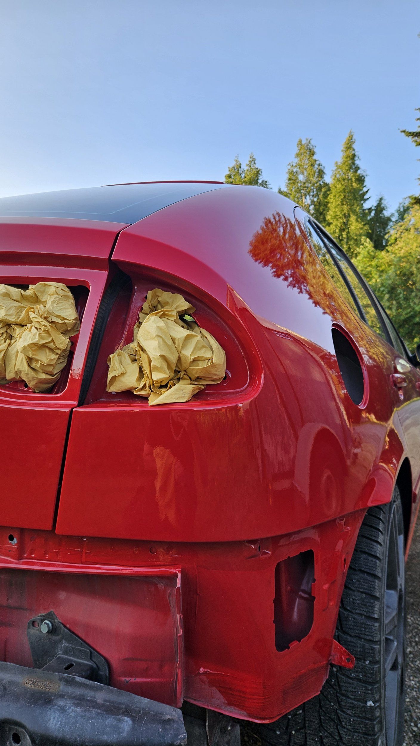

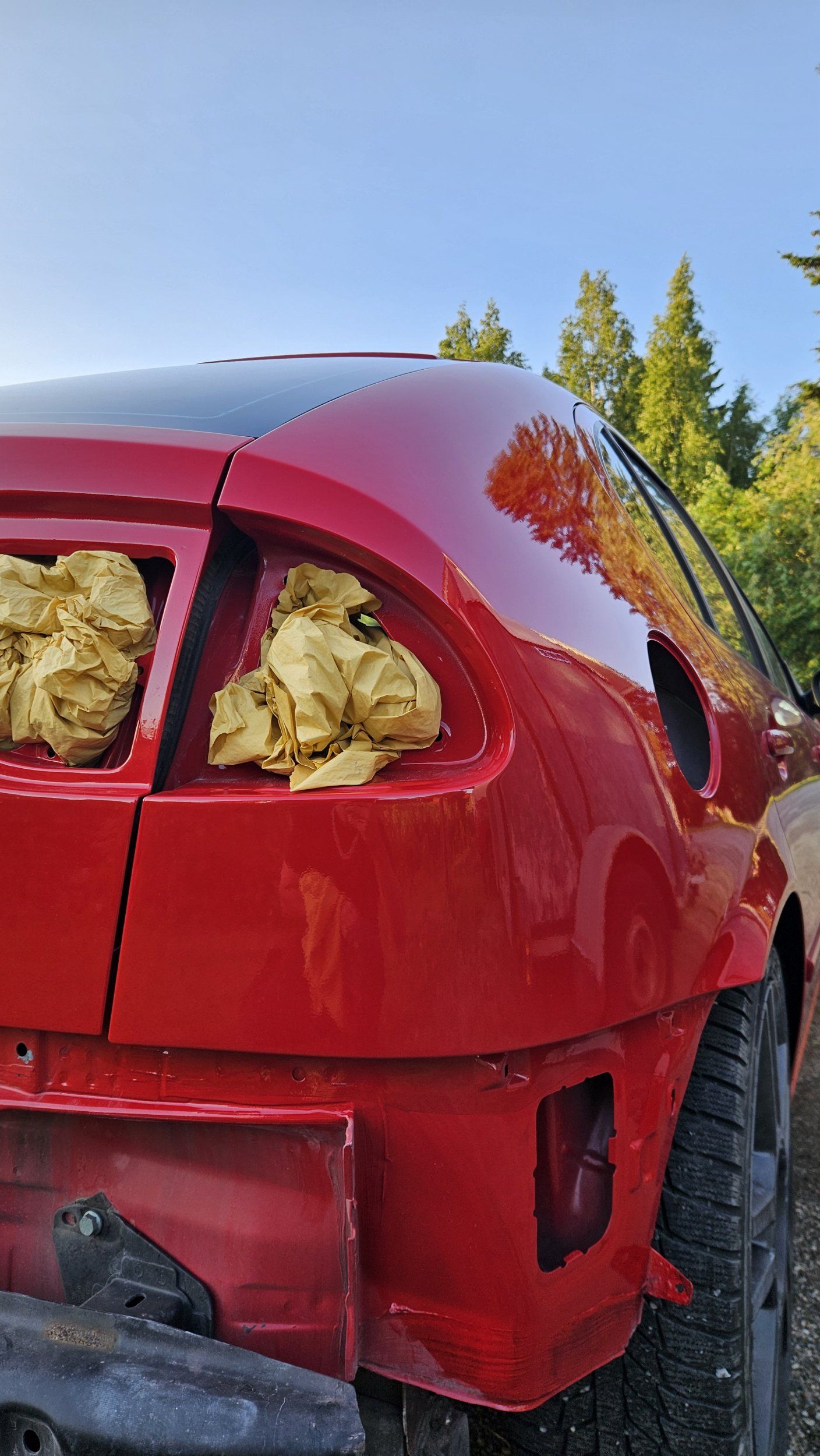

Body is back from the painter ? some minor imperfections to correct (didnt pay for any post work) but overall very happy ?
Bumpers etc are now in, getting them back prob next week.

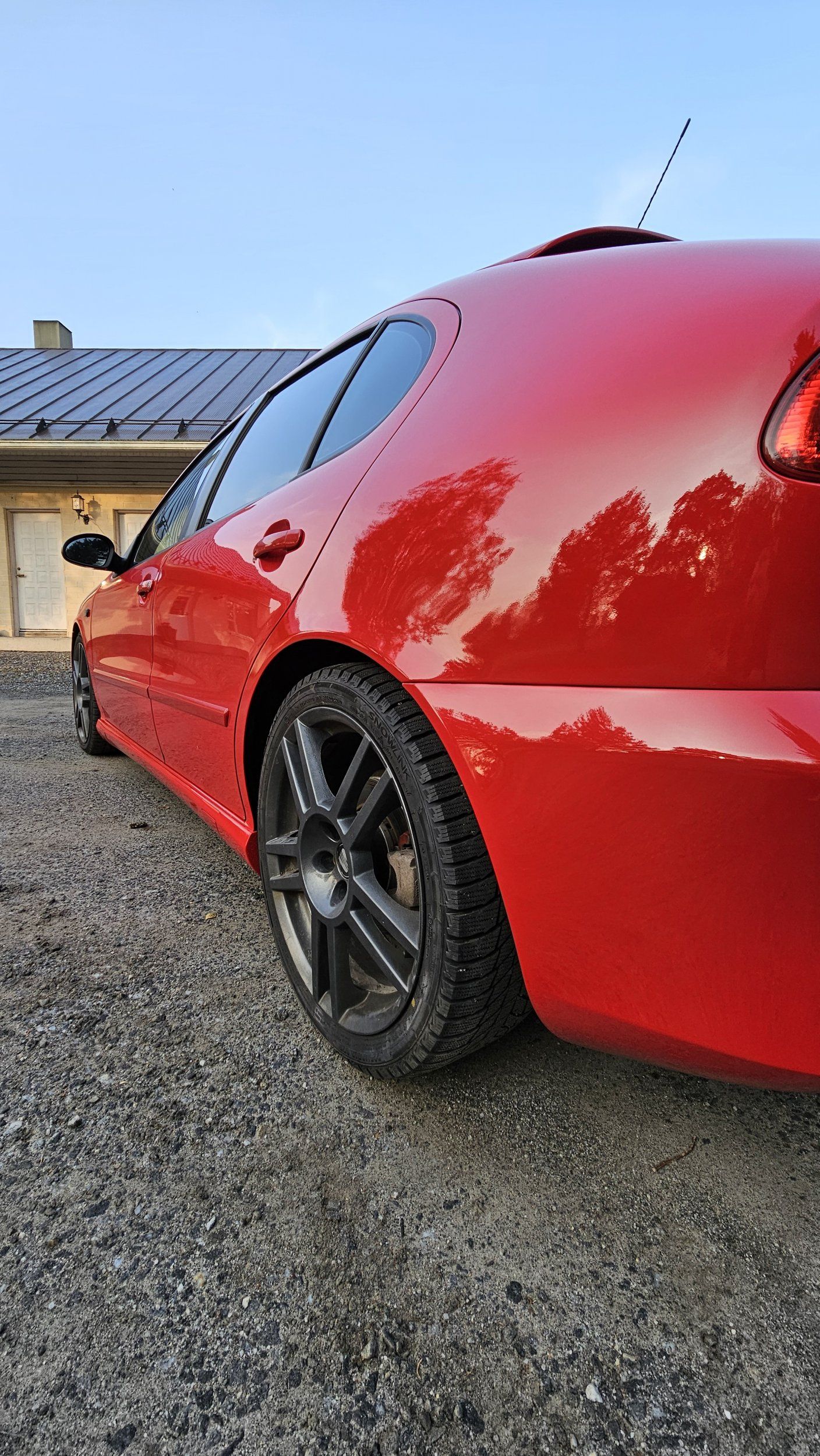

Next video out:
Part 6: Reassembly

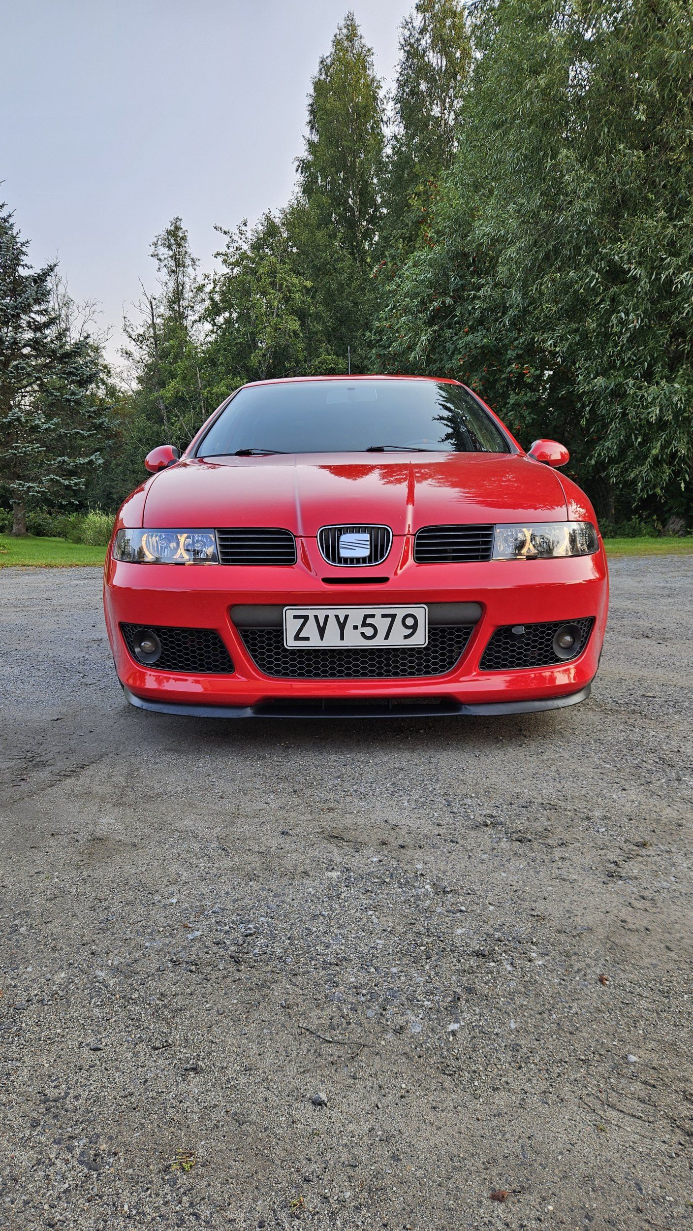

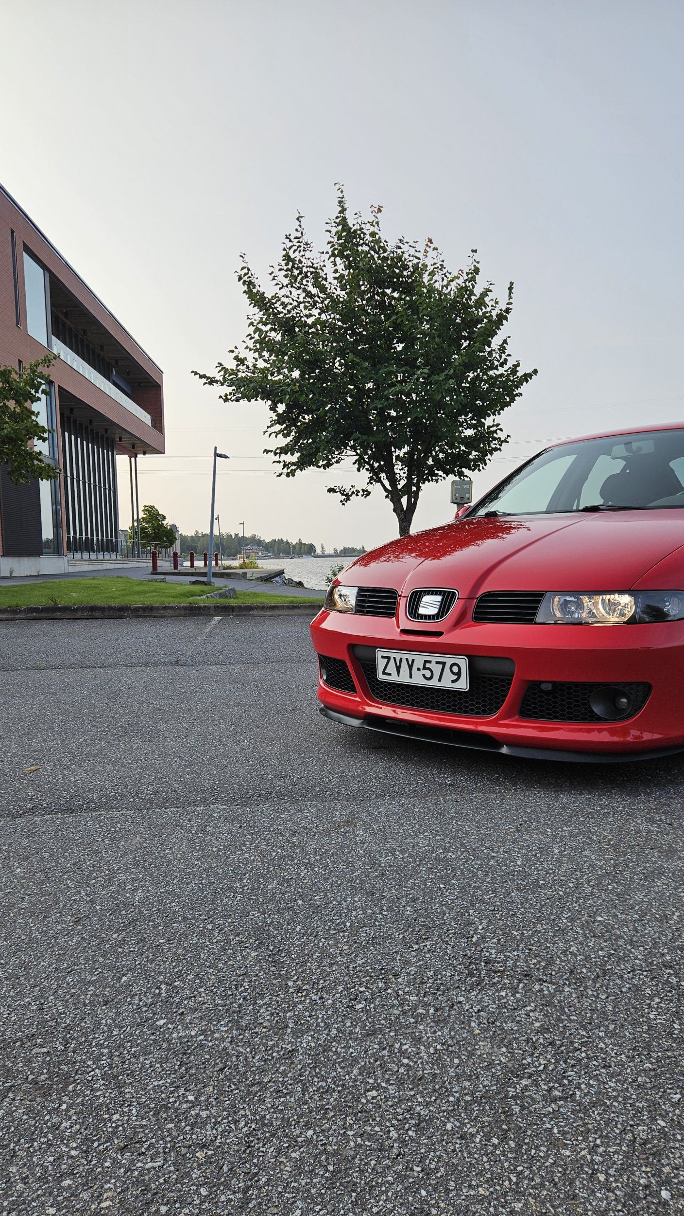

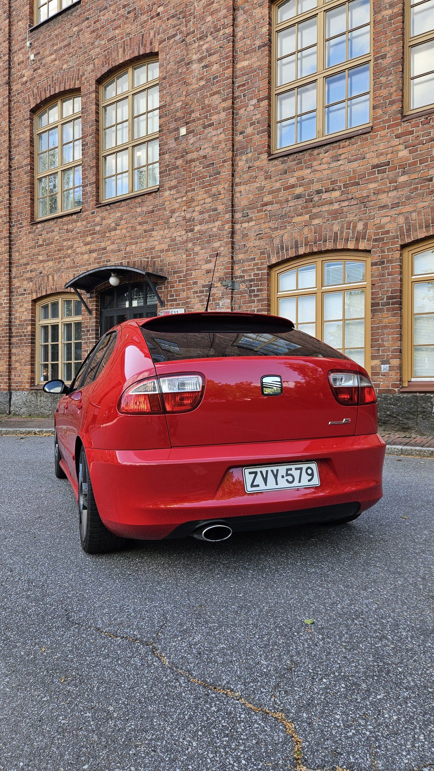

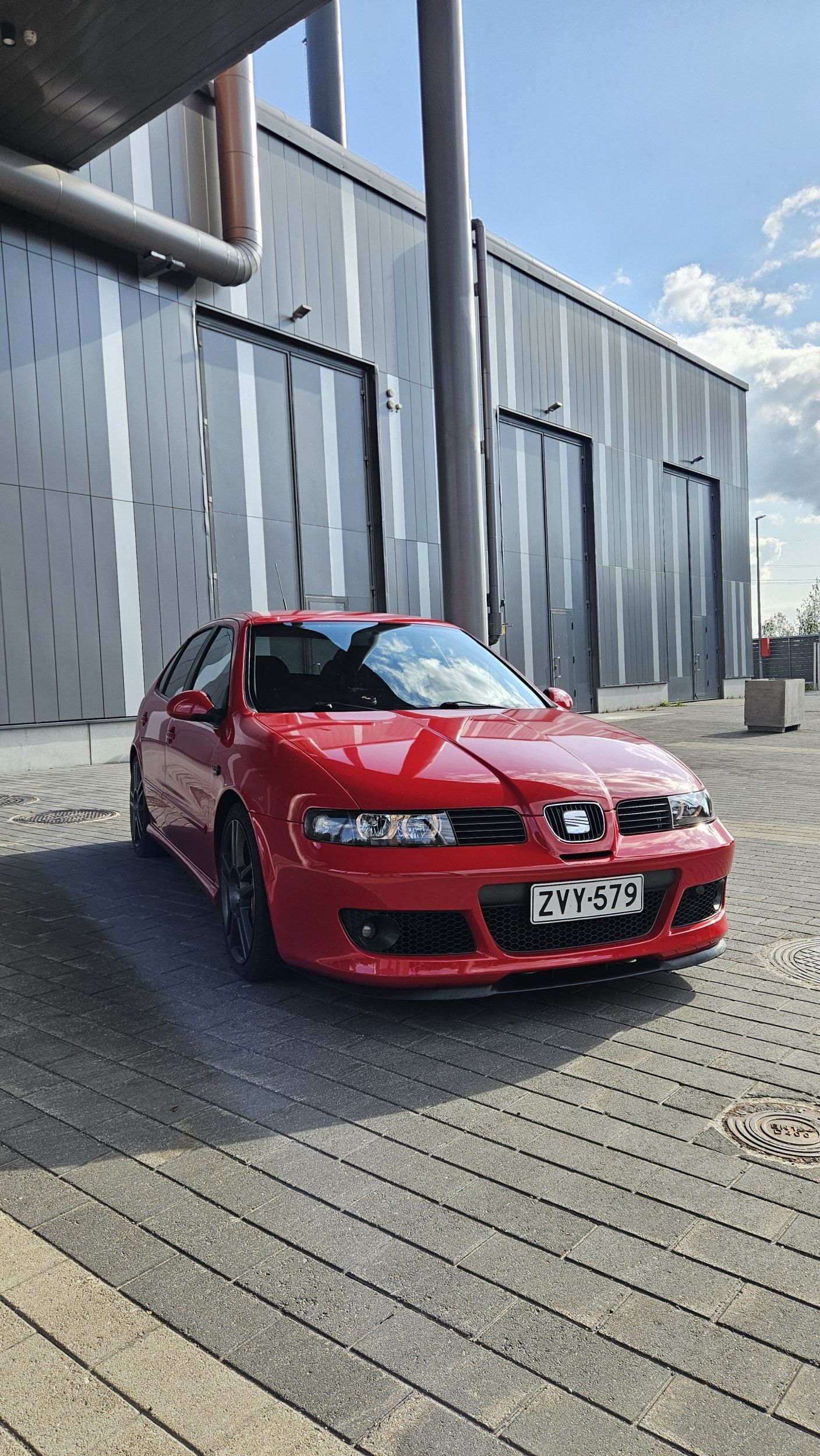

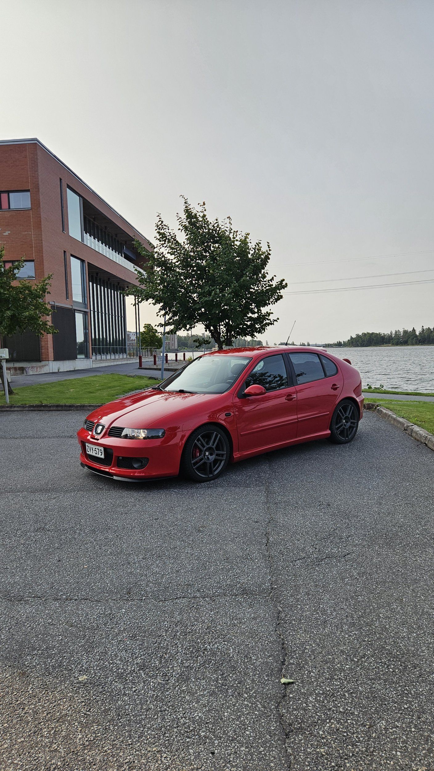

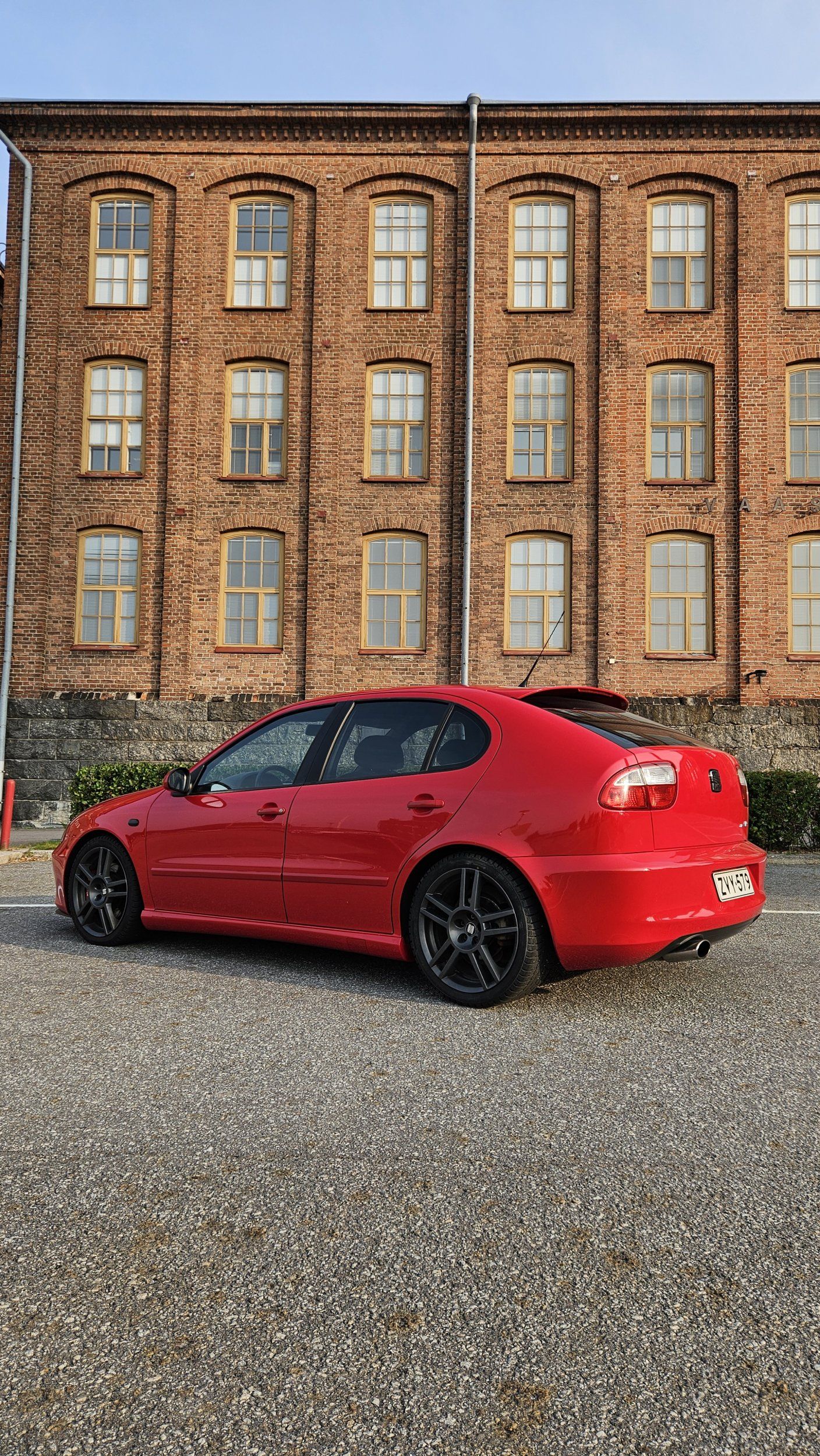

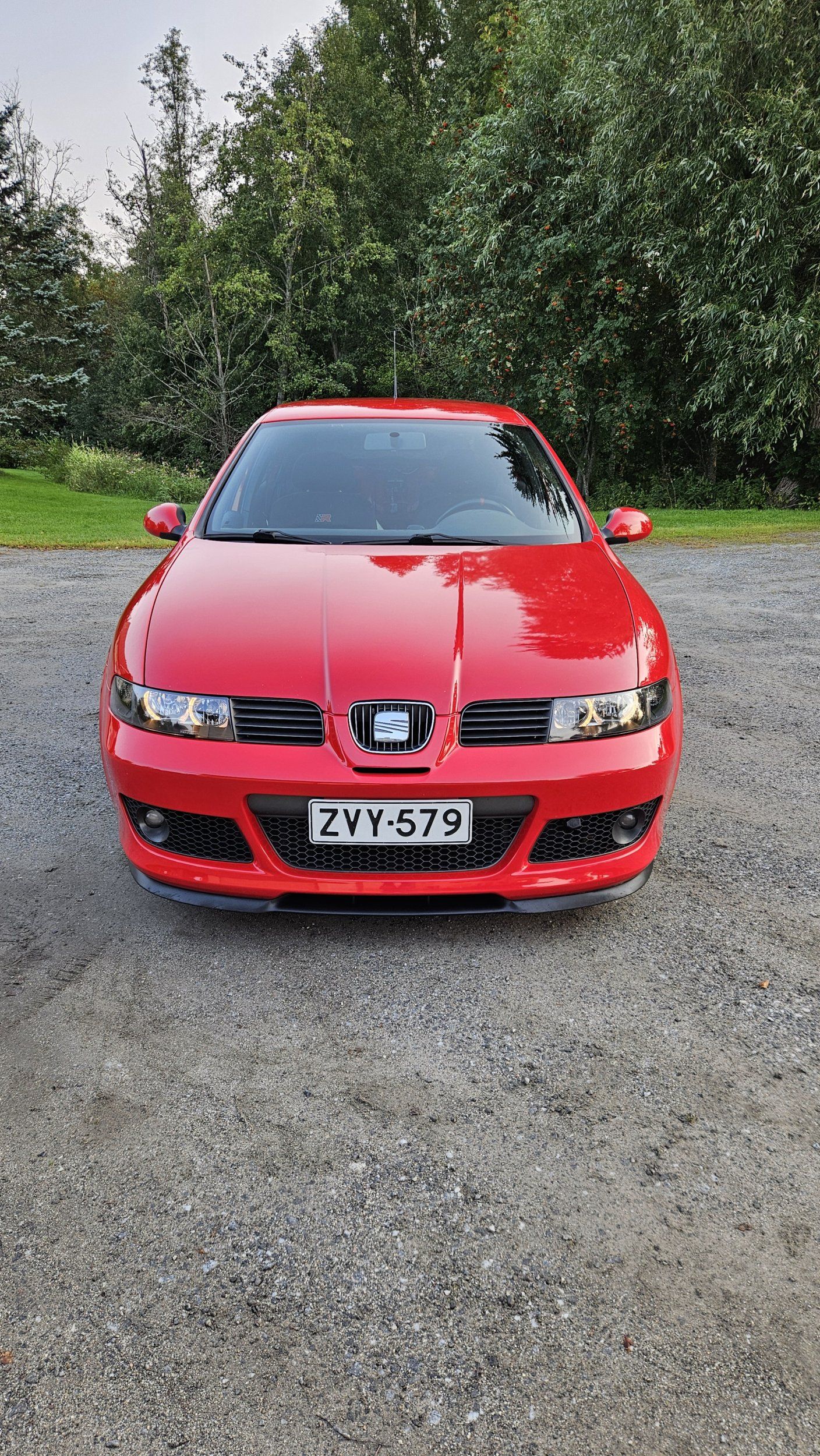

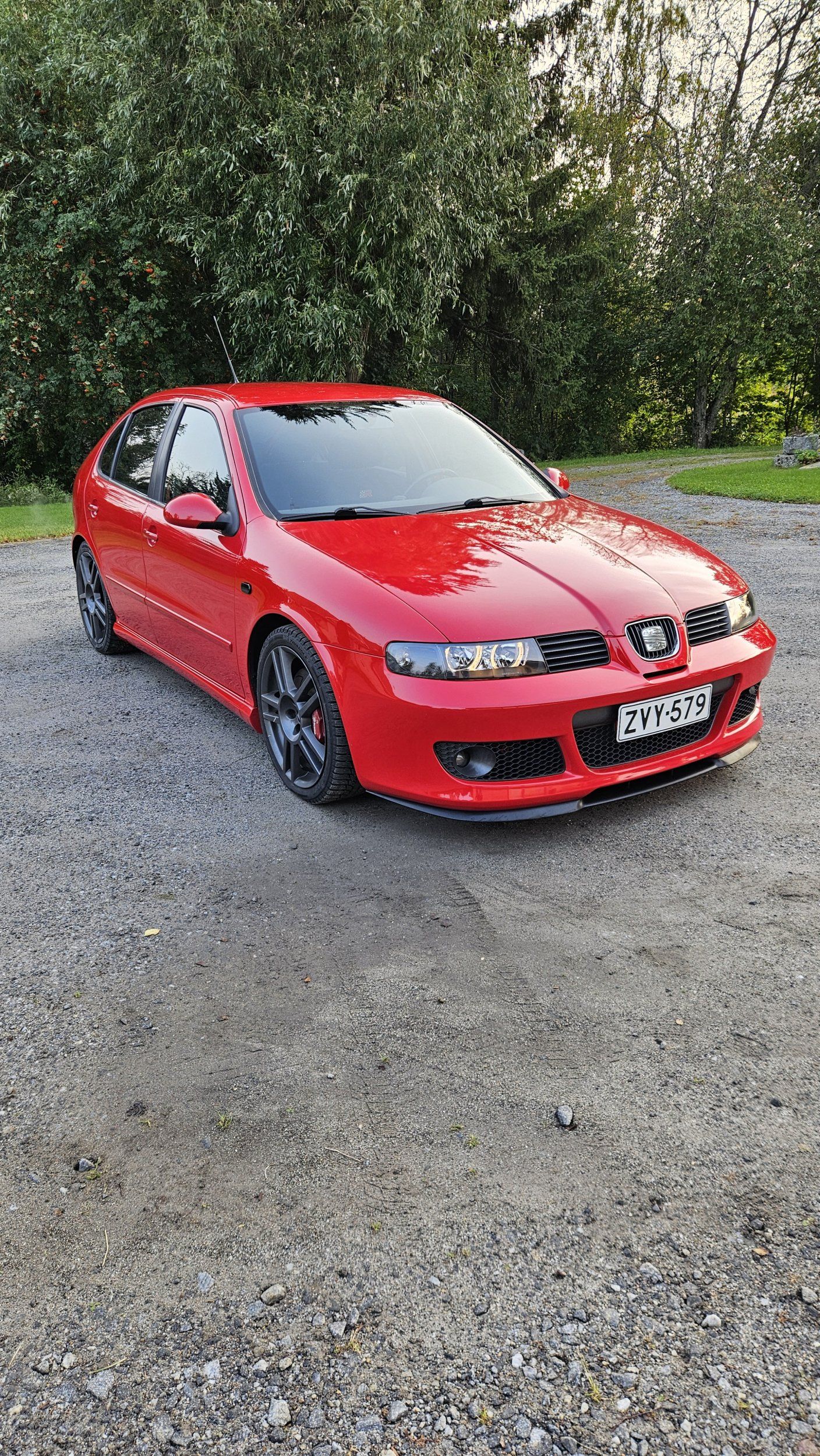

Went full sandblast+2k epoxy on the trunk handle, hope it holds now. Car is back to road now, need a bit of clean+wax and a good photo weather before I can post the final results.
One question: i would like to add some elegant mud flaps at least to front. Has anyone found a model that fits the cupra/fr skirts or do i need to go custom?

@lani; looks stunning ? and it’s great to think you’ve saved a mk1 Leon Cupra and given it many more years and miles / km’s of life.
Kudos to you! ?
Reactions: lani
