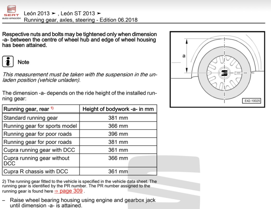

Workshop manuals here have the vehicle ride heights:
From the Running Gear, Axles, Steering manual, FR and Cupra (non-DCC) have 15mm drop vs standard front and rear.
For Cupra and Cupra R with DCC, there is an additional drop 10mm Front, 5mm Rear.
Didn’t know you could get the Mk3 Cupra without DCC. Is that the 265 one?
