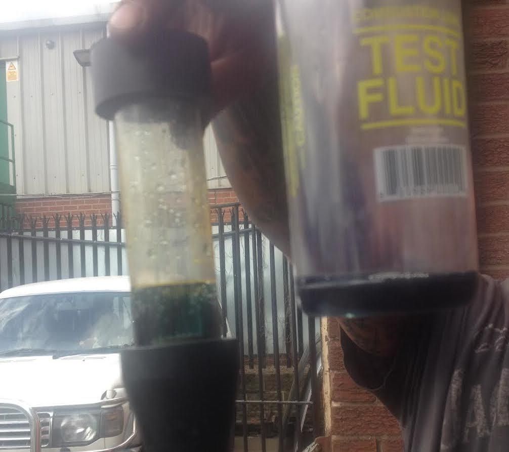

500 miles later and I'm seeing a loss again, so took the car back to the garage for another block test. This time it was fairly cut and dry:

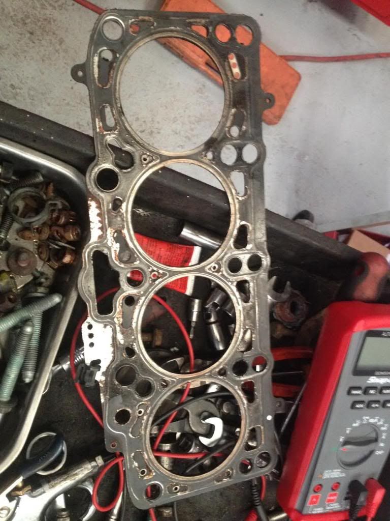

So, it was time to get the head off, and this was what we found...
It's not very clear from looking at the gasket but it had gone around two chambers, the valves looked like brand new hah! Somewhat of a concern was that it had the thickest three hole gasket already on it, but thankfully the head wasn't warped so was able to be refaced without having to be fully skimmed. Whilst the head was off it was obvious the manifold gaskets had seen better days and the manifolds themselves were filthy. After a good old clean later:
