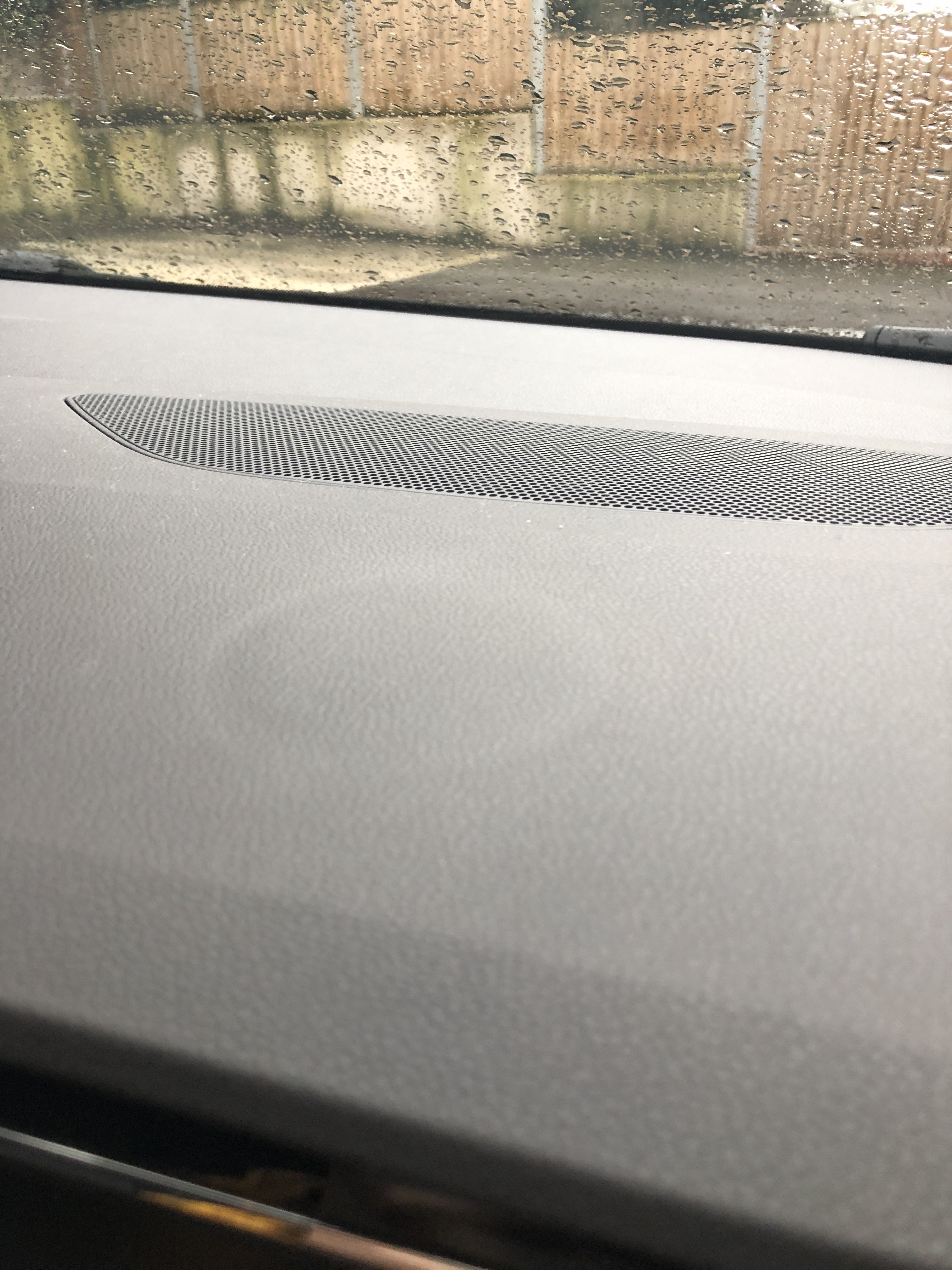

Hi all,
I have a small dent on the soft plastic on the dashboard from the phone holder I was using. I wonder if you guys know how to get rid of it?
It's not very deep but mainly noticeable at a certain angle/light.
Thanks a lot for your help :)

I was thinking of using a hairdryer for this. What kind of suction cup do you mean? I have attached the photo :)
Looks like the vacuum pulled up the material and the ring pushed down the material....
So reversing that would make most sense. Use heat and find a circular object that matches in size and push down while you heat. That should atleast get it to look like 1 even circle and not 1 within the other. then if that works find a new circle the size of the now uniform circle and heat that up and pray to god that will even things out.
This is bro-science but i don't see any other ways beside getting a new dash. Or put one of those middle eastern mats over it ;)

Thanks a lot mate! The indent is really not very deep but just noticeable at angles, so I am gonna try hot water bottle and hairdryer to heat it up and try to massage it out.

Park it in the sun ...have you felt how hot a dash gets in direct sunlight? once sun hot, might be worth a gentle massage. Another way may be some tin foil and sit a small pan of almost boiling water on it, no hotter than 80c. Heat guns are savage in the wrong hands

I know that's why I am a bit sceptical of using a hairdryer. It's getting warmer now so hopefully it will get better. I have tried with a hot water bottle but it hasn't improved it much. Just hope it gets a bit better with time before I have to give it back

Bit of an old post, but stupidly I did the same thing with a suction cup phone mount. using the tips above I managed to make it unnoticeable unless you really knew it was there. I used a hairdryer to heat up the area for 10mins, then immediately rubbed/massaged an ice pack over the surface straight away, I did this a couple of times and its soo much better and no longer an eye sore.
