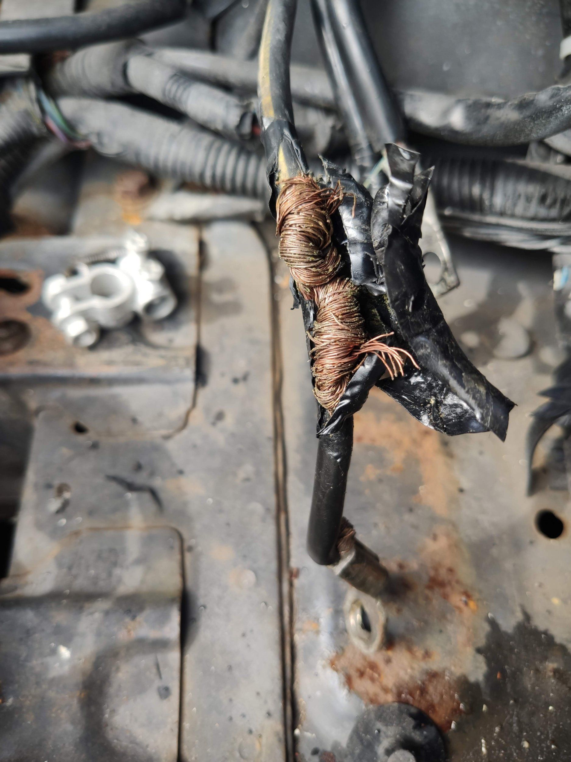

You've checked all your battery cables and all the earth points?
Dodgy earth near the ECU can give it problems.
I don't know, but the main battery earth and the one nearest the ECU would be first to check.
Check the condition of the wires and connectors as well, they might look ok at a glance but could easily be frayed or badly corroded.
If there's any electrical tape on it that shouldn't normally be there, peel it off and see what's going on.
This is the condition I found the negative lead of my Evo in.
