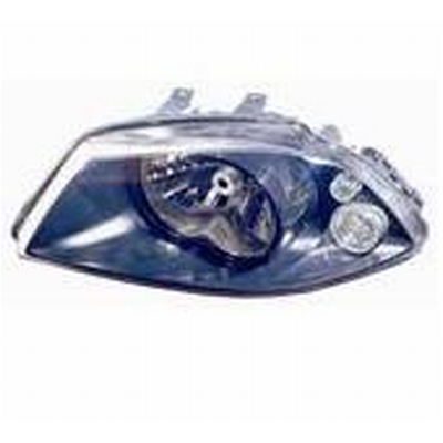

heres the difference
normal,
cupra,
if your buying off ebay then make sure you get uk right hand drive ones as mine were from ebay & its just failed its mot for a left hand drive light due to ebay seller not stating it in the write up. hence why ive got a friends cupra light in at the min :D
