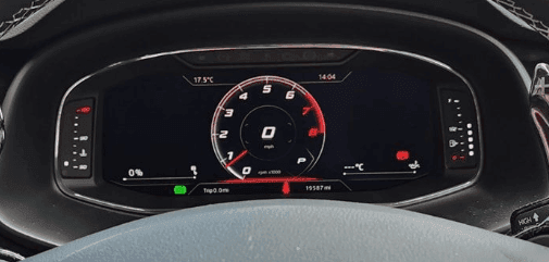

By the way, do you maybe know if it's possible to change the car displayed on the Virtual Cockpit? Mine being a retrofit shows a Leon ST and I'd like to make it show a normal Leon?? Your welcome
It didn’t work, but I found it in Module 17; long coding; vehicle variant: - 5 is for CupraCan you check if you change it from the navi if it will change from your vc
Change radio logo ( Normal, FR, CUPRA, Ecomotive, Xperience, FR Line) Only MIB2 With this mod,
we can change the initial logo and at the same time the figure of the car in the CAR section.
1 - Module 5F - Information electronics
1. Code (20103)
2 - Adaptation
3 - Byte 18 Screenings Value in 0 - Seat Normal Value in 1 - Seat FR Value in 2 - Seat Cupra Value in 3 - Seat Ecomotive Value in 5 - Seat Xperience Value in 6 - Seat FR Line

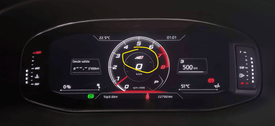

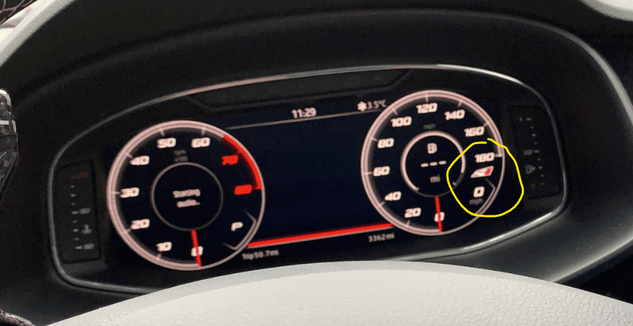

Hi Damo@deeef, any chance you know how to enable the Cupra logo on the Virtual Cockpit?
From:
to:
View attachment 16778 View attachment 16779

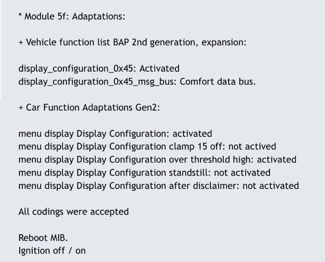

Hey, do you know if you can activate this setting on the cheaper MIB (the one with physical buttons), if the digital cockpit was not retrofitted (or at least not by me)? I got my 2020 Ibiza with the digital cockpit some months ago and I'm missing the settings for the digital cockpit and I'm actually beginning to suspect that they retrofitted it into a finished car, because nobody will notice anyways amirite. Well, seat says I don't have this option, because I got the cheap MIB and the settings are only available on the "standard" one. I don't really believe them, because I also saw a video of someone with a 2019 Ibiza, same MIB, who had the settings. My dad (who is working at the dealership) is still talking to them, and also sent them the video, but any more proof that i should have the option would help. Thanks!

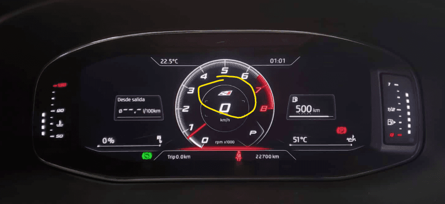

From:
to:
Apparently its only on the A units, and only if you don't update the software that comes on the unit from the factory.Hi Damo, I was wondering if you ever got this coded properly, been looking around for the exact same thing and can’t find any info.
Would have been so cool to have it there when the car is on Cupra mode, but definitely not worth the hassle then.Apparently its only on the A units, and only if you don't update the software that comes on the unit from the factory.
Which is annoying as a software update is likely what stops the units messing up.
