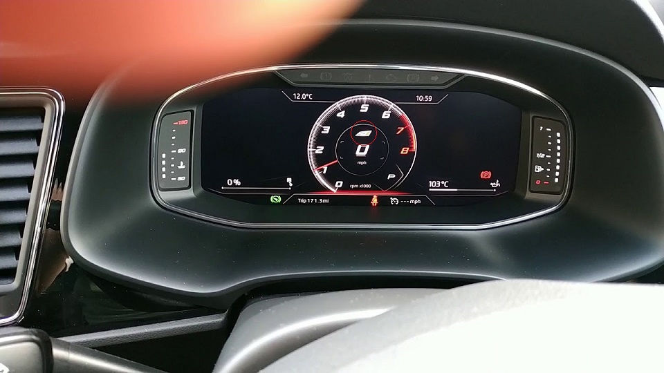

Quick question. Anyone knows how to get the cupra flag on the central rev dial display? Car is my2020 leon cupra with gpf.
I've circled it in the image below.
I think this depends on the revision of the digital dash. You lost likely have the latest revision B. The picture is of the revision A.
