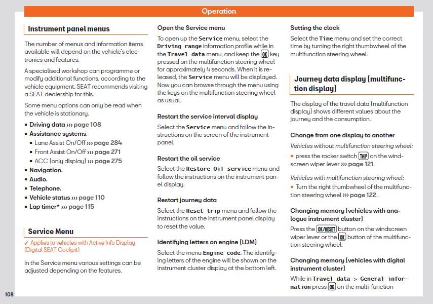

Evening all, can't remember if you can do this (no there was something about holding the 0,0 reset) but my car had a service after the oil service light came on last month, I've not got the inspection light 30 days... on the dash so guess someone at the dealer forgot to reset it...can i turn it off myself in the digital dash? Cheers

Not sure if it can be reset on these cars without something being plugged into the OBD.

Are you sure it's not genuine? An Oil Service is not the same as an Inspection and the first of each are due quite close together.
