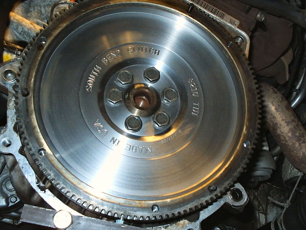

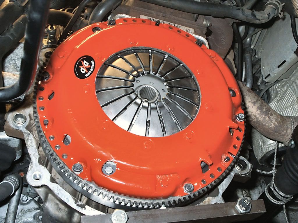

Iv'e just installed a South Bend stage 3 clutch and lightened SMF. My old DMF started to make chatering noises at idle, which is a sign its on it's way out. When I took the DMF out I could move the centre section independently of the out part! Haven't tried it out yet as the car is still missing the sub-frame, as I am changing other bits.....
SMF is the way to go with more power;)
jasengine
2.0L TDI
Oct 29, 2007
213
Wiltshire
Heres the pics:
OLD DMF
SMF
SBC stage 3
