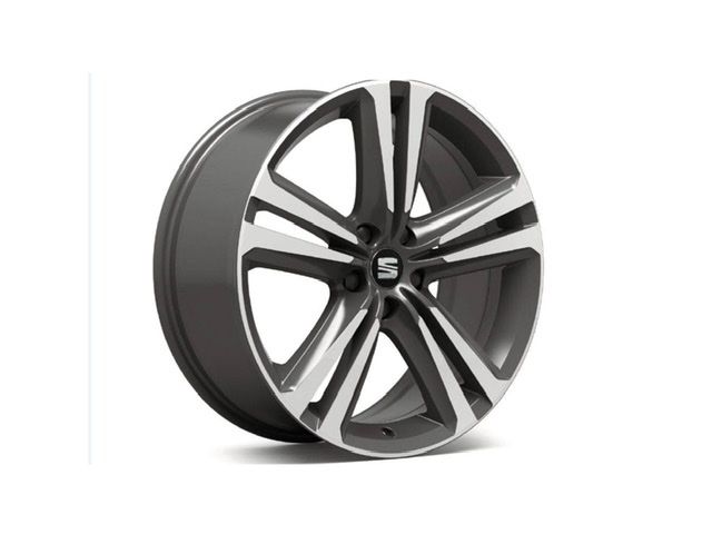

If your alloys are the factory OEM alloys (part number 5F0601025K, manufactured by Borbet for Seat) that were available on the mk3 Leon Cupra like the ones below, they’re 8Jx19” with an offset of ET50 rather than ET45. An offset of ET45 is usually found on aftermarket alloys, so if yours are ET45 then it’s possible they may be replicas; if you remove one you can check the spec details, part number, manufacturer name etc. that will be stamped into the rear of the spokes.
Based on the information provided at the link below, when the 340mm macan calipers are fitted to the VW equivalent car to the Leon Cupra (mk7 Golf R with factory 19” VW Pretoria alloys 8Jx19” ET50, also manufactured by Borbet), it states that 10mm spacers are required. Maybe they’re just being cautious if @TripleBob has said they’ll fit comfortably behind factory 19” alloys.

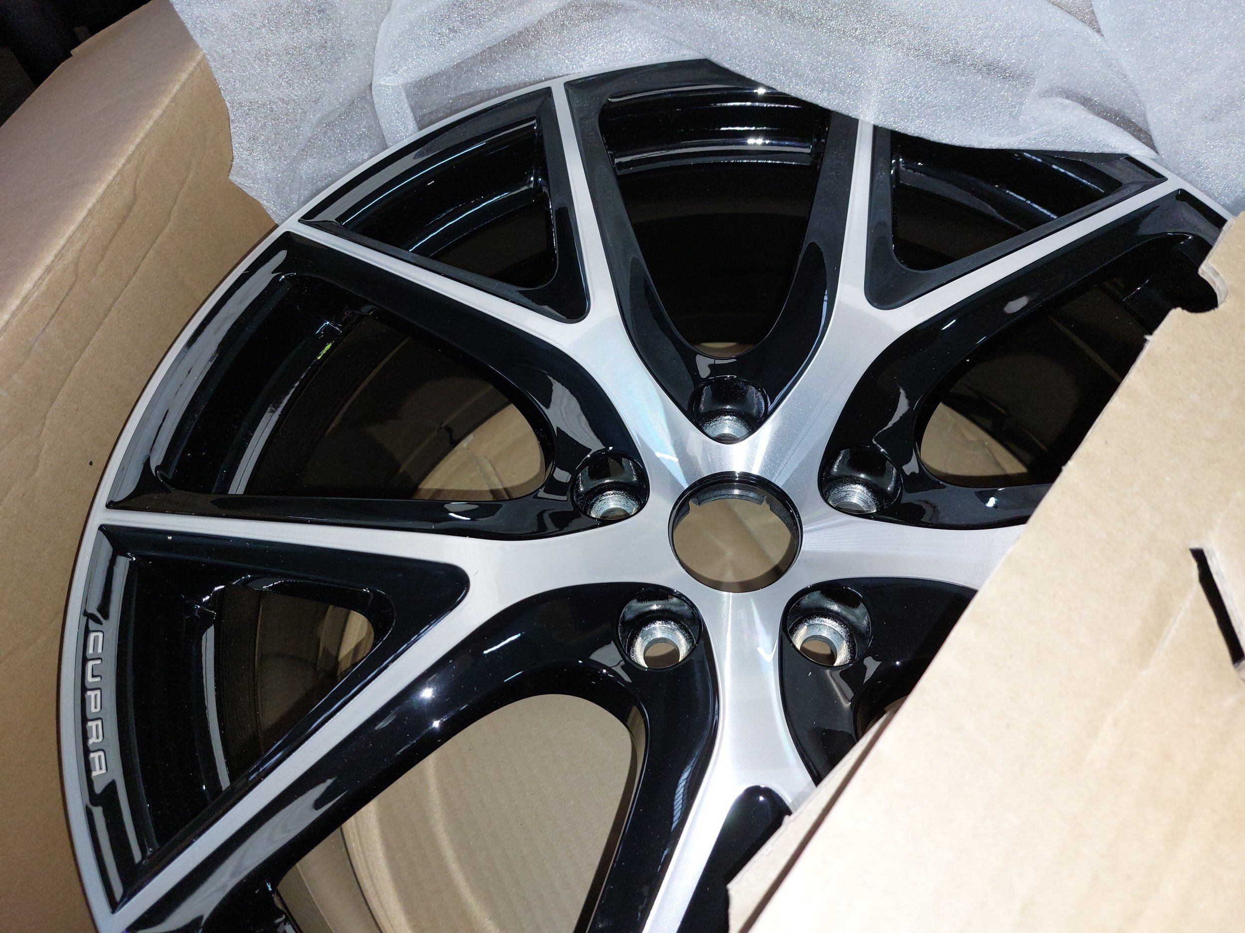

Not all the mk3 cupra alloys are et50 the carbon edition wheels are et45 not sure about cupra r wheels.
I would agree and think spacers are required.
