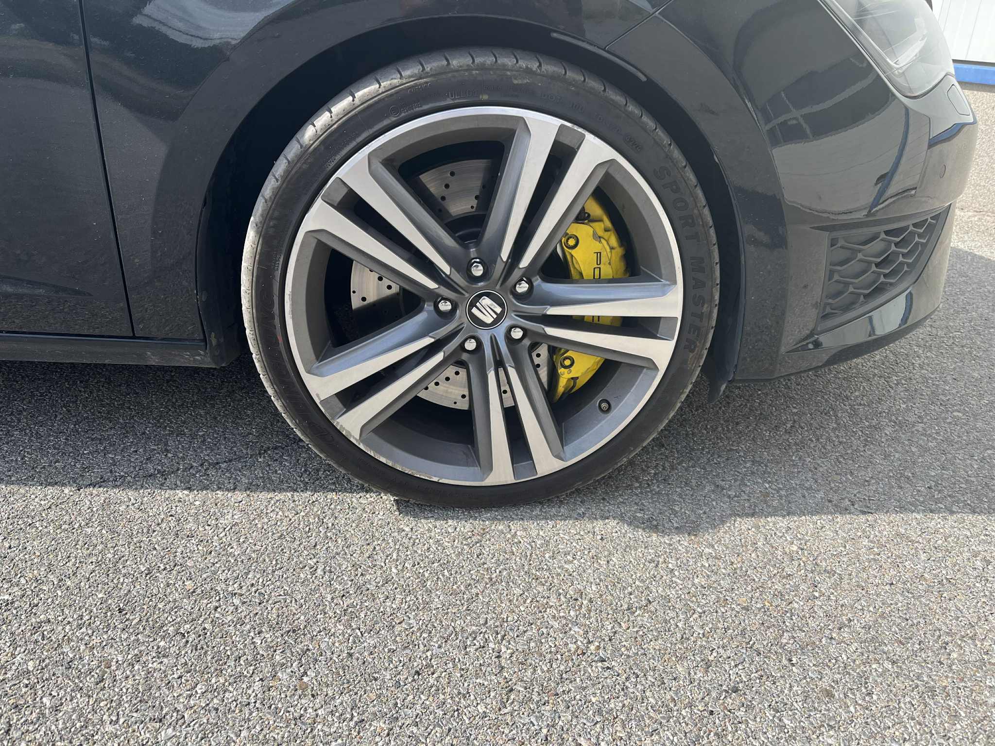

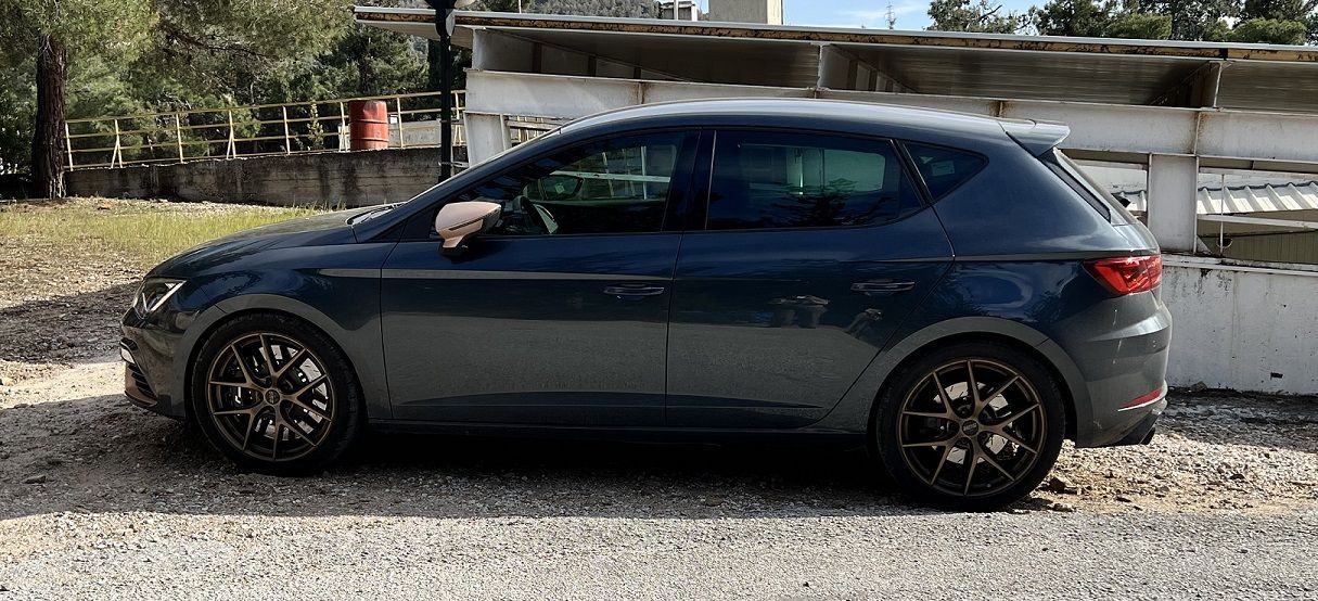

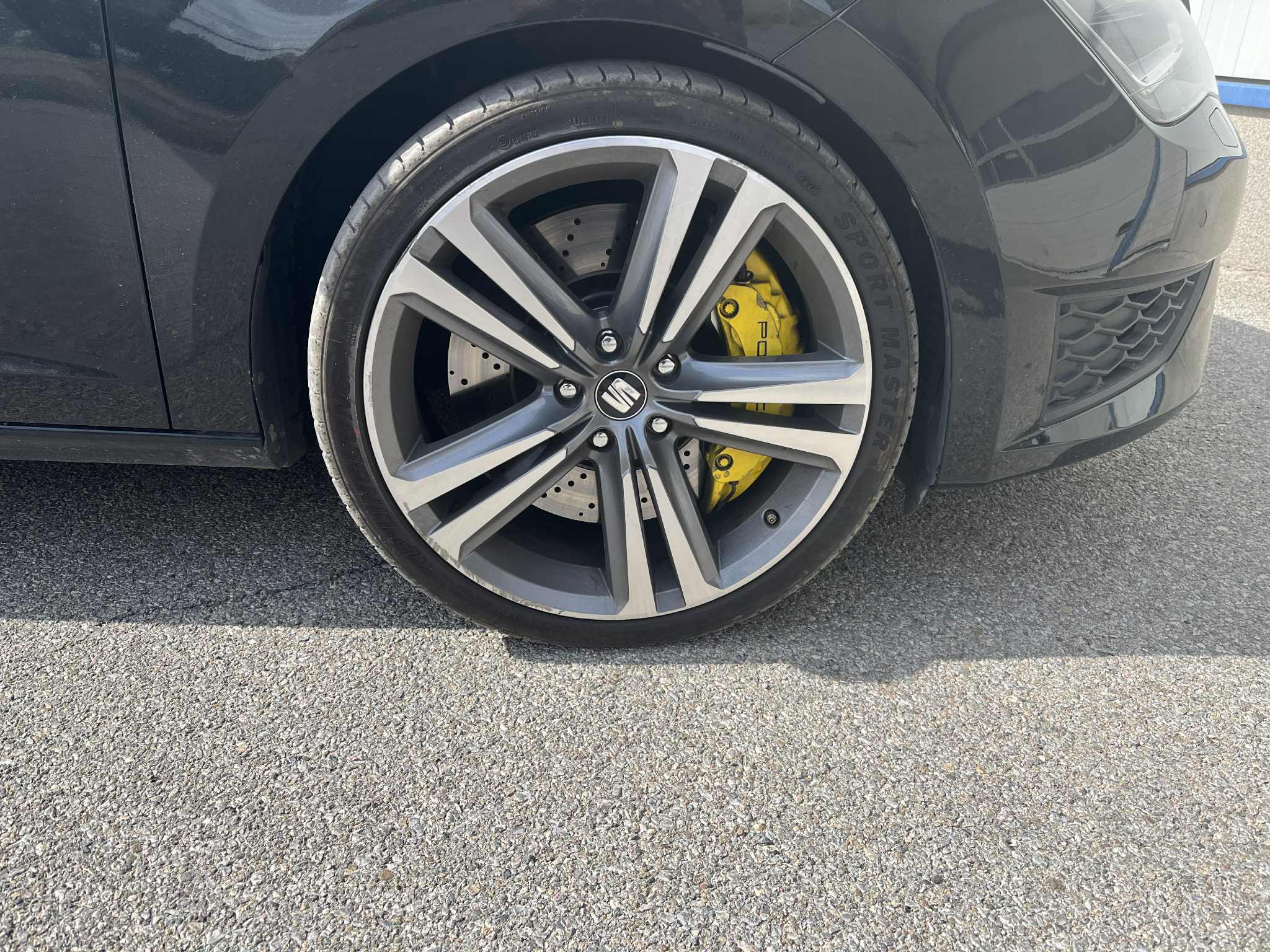

Hey guys, I upgraded my brakes with 6 pot caliper from porsche with 375 mm disks, and so i was wondering what it the max ET and J you use on your cars, because it seems that it should be under ET40 so it can fit on the calliper, but i don`t know if I can use 8.5J with ET40, because I don`t know if it will rub on the wheel arch or in the insede on the shock. Any help would be great thanks.
At the moment i`m running the stock wheels with 15mm spacers on the front and 20mm on the back, but there is a lot of rubbing on all four wheels.

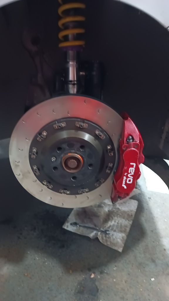

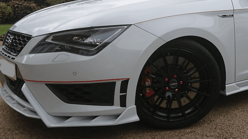

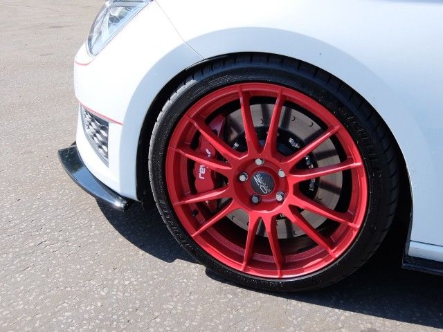

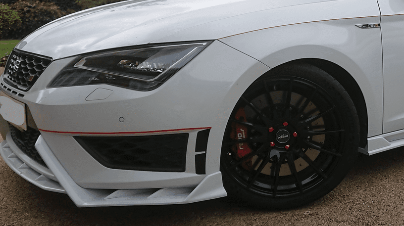

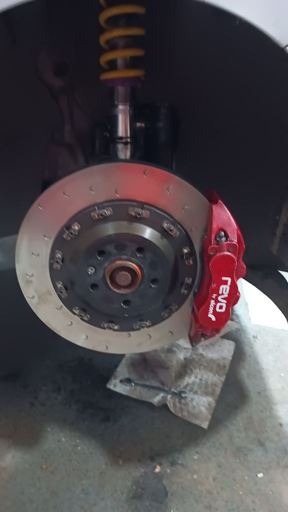

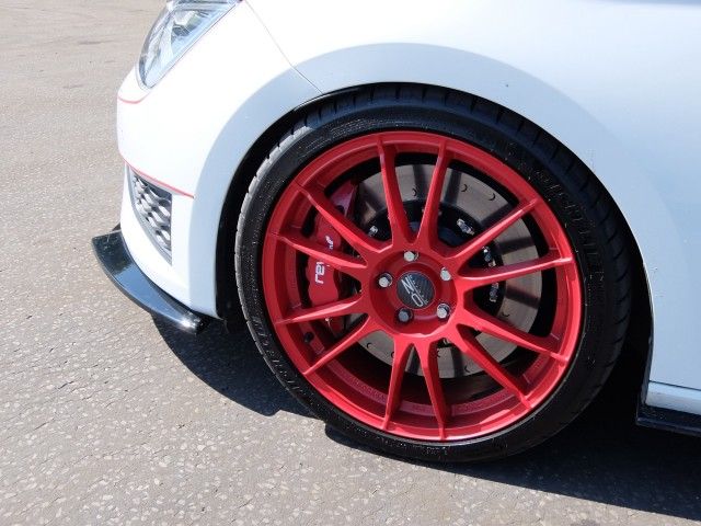

I am running Alcon 6 pot 380 x 32 mm and run the following wheels
8.0x19 5x112 ET45 OZ RACING ULTRALEGGERA HLT
8X19 FOX FX004 5X112 ET45 73.1
No spacers but I do run negative camber on both front and rear wheels and lowered with coilovers.

Hey, thanks for the responce, can u share some pics ?

These are very old photo's but it gives you an idea of the setup, I would also point out in parts of Euope you cant use this setup as it wont pass inspection, lucky in the UK we dont have the difficulty as long as the seup is safe.

beautiful setup, but i feel like mine are sticking out too much from the center of the wheel, that`s why i need a wheel with at least ET40, but if it ET40 and with 8.5J will it rub on the arches or the inside on the shock

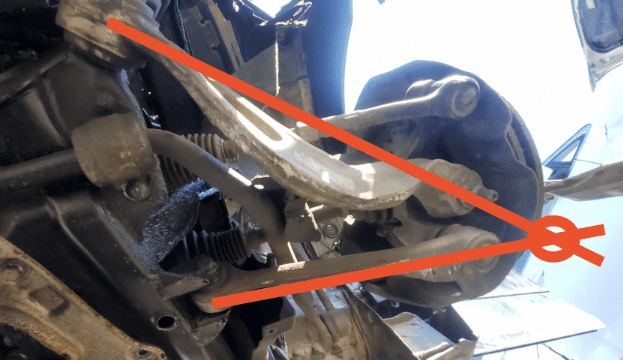

This is one of the reasons you don't find many MacPherson strut type suspensions with big brakes! Difficult packaging!
All the big Audi's/Porsche/BMW etc, use multi link suspension which incorporate virtual steering axis (two ball joints) so they can package much bigger brakes and still get good wheel geometry.

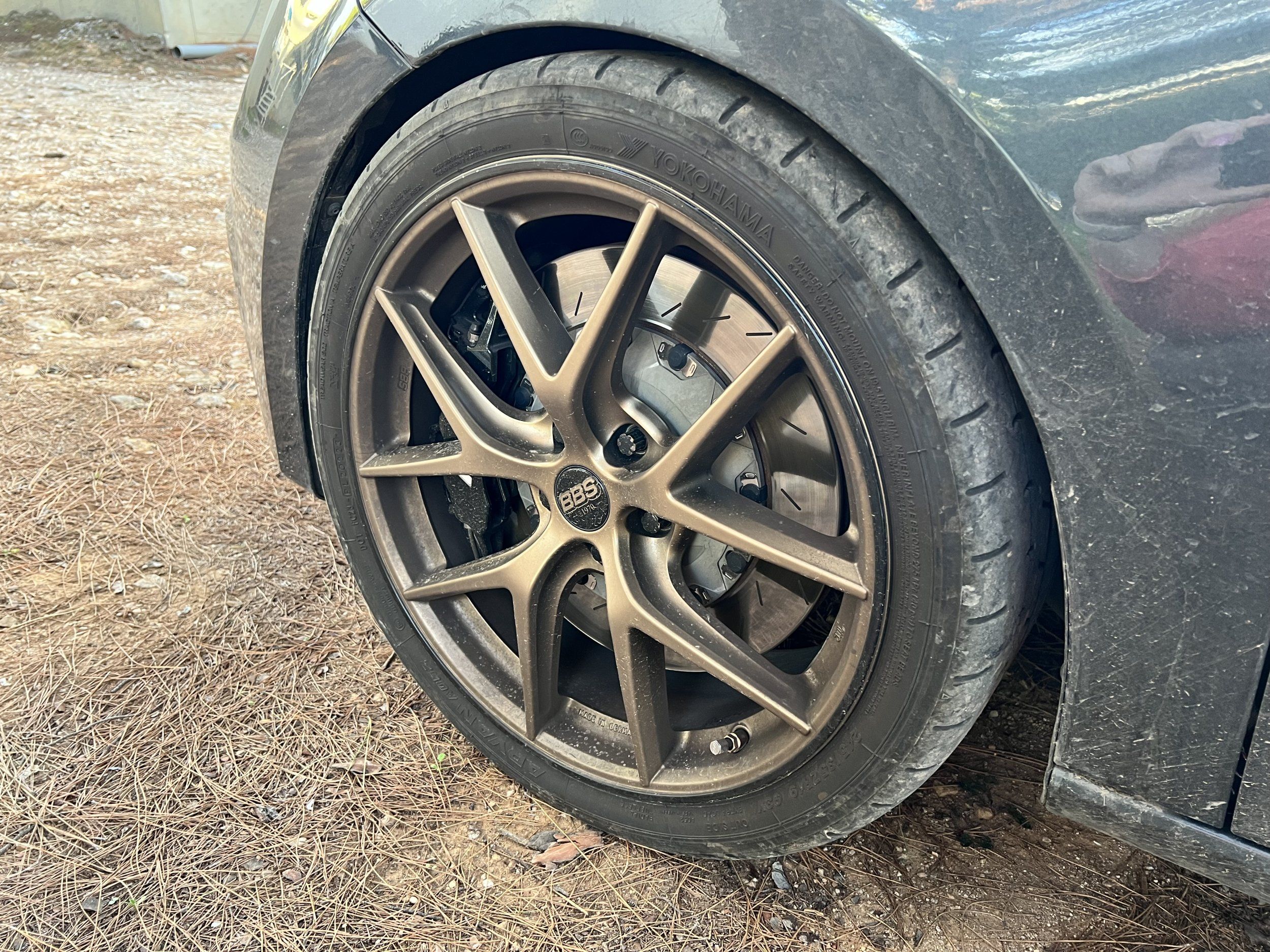

My current wheel setup is 8.5*19 ET45 BBS CI-R wheels with 245/35 tires, the front brake setup is the Racingline 6 pots with 380 discs. Car isn't lowered or has spacers. At first it rubbed like crazy on these little plastic arch things any time the road wasn't a smooth as a racetrack. Since I had them removed it still rubs but only if I hit a crater.
