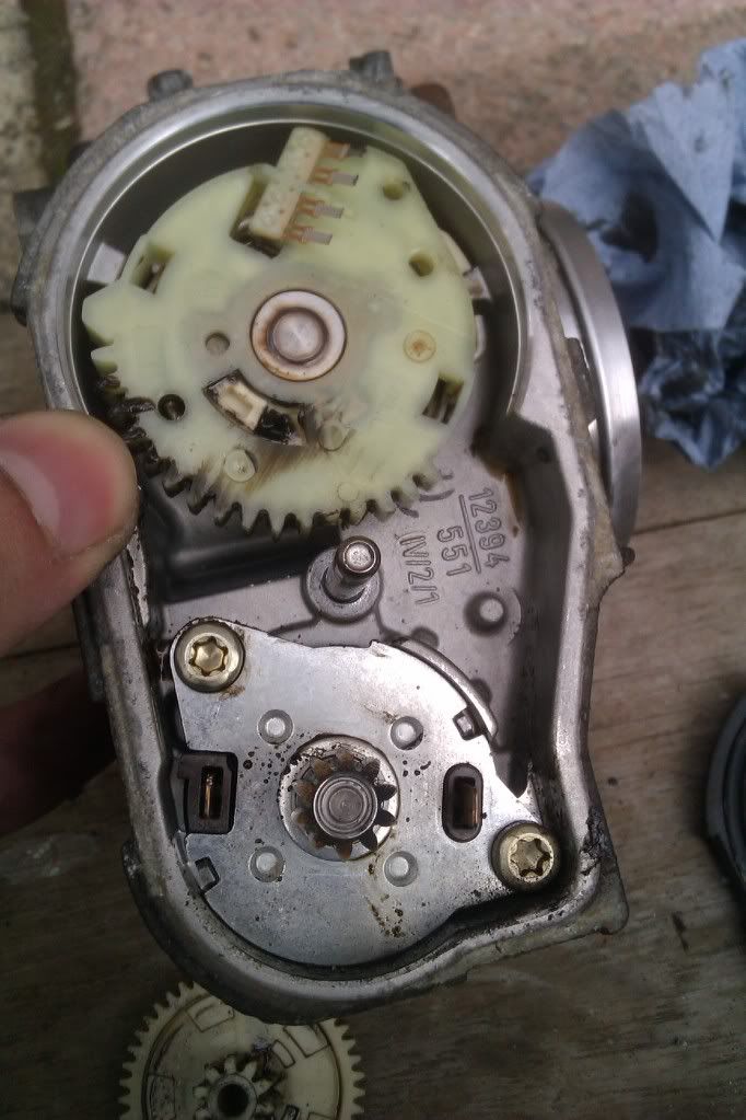

No need to clean it... It's started making very loud clicking noises like a cog skipping... Can it be opened up? It's now on the kitchen table as its as much use there as on the car ATM!!!

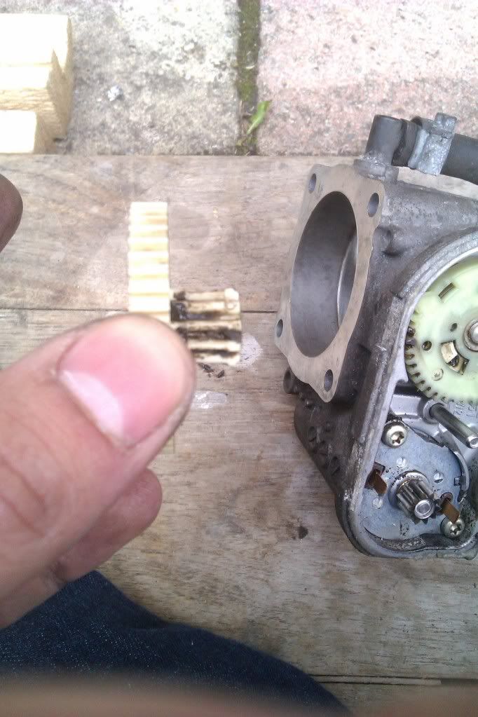

Update
This is the problem here...
worn teeth +
More worn teeth! = motor not actually able to move the throttle flap at all, = no adaption being done and the car driving very very badly!!!
So newer, not broken, unworn one is required!! As no one wants to know the price charged for a new one!

For info in case any one searches such things.... Hahahah
New (unbroken) throttle body, gasket, and an adaption with vagcom. Problem solved...
