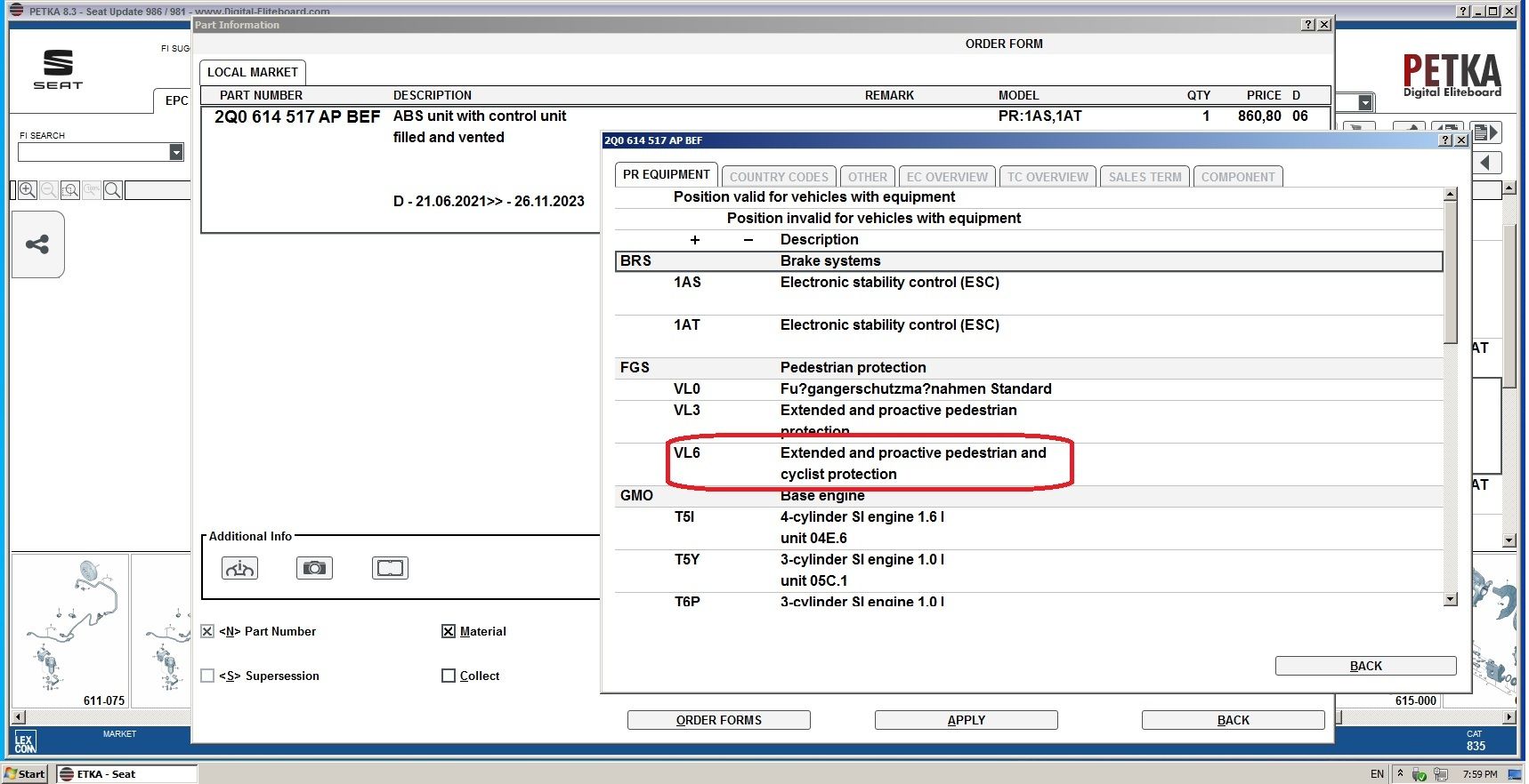

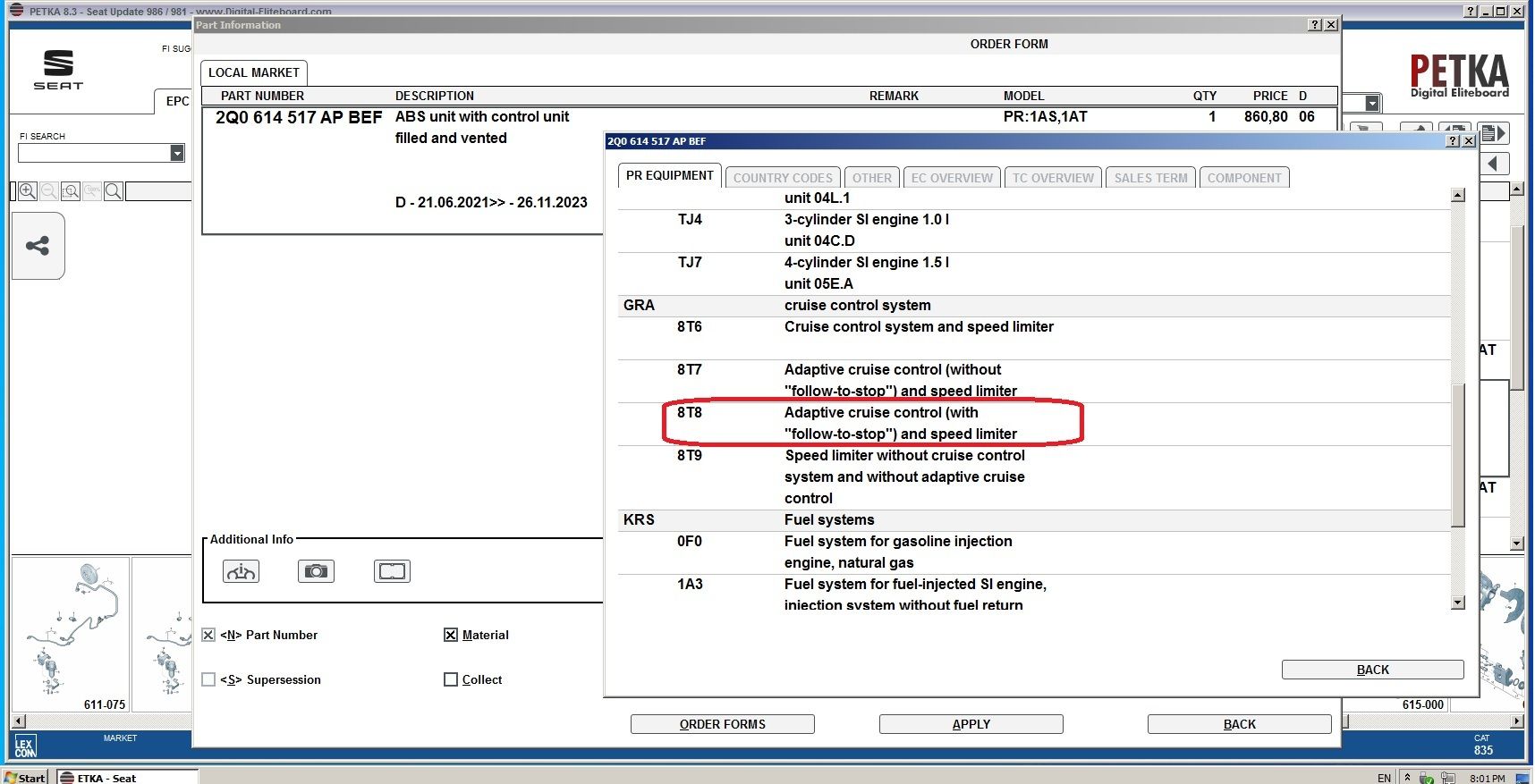

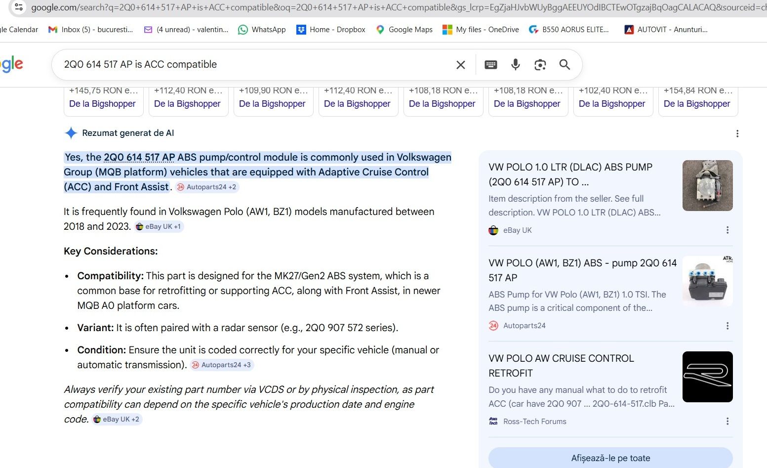

1. 2Q0 614 517 AQ ESC_high coding is ok for DSG + ACC (10009002, 10009003, 10009007, 10009008).
2. What exactly causes FAULT_ESP_CONS_ACC? - ACC incorect coding.
3. What causes SCL_ACC_Anhalteweg_Error in the ABS? - ACC incorect coding.
