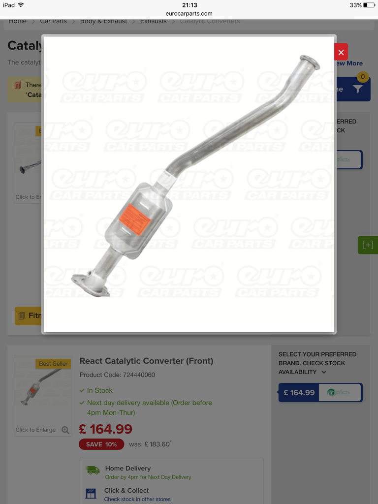

Thanks BigJohn for your replies, unfortunately ECP had listed a cat that would be illegal if it was sold to fit my car, since it was registered after March 2001. I called ECP to confirm this and the guy on the other end said using his internal search for parts for my car via my reg plate he could only see one choice which wouldn't actually fit my car since on the supposed replacement part, the cat was located where the downpipe should be and the bends were in the wrong place. He then said it was a listing error and would get it put right.

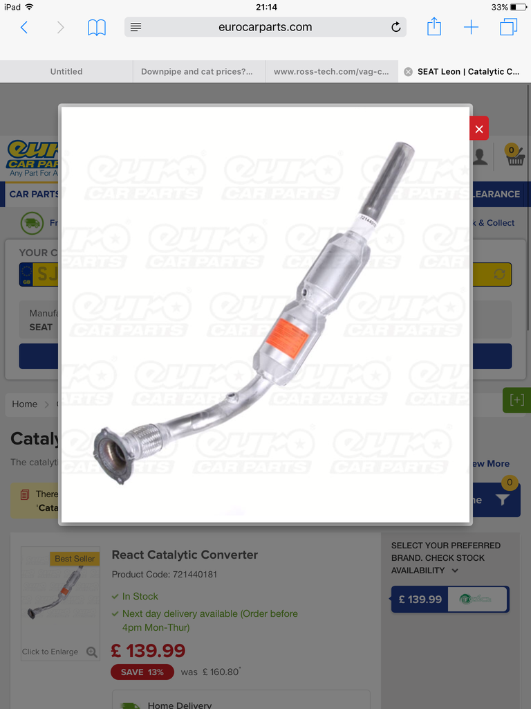

Second photo is what I've got on mine
That's what I found but that second one had a note in the fitment detail that said it was illegal to sell for any car registered after March 2001. And it didn't come up when ECP searched for it when I called; the first photo was the only one that turned up in ECP's search. He said it was an incorrect listing.
Haha well it's on my car now and passed an mot so I don't no what the guy was on about
