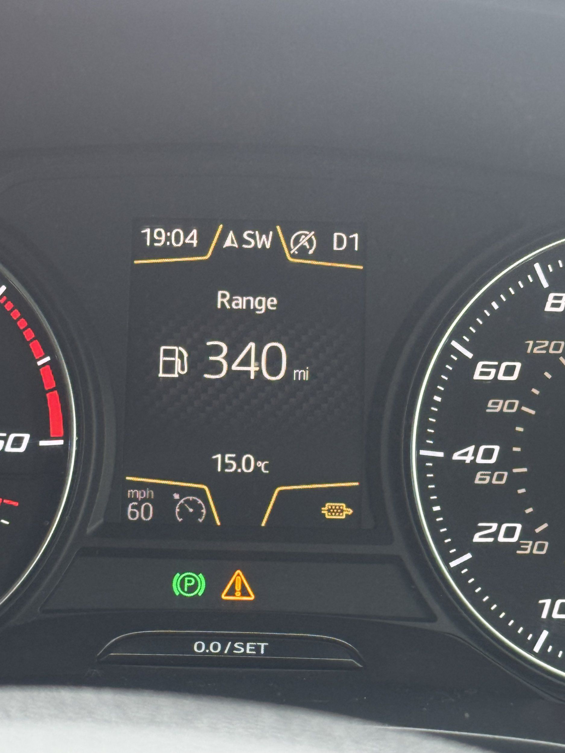

I have just recently bought a Leon FR2 2.0 TDI, it drives perfectly cant complain, only issue is the DPF keeps regenerating, I have even been on 2 motorway drives for around 30/40 minutes, keeping it around 2500rpms. Today I went on another motorway drive for around 45/50 minutes to try let it regenerate properly however there was some heavy traffic at points but i did manage to get at least 25/30 minutes of driving with 2500rpms, but still it was not able to regenerate, and then as i got home, the DPF light came on. I left the car off because I will try go to the mechanic tomorrow. But I have plugged an obd in since and its showing zero faults and all sensors to be working properly, I am just not able to check the dpf levels with the obd I have.
What should I do? Any advice would be great!

Unfortunately, probably the reason it went up for sale. I'd look to see if you have a local 'The DPF Doctor' or similiar, that specialise in diagnosing DPF issues. A garage might just say you need a new DPF, but the problem lies elsewhere and would return at some point.

Yes unfortunately you've bought a car with a major issue. If you've done all those motor miles it should be well regenerated by now. Avoid driving the car if you can until the issue is sorted, because if you keep driving it the dpf will get more and more full until it is critically full and then the dpf is wrecked

Once you get above a certain soot level - regen by driving is no longer possible.
If you have VCDS or OBDeleven you can do a forced regen like the stealers would do to try and recover it.

Ahhh im hoping not, the last regen did complete as the idle went down and then the fans were off after i turned the engine off. I will go to the mechanics tomorrow and see what they have to say.

Yh i understand that but the car is still regenerating, im hoping its only a sensor

Ok, so that would be unusual for the DPF to completely block at that mileage without some other external factor - like high oil consumption (burning oil is bad for your DPF) or a faulty sensor.
How many miles do you drive per year? what's your usual driving route (diesels aren't the best for short/town journeys)?

A clean should sort it out, find a company nearby that offers cleaning, the solution Terraclean make for DPF cleaning is supposedly very good.

I do 8-10k a year, it’s mainly motorways hence why i bought a diesel car

UPDATE: DPF is clean and the car was showing an electrical fault and ac fault, I reckon this was messing with the ECU, this has since been cleared and will find out if it is one if the sensors

the issue causing the problem was the cruise control module. The module was most likely sending corrupted data due to a communication fault, which is making the ecu to misinterpret driving conditions or sensor inputs, which ended up in my case, making it read the dpf wrong, hence the frequent regens. Code was cleared and car was fine so this will need a closer look.
