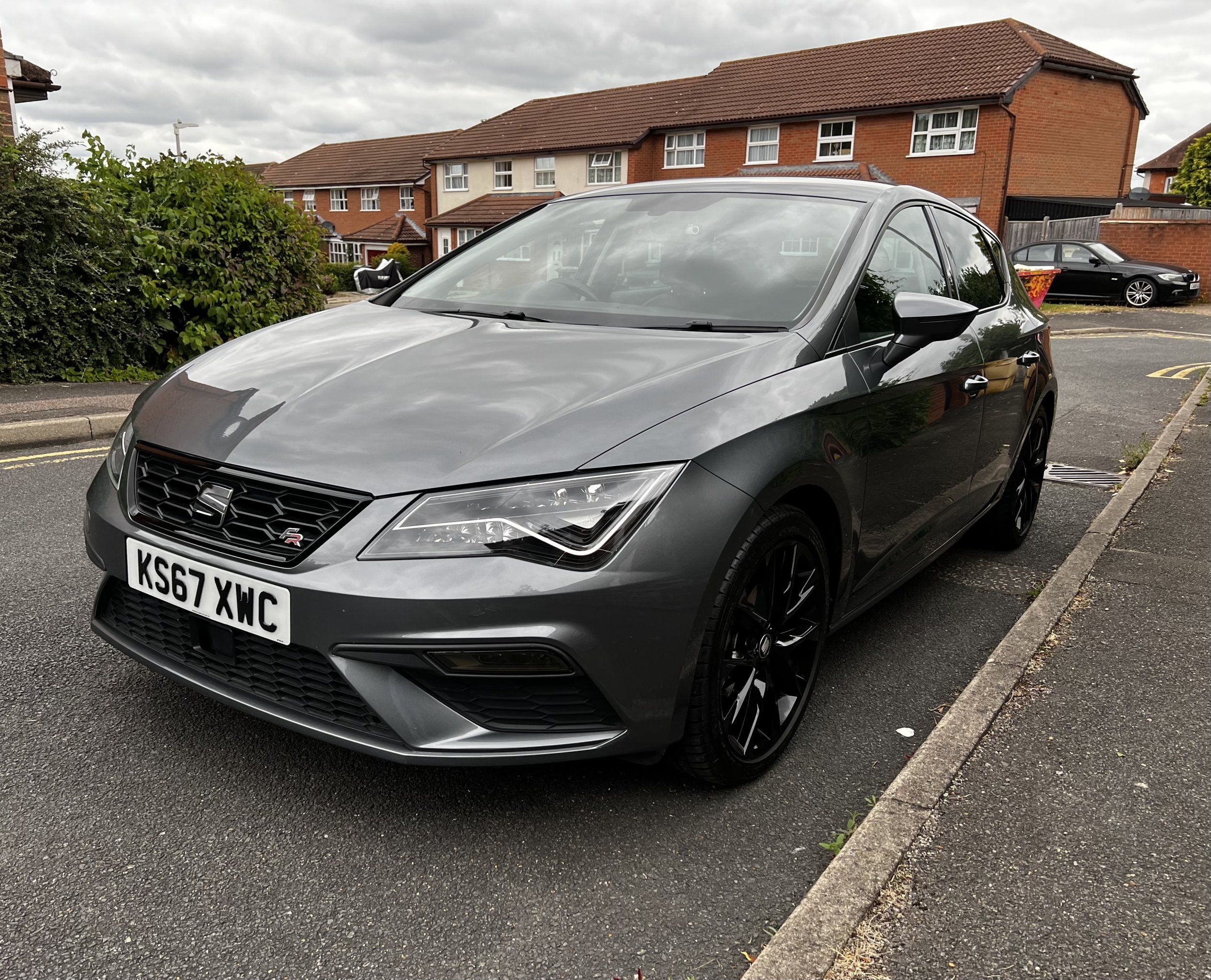

Hello everyone,
been lurking on the forum for a bit so thought I would join.
I’m hoping you guys can give me a bit of help/reassurance.
I have a MK3 Leon FR 1.4 DSG
I have come across some Information on the DQ200 being awful and then stupidly googled it!
I’m really hoping that the issue have be resolved with this box as I really love the car and was planning on keeping it for a few more years yet.
The car is not driven hard, it is not mapped. Covered 39,000 miles.
