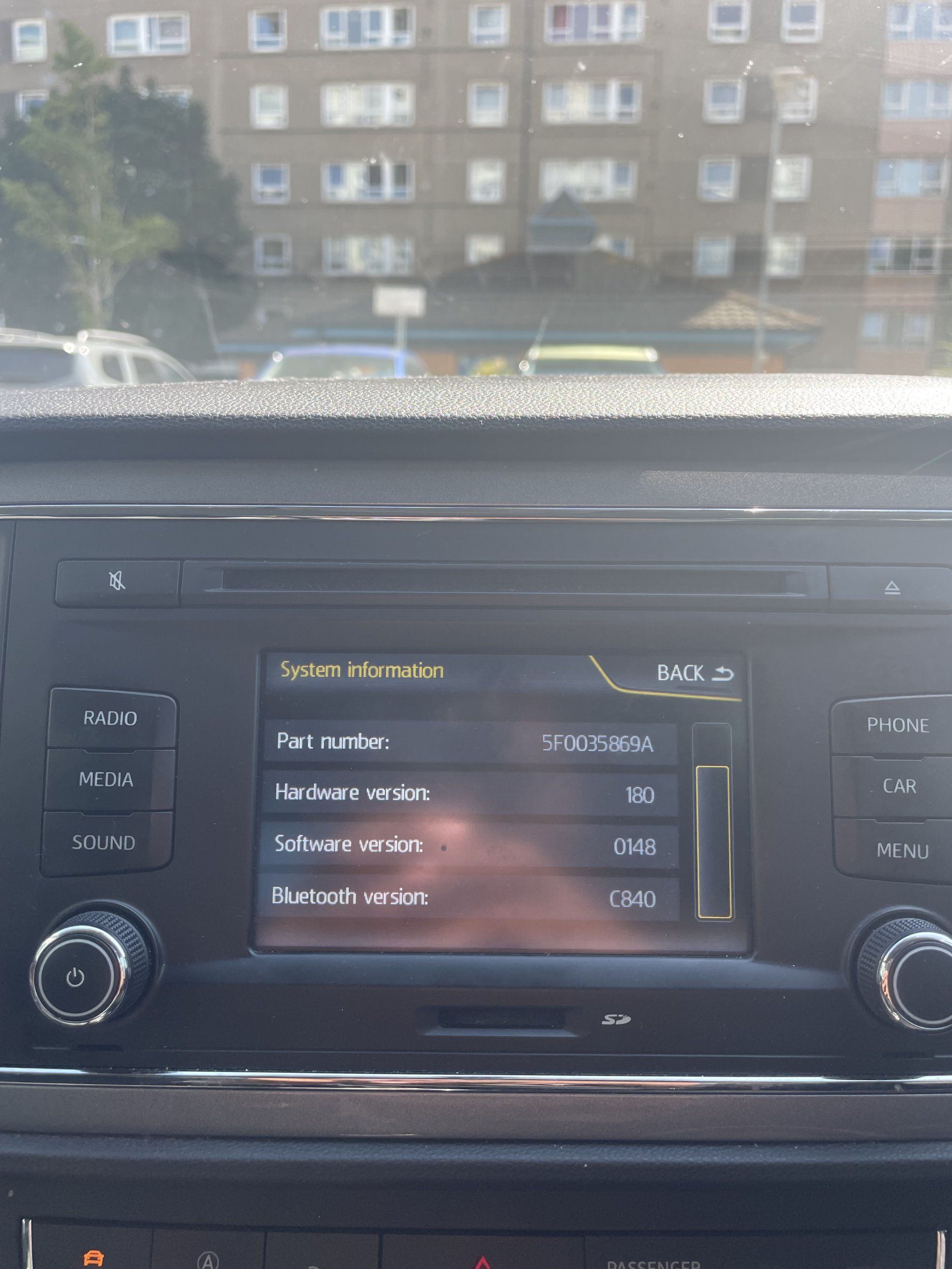

I own a 2014 SEAT Leon FR TDI DSG and i'm looking to upgrade the infotainment system to the more modern one that you would find in the SEAT Leons post 2017. I've checked my system information inside my car and it states this:
Part Number: 5F0035869A
Hardware Version: 180
Software Version: 0148
Bluetooth Version: C840
Hope this helps!

Thanks for the explanation. And yeah i figured the display i have is the crappy one but I’m more of a minimalist person so the sleek look of the facelift screen looks better imo but you said the 2nd screen is the best spec one with the 4 buttons on each side. I also assume that my car is MIB1 based on what i can see from my glovebox right?

Yours is not MIB1. MIB1 has 4 buttons either side of the screen and has the navigation. MIB1 does not have Android Audio/carplay.

Your model is a basic radio. You can fit the MIB1, or the MIB2, or the Chinese android radio. For MIB1 and MIB2 you need to buy a display, wiring, unit mounted behind the glove box. On top of that there is the coding. When buying an android radio, you only need to replace what you currently have.

You’ve got MIB1entry
You can install MIB2 6.5” or 8” but you’ll need additional parts as you don’t currently have an infotainment control module in the glovebox
