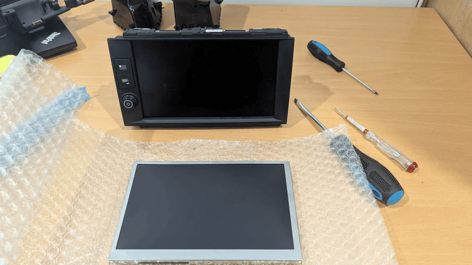

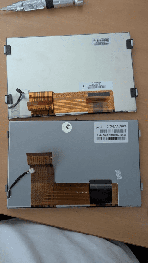

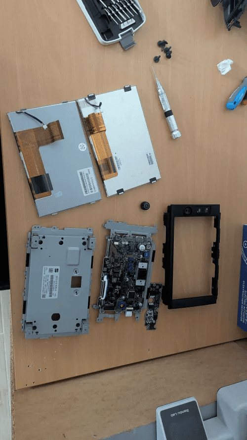

Easy, just order the touch from Ali and replace, it's very easy to do.
Here are some pics:
Lower one is the Ali screen:
I've been using the new touch for some time now, no problems even in high heat. The screen looks almost identical.
If you need more info feel free to shoot me a message :)
