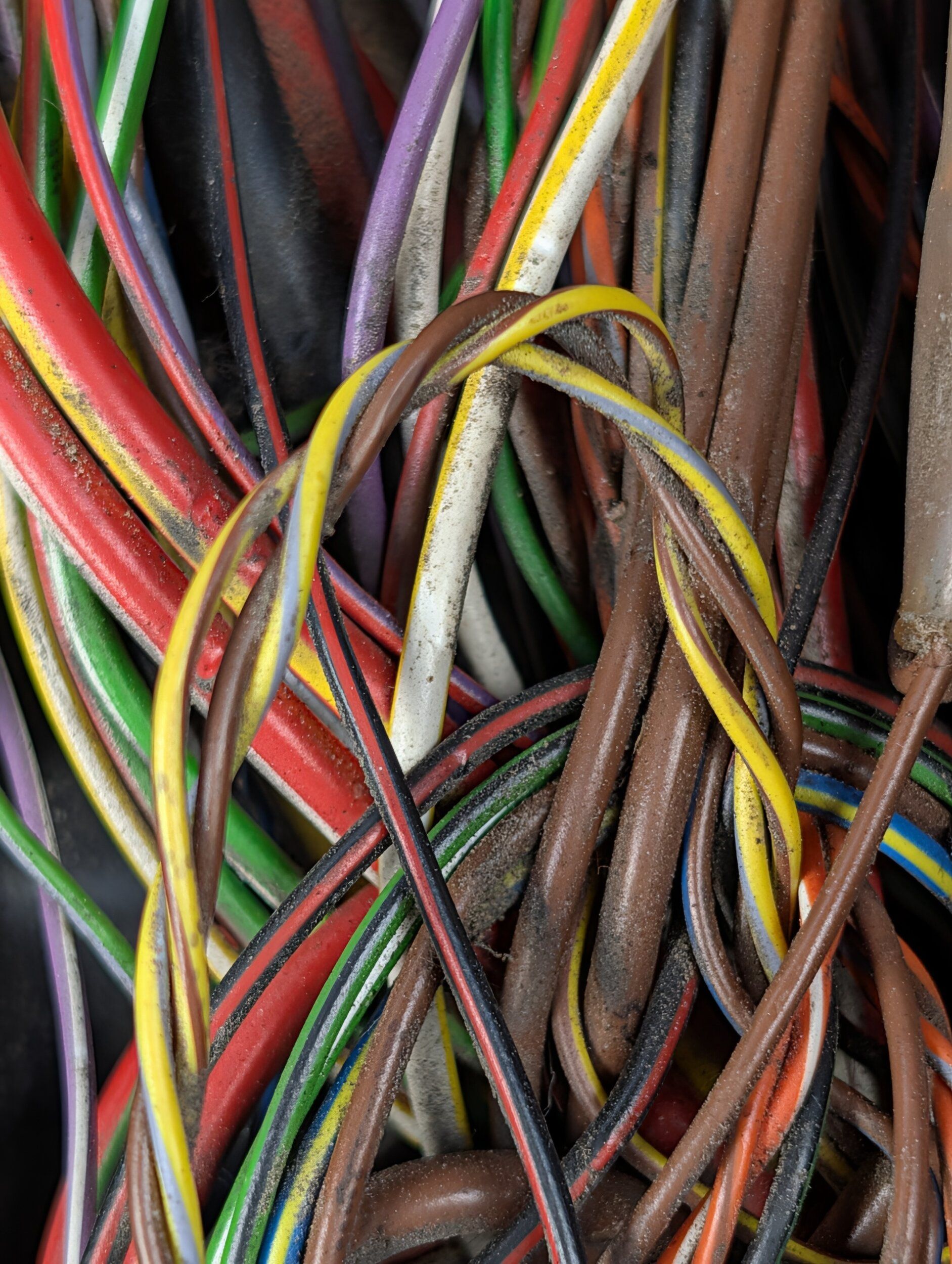

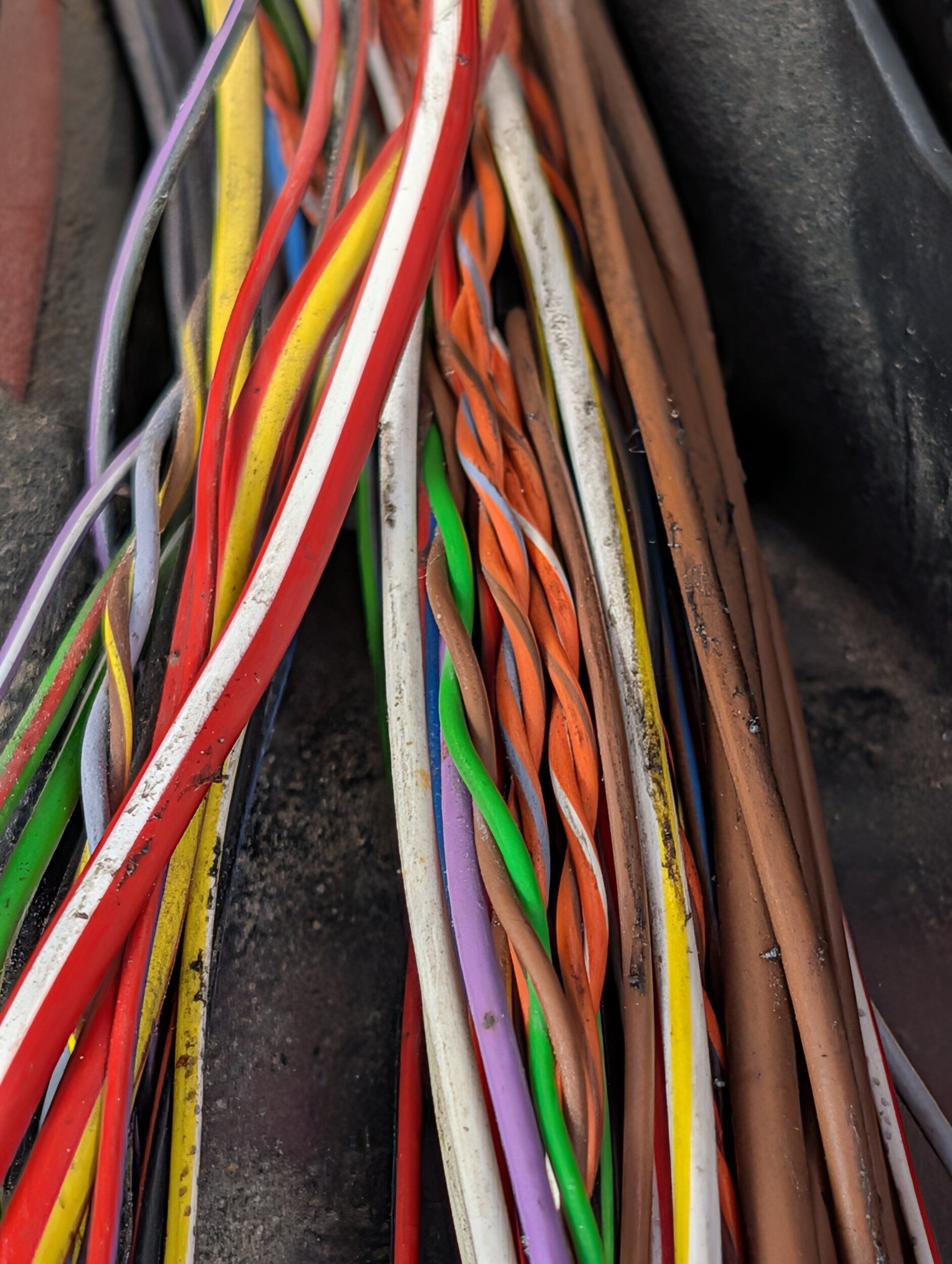

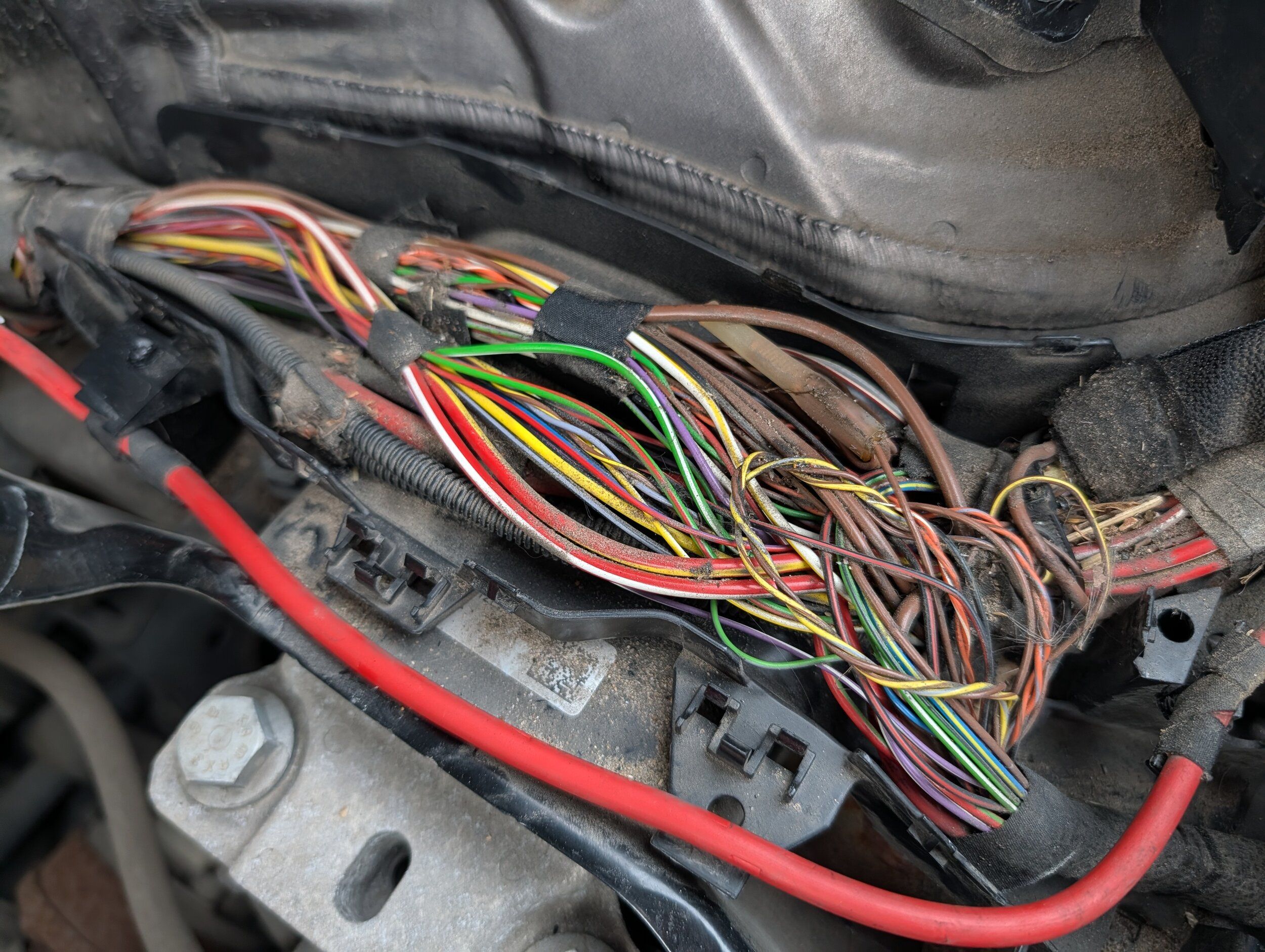

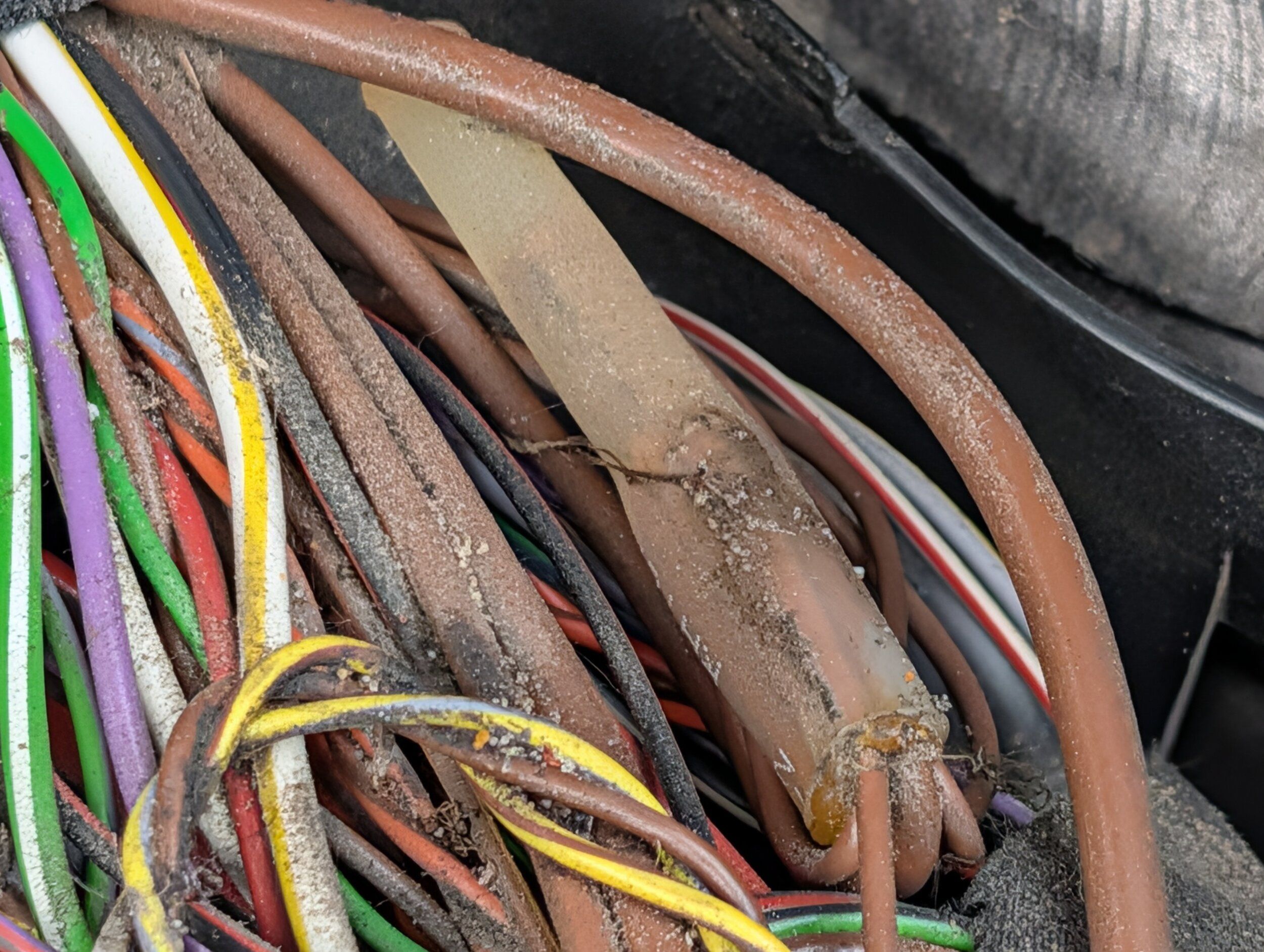

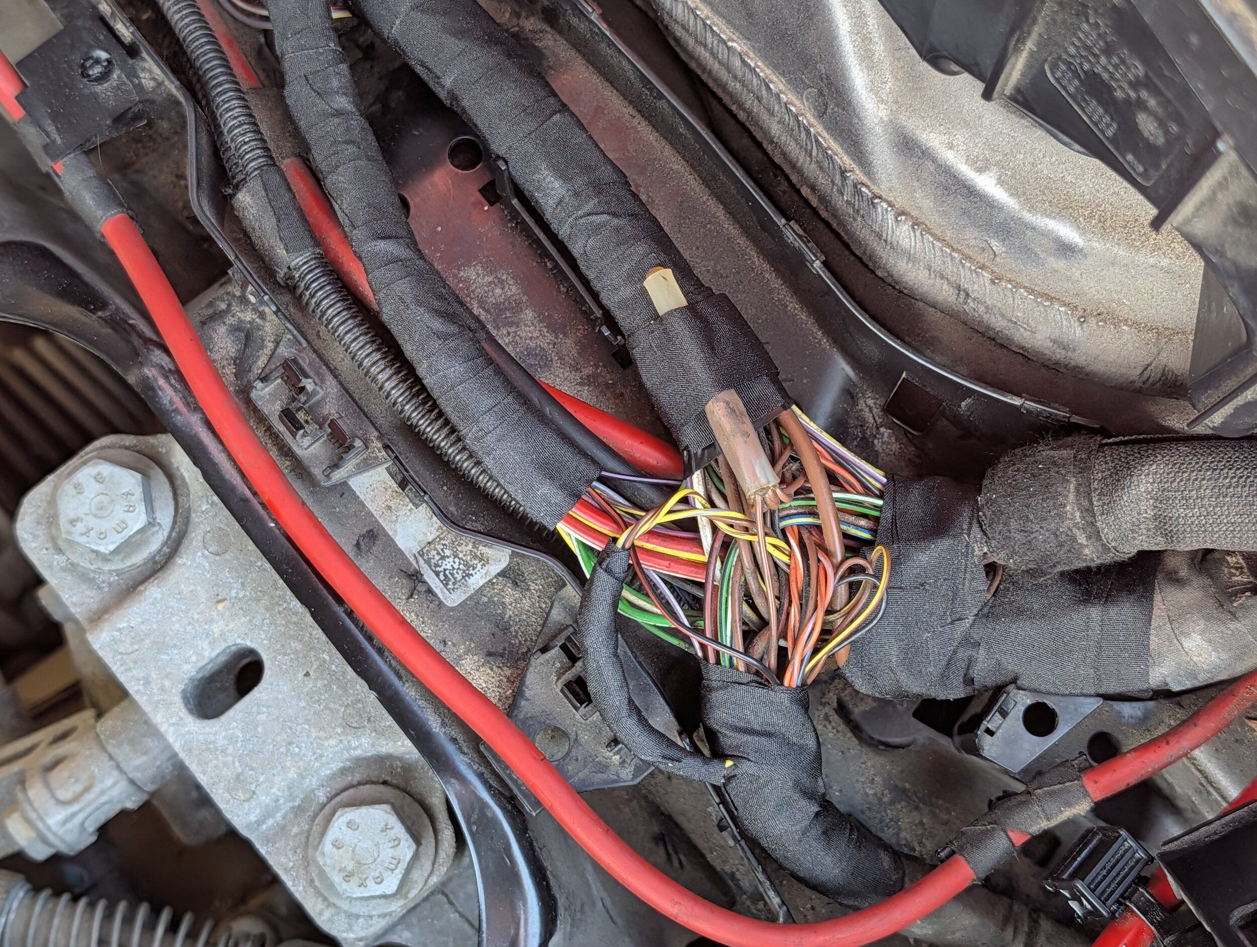

After doing some more research I decided to check the wiring to the ECU under the battery tray.
I don't think it's supposed to look like this and I have a bad feeling that this is the cause of the issue.
Has anyone else seen wiring like this? I could not see any frayed or exposed wire but the damage might be hidden perhaps?
Any help would be greatly appreciated!

Looks like someone has unwrapped the loom to work on it, then not rewrapped it. Very much doubt it's the issue, lights are going to be controled by the body module not the ECU.
Reactions: Ryan1882
Thanks for the reply,
I bought some tesa tape and have tried to clean things up as you can see
It is a little more difficult for the wires showing as they are tangled and I was being real careful

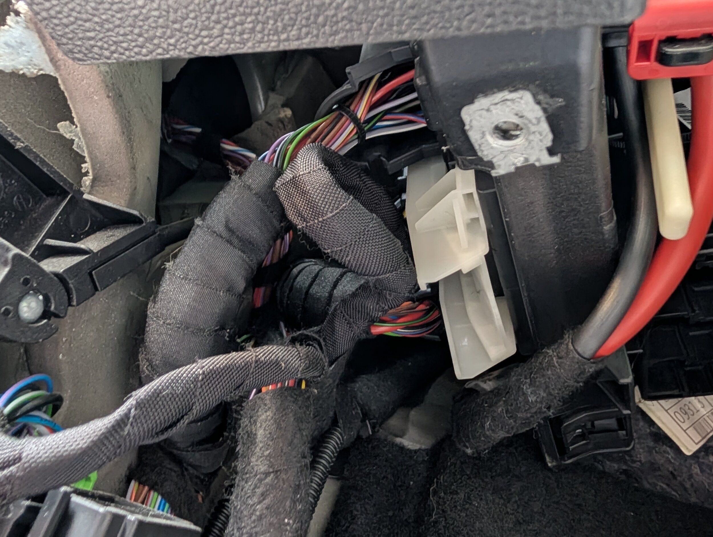

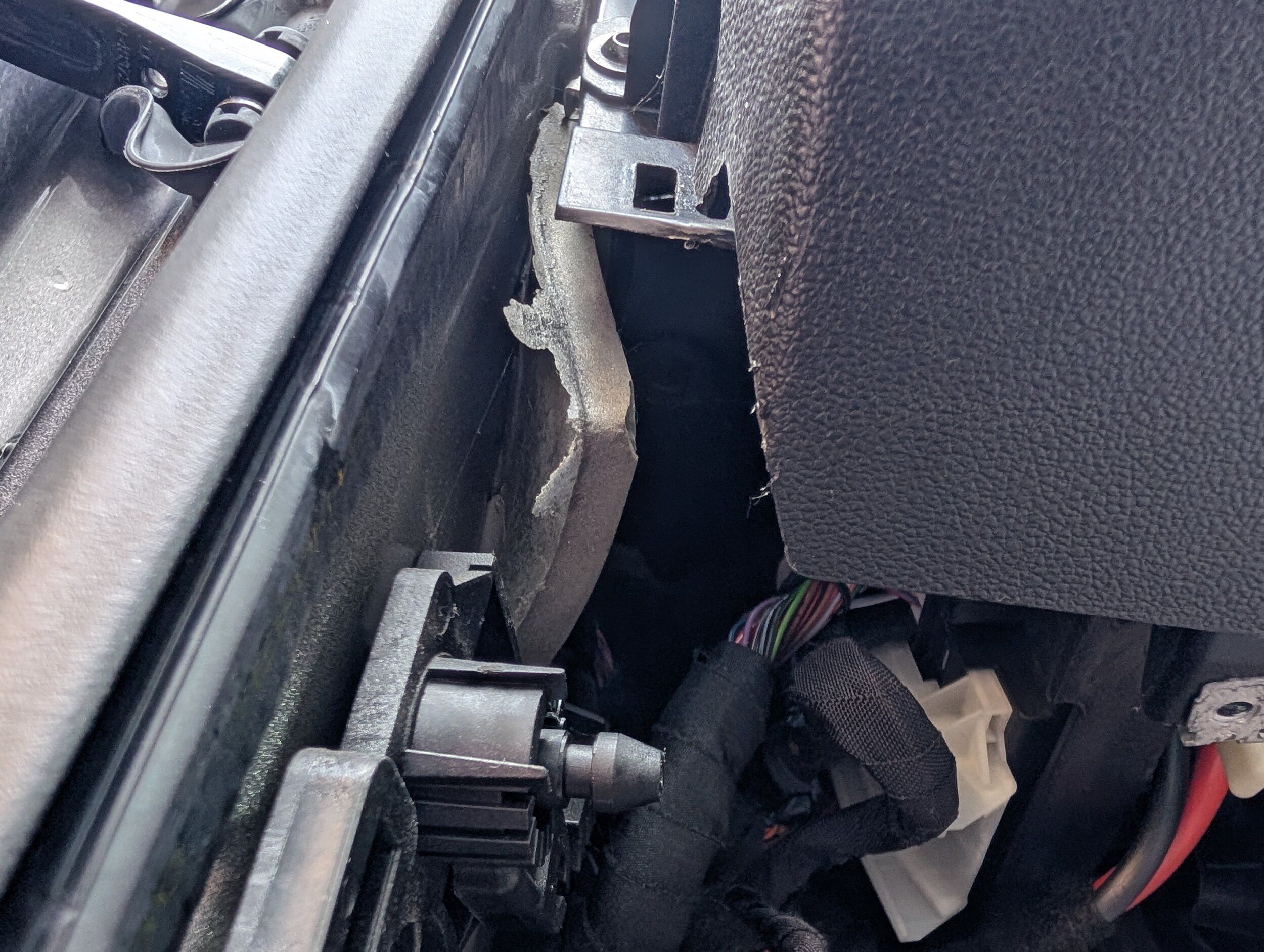

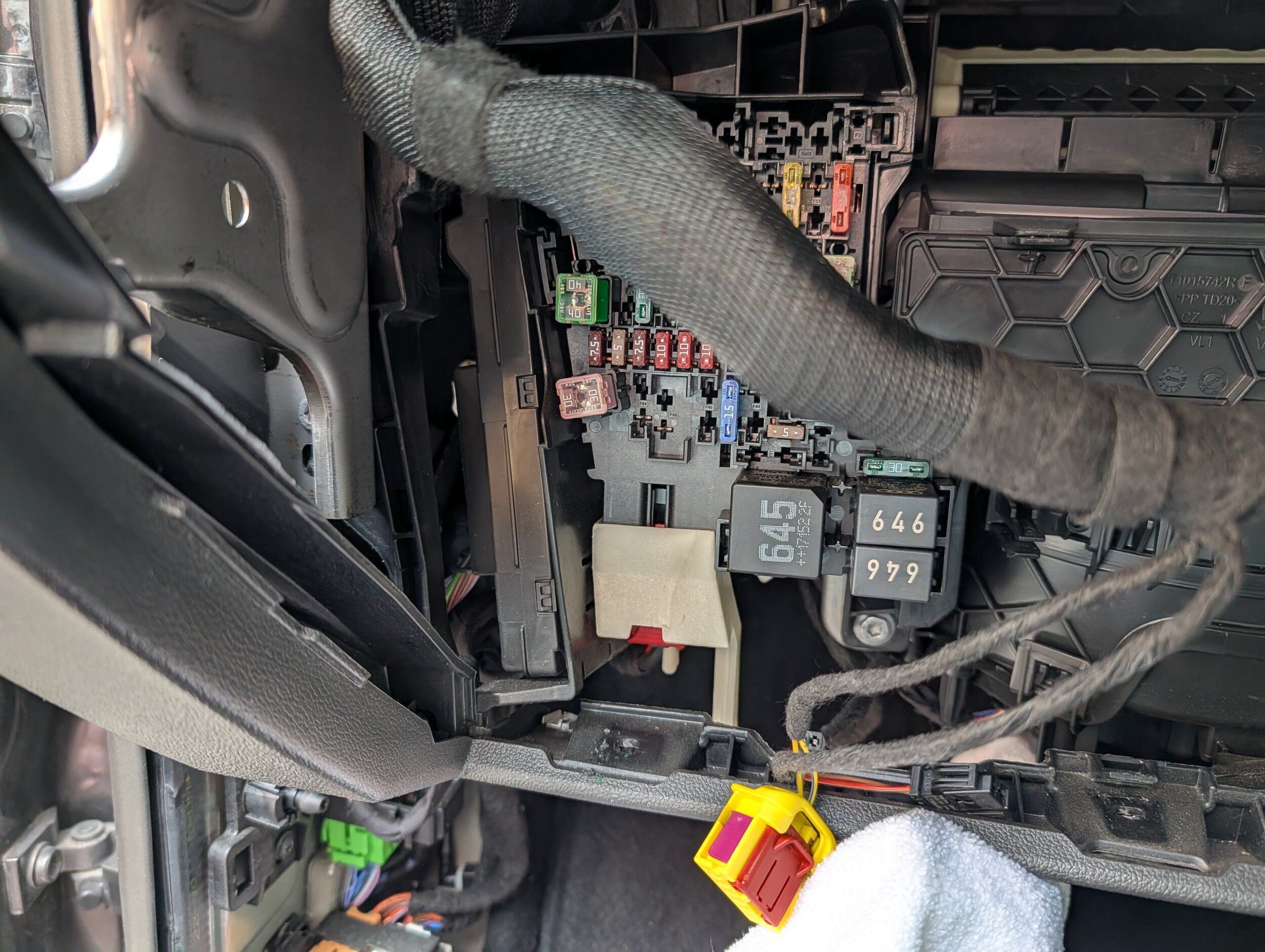

I had the glovebox out to look at the BCM but I had real trouble getting a proper look at it. Not sure what other options I have?

I found it quite difficult to get to after removing the glovebox (see pictures).
Is there anything I can do to make it easier?

No worries mate. I'm not that clued up on the Mk3, i'm a Mk1 guy, but looks like that fault code in your BCM (09 central electronics) may be related. If and when you can get to the BCM, agree with the other guy in that maybe inspect the connector for any corrosion or damage.

I've not had chance to remove the BCM as I've not seen the error for ages. I thought somehow that it had fixed itself but yesterday it come on again. I've noticed this time that along with the daytime lights and sidelights, the indicators and full beam lights are also not working. This sounds the same as the MOT fail when I first got the car.
  • Nearside Front Position lamp not working (4.2.1 (a) (ii))
  • Offside Front Position lamp not working (4.2.1 (a) (ii))
  • Nearside Front Direction indicator not working (4.4.1 (a) (ii))
  • Offside Front Direction indicator not working (4.4.1 (a) (ii))
  • Nearside Headlamp not working on main beam (4.1.1 (a) (ii))
  • Offside Headlamp not working on main beam (4.1.1 (a) (ii))
When this happened I took it to a VW specialist who replaced the positive battery cable and the MOT retest passed with no issues. I know now that this was only temporary as the fault has popped occasionally ever since then.
I'm going to remove the glovebox again to see if I can get to the BCM, is there anything else that is worth checking while I have access to that area?
