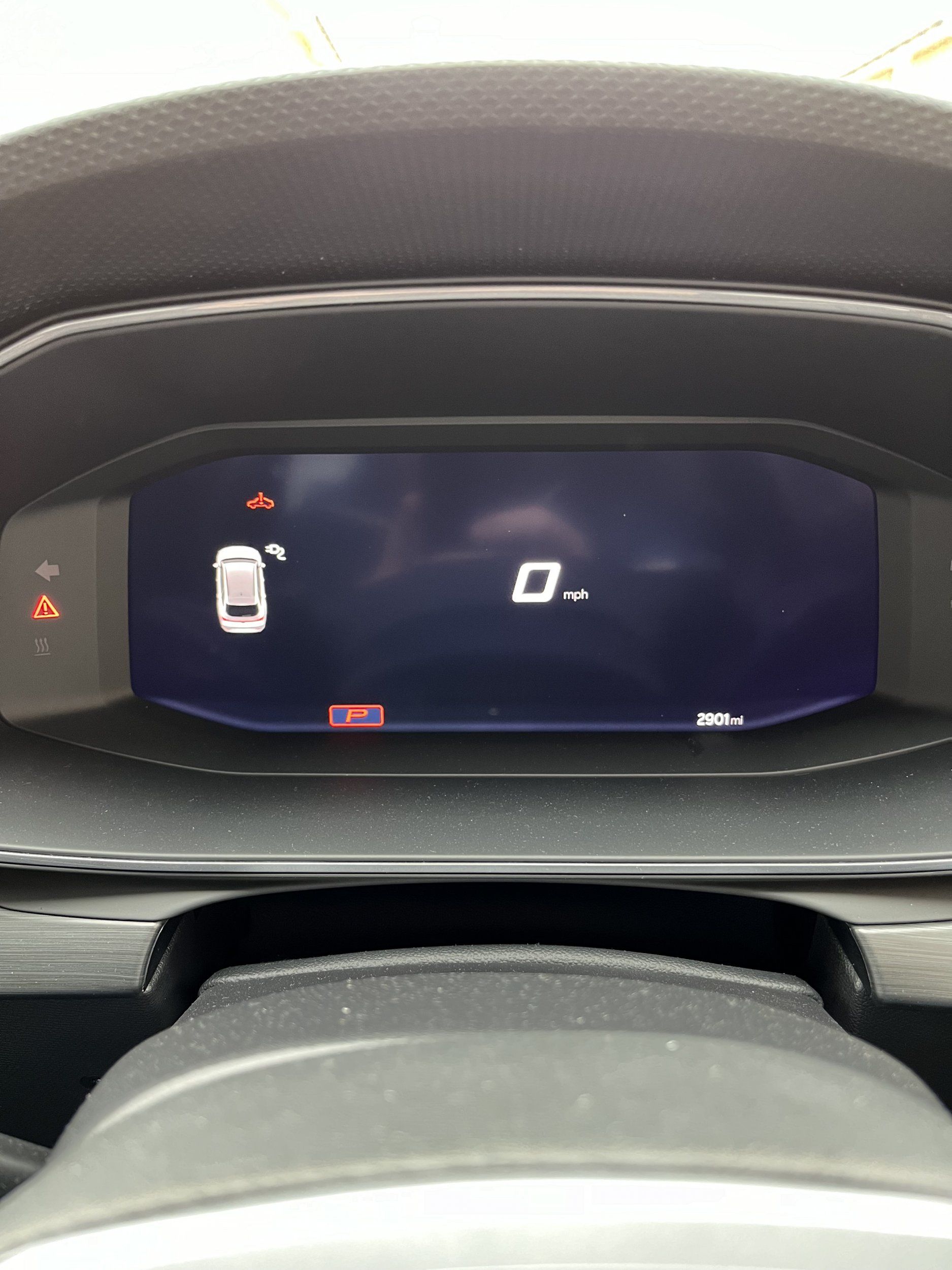

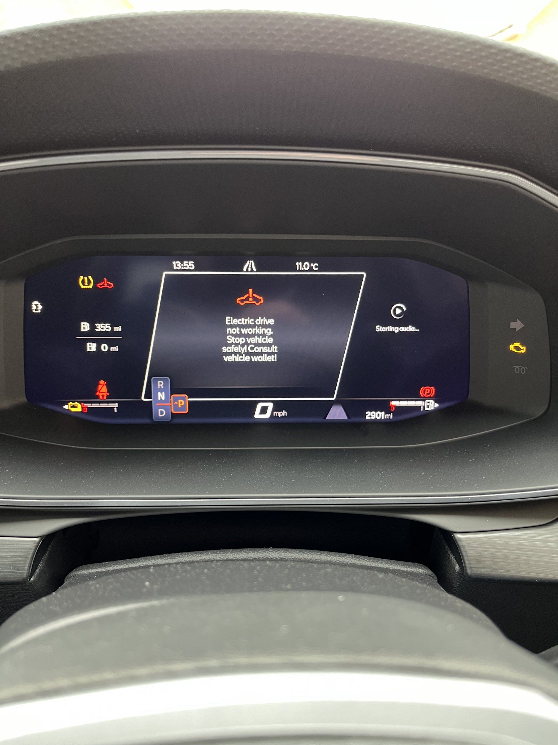

Hi, had this issue yesterday on cupra leon. No problems up to that point (6months old). Went to start car and this message came up. Wouldn’t start and wouldn’t let me charge. Disconnected 12v battery for 15mins, reconnected and warning came straight back on.
Had a roadside VW technician come and got it running within a few minutes! Apparently mine is a software issue where it will only recognise electric power to start the car so when the battery pack is empty (most of the time seen as though you only get 30miles) the car won’t start and eventually runs the 12v battery down.
FIX - to override and get the car to start using the petrol engine you simply press the break pedal and the accelerator to the floor together, then press and hold the stop/start button.
Car starts up straight away but then you need to take the car for a good run or leave running long enough for the 12v to recharge.
Apparently this is a software issue on all the 2024 hybrid models with no update from VW yet.
Hope this helps someone!
