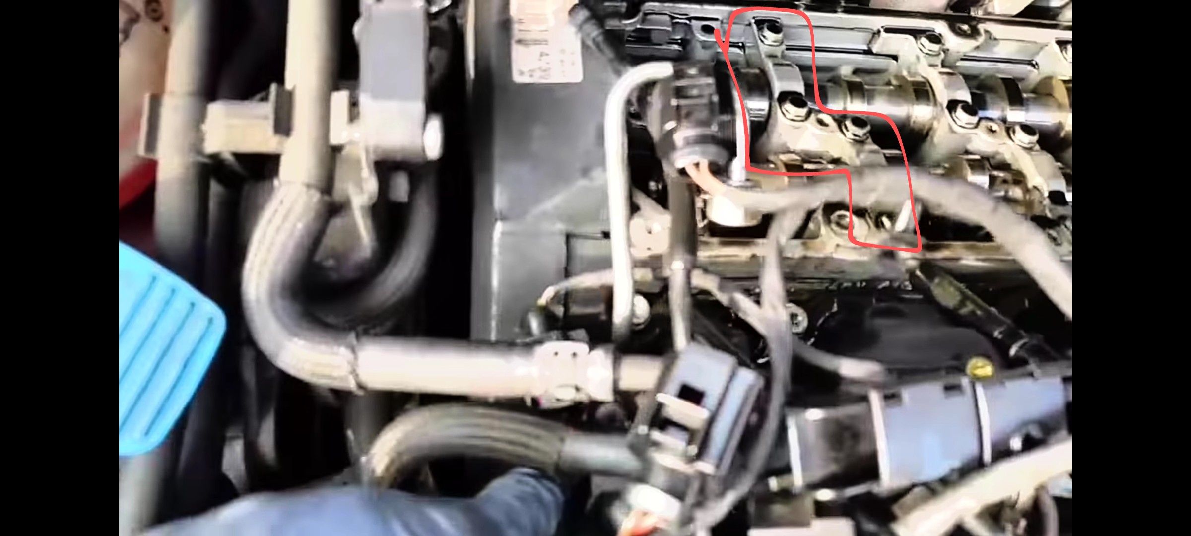

I have a 2010 1.6 TDI Leon
Does anymore know that the part circled is called. Not great on part names. Changed my injectors and the bolt snapped sadly (that one extra turn).if I can't get it out I was wondering if that part could be changed out
thanks stepheb

got a better look at it tonight, don't know what the part is but its all one part

Often referred to as the cam carrier.
They aren't available new on their own and it is not advisable to fit one from a different cylinder head as the camshaft journals are bored with it assembled with the cylinder head meaning they are a matched pair of machined parts.
You'll have to get the remains of that bolt out and then replace it.

Yea seen that room the bolt goes down deeper than the part.
Getting bolt out the next problem

Got the nut out and got my injectors done. Easy enough job on the tdi engine
