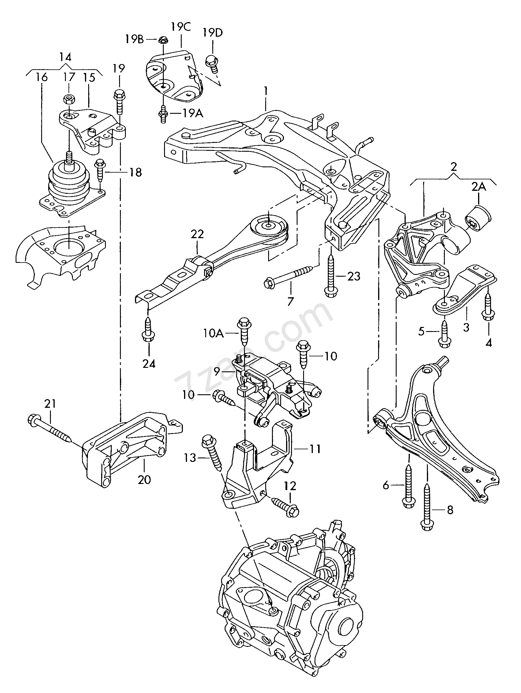

I've attached a photo image from SEAT Etka below, it shows the subframe and engine / gearbox mounts and fixing brackets.
