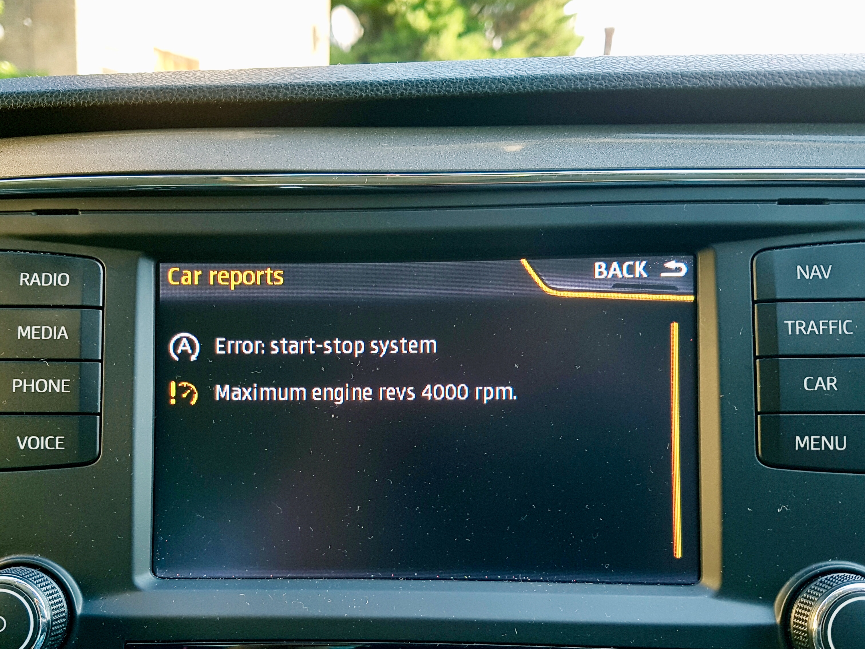

Last Monday just started the engine of my car (1.8 tsi Leon – 2014) activated the orange light of machine management. Directly Ι gone to SEAT dealer, during the journey (house --> Dealer, not over 8 km) I noticed that the car had a high temperature (117oC) while it was always stable at 90oC(winter/summer, I live in Greece). Dealer said me that should replace the Heater Control Valve (4h0121671d) as it happened. Αfter two days I got the car on my hand again because the dealer had no ready-made spare part. I paid 185 euro (work + spare part)… I made few kilometers around 20 km and everything seemed to be good… The next morning, I started the engine and activated the EPC light and appears 2 message “Start/Stop Malfunction, Disabled” and “Do Not Exceed max engine speed of 4000 RPM”. I turned off the engine and started again but this time activated EPC light and the machine management light…. Again my car started to raise temperature above 90 oC. Again to dealer, again the car to VAGCOM..This time the dealer said me that the cooling circuit must be cleaned. It sounds me very strange to was needed cleaned the refrigeration system on a car that is only 4 years old. I believe that the problem is not this
