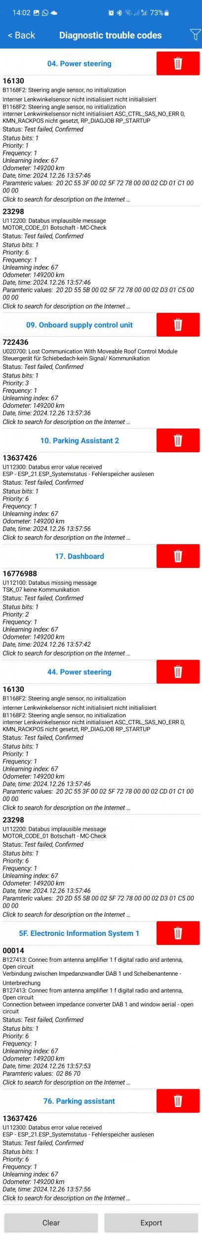

I tried scanning the car & these codes came up (attached)

Firstly, please read it out with something reputable, vcds, obd11 vcp or Odis yourself... if your scan is to be believed, the drive canbus has probably failed. because control units that are connected to the drive canbus are affected. This is managed by the STG 19, called the gateway or diagnostic interface. The immobilizer is stored in the engine control unit, so if you really do replace it, the dealer has to do it, unless you know someone privately with the right tools... I would personally replace the STG 19. Be careful, there is component protection on it, but the vehicle can be started and driven, it's just that all options and comfort features are not working. Of course, you should also have the dealer remove the component protection, have an SVM comparison done and have the functions activated.
