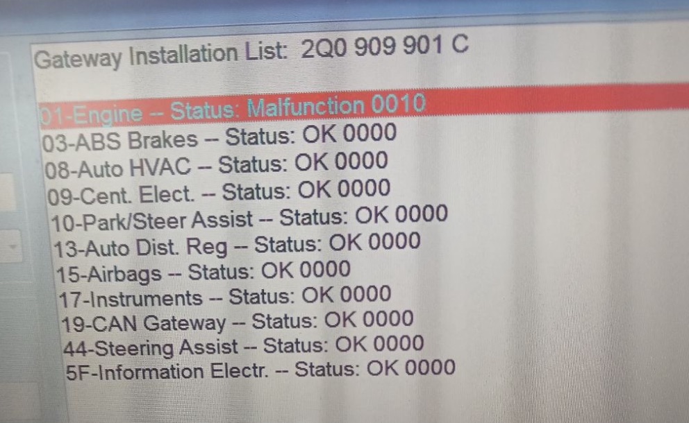

On the computer I saw it said this:
Fault Codes have been erased 1 fault found 37500 - barometric pressure sensor 1 p2227 00 [039] - implasable signal Not confirmed - tested since memory clear
I also have another screenshot that im attaching.
Im just wondering is that actually what it is? Getting a new ECU would be my best bet here? Just want to confirm before I order it, because I assume it might be expensive
