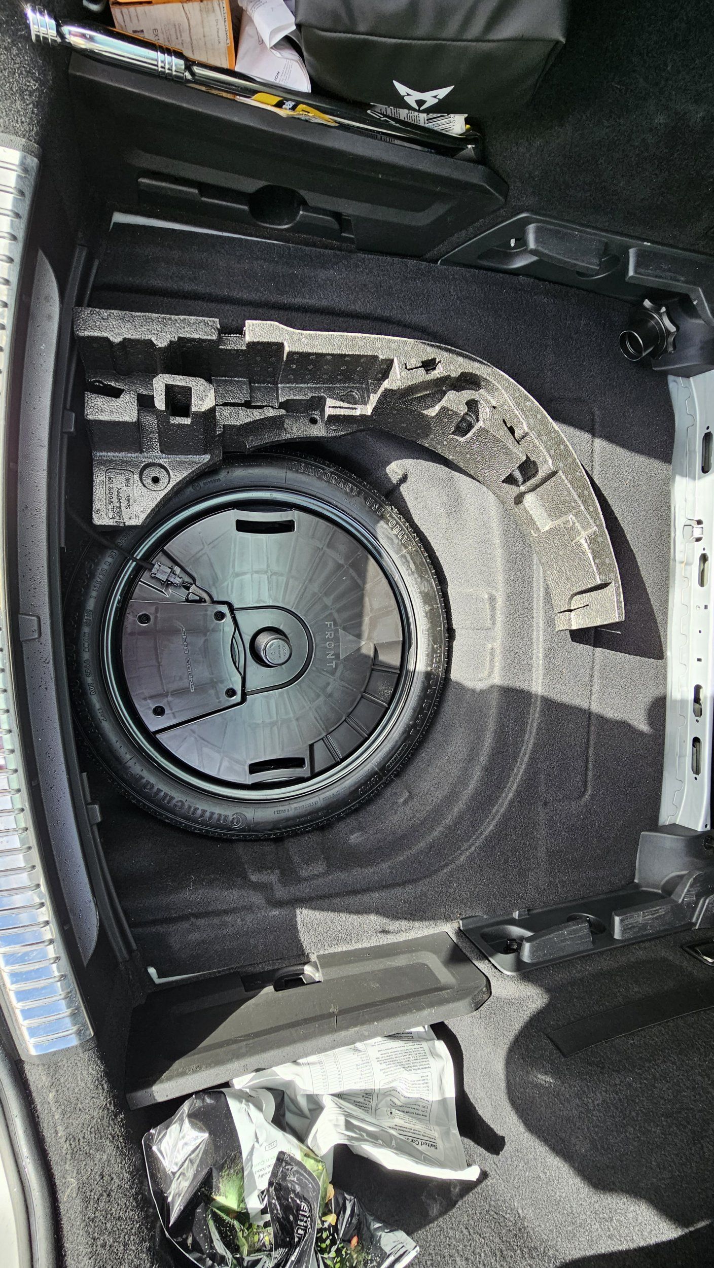

Sorry for posting on an old post but can i just check with you experts that the leon fr estate 2017... with Seat Sound...would accept the foam you are talking about here? I ordered from Listers Seat a foam insert ( they sent) for my tool kit but it clearly doesn't fit.
I'd imagine as described it would go under the spare and the sound system...what do you think?
I'd imagine as described it would go under the spare and the sound system...what do you think? View attachment 38769

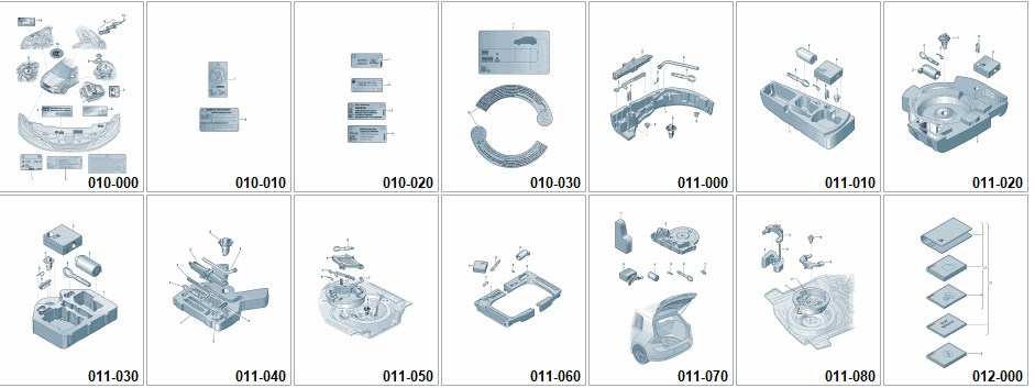

Also they sent me this parts list and asked me what fitted
It's the 011-040 one, you will also need a longer centre bolt. Correct part number for the foam 5F9 012 109 B.
This is the required centre bolt, 1 off 5F0803899 Wheel/subwoofer retaining screw (please note 5F not 5Q).
