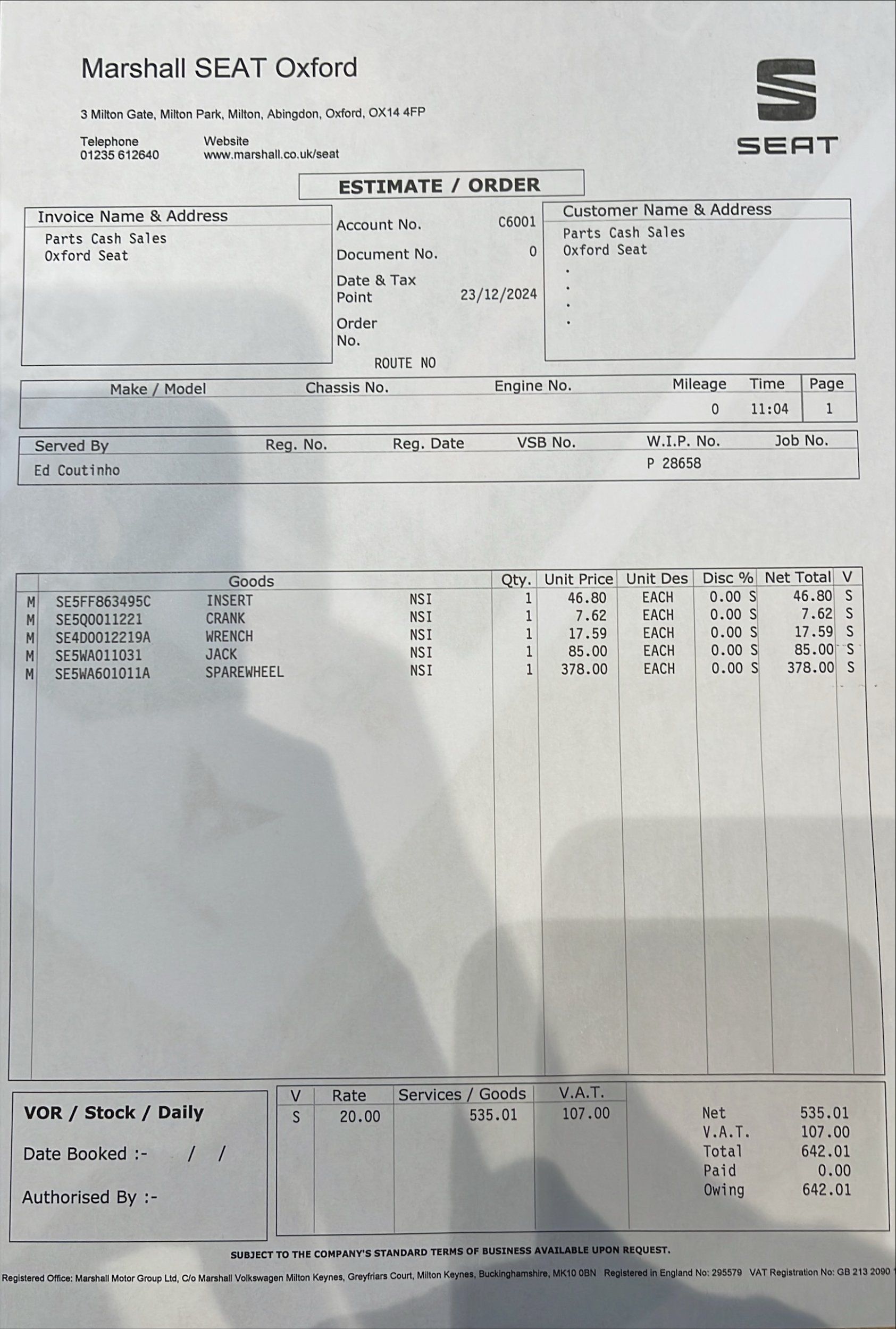

Update, got the part numbers for the spare wheel & accessories and no way I am paying what it being quoted for all the components - thats what Ebay is for!
Some parts I will have to suck up and pay but I have found the spacesaver itself on Ebay for £190 and probably find the jack cheaper too...
Just wanted to ask (if anyone knows) are there equivilent VW/Audi parts I can source instead that are exactly the same products? I know stuff like the polystyrene surround I am gonna have to shell out for as its a new model but the rest of it is surely generic across the VW brand?

I sourced 99% of the part numbers (most if not all are also VW/Audi parts) just waiting to get the car next weekend and I'll then assess whether the boot can take the 18" spacesaver without affecting the boot floor too much, getting the right polystyrene surround is the issue cos there are about 5 difference options (if its possible)
