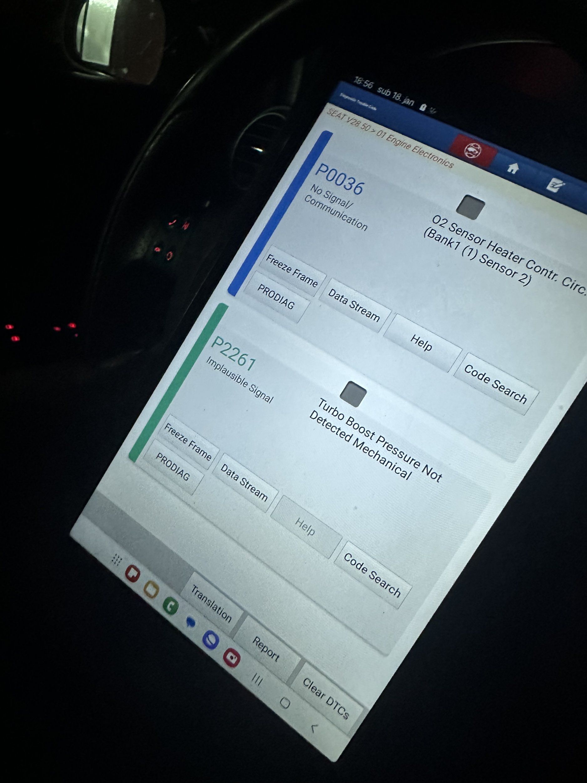

Hello, i have Seat Leon Cupra stage 1 about 300hp… Car have forge intake forge blow off forge oil catch can custom downpipe. Turbo is working good. So car have a problem with fault P2261, sometimes when its everthing okay with car i have normal boost and whistle of blow off but when in a moment car lose boost and whistle when push the throttle like doesent have a power. Can someone tell me what can be this problem?

Usually replace the leaking hose. Bottom intercooler pipes are common. Usually it's the connection on the pipe that wears out, it's those quick-fit connectors that are rubbish.
Replace with new and you're all good.
