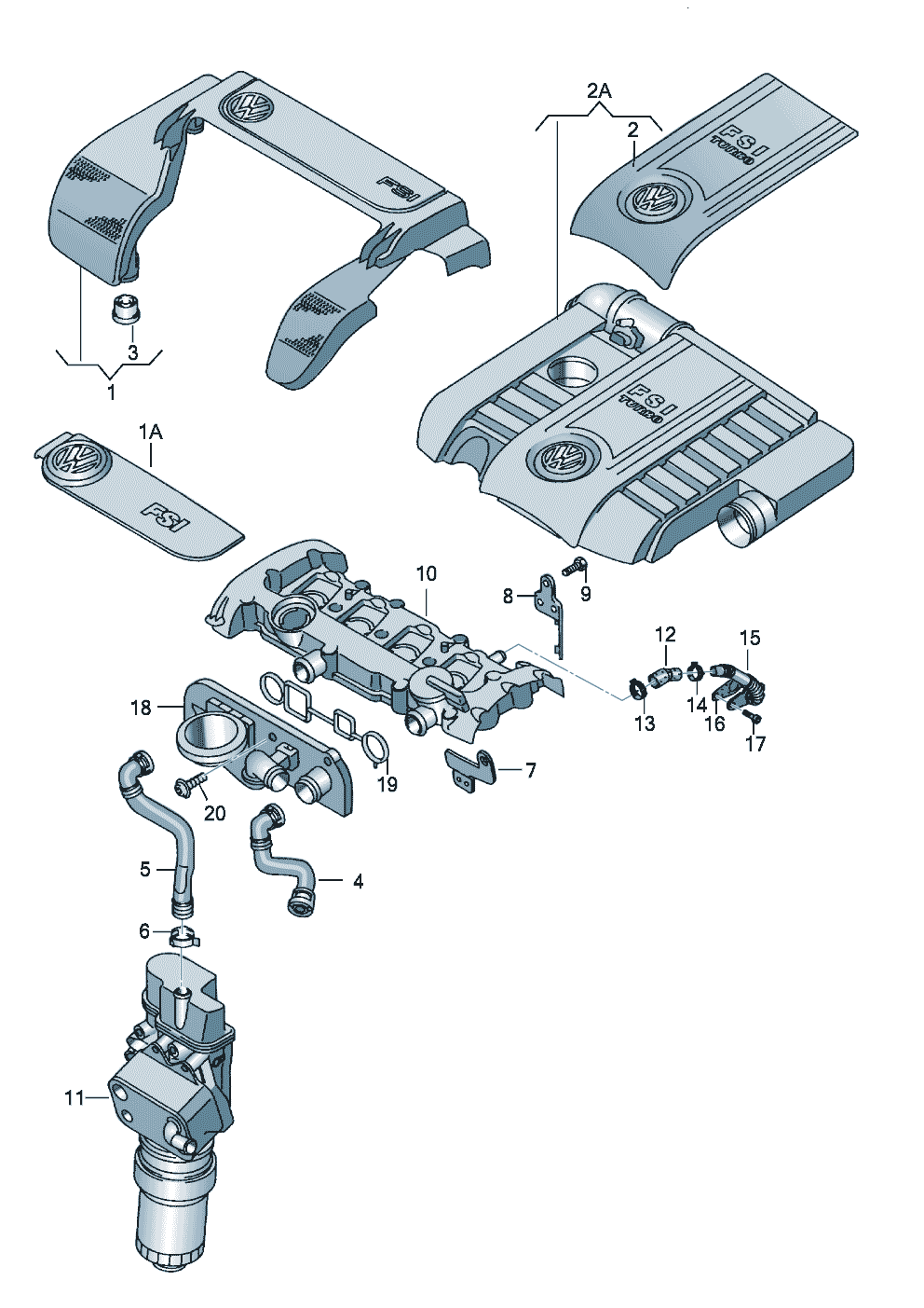

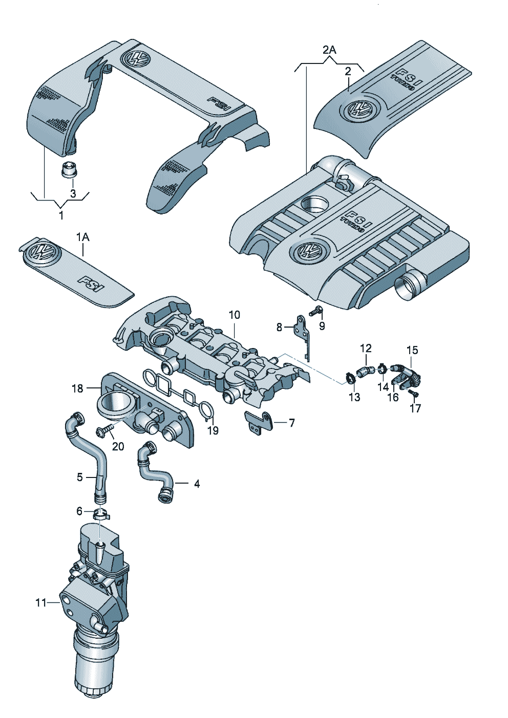

Hi mate. To me all the symptoms and fault codes point towards an Air leak, it's just a case of finding it. The leak could either be in the EVAP pipes or in the Crankcase ventilation system (PCV). You often find when it's in the PCV system it confuses the ECU into thinking it's an EVAP problem and you get misleading codes.
I would get a flashlight and check every evap and pcv pipe and connection you can find. Get a small inspection mirror from ebay/amazon so help you look at the underneath of all the pipes. Check the pipes leading from the EVAP to the throttle body, and all the PCV pipes around the cylinder head area, giving them a gentle squeeze and checking for any oily/ greasy patches on adjacent pipes which can be a clue as to leaks somewhere near. Not overly familiar with the MK2 but i'd check pipes 4, 5 and item 18 for any cracks and obvious leaks. Maybe consider replacing item 18 with a cheap one from ebay as the valve may have failed internally also.
