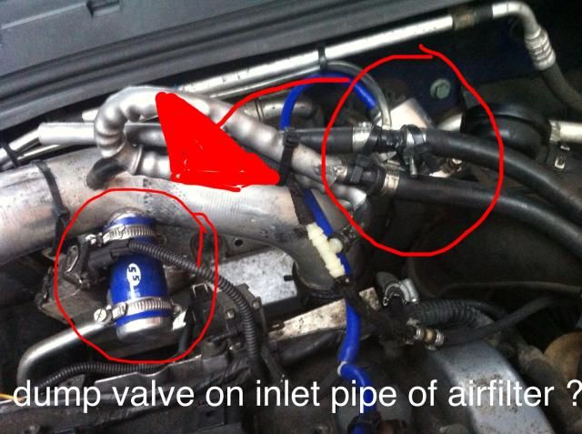

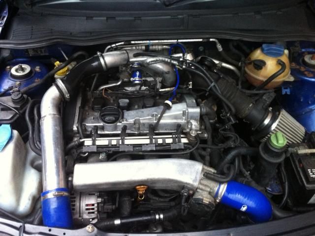

Ok I've not tried that yet I will I know I unplugged it at idle last week and the engine eml light came on and the engine sort of missed slightly . I've attached some pictures of where the dump valve is located because for some reason I also have no negitive vacuum ???

I also moved the dump valve to the hard pipe and it constantly blows open when I floored it it would dump while I had my foot down so I've taken it off and have done away with it for the time being.
When you let go throttle, throttle body closes but there is still boost left, so it goes back into turbo and hits turbo blades and can damage turbo over time...thats why there is a blow off, to vent that boost out
It causes the compressor to stall I believe that's what the flutter noise is causing damage to the bearings
