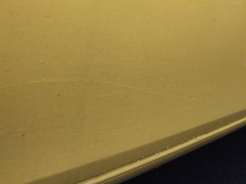

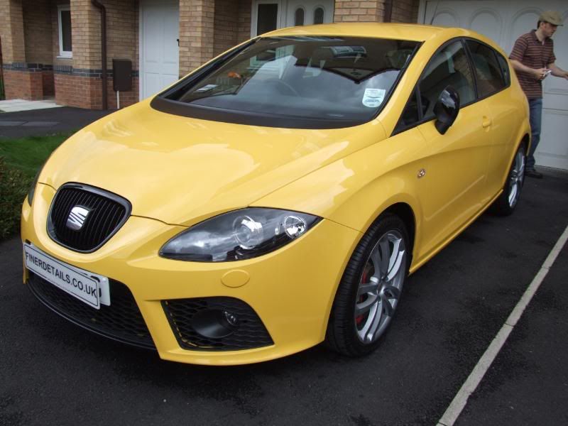

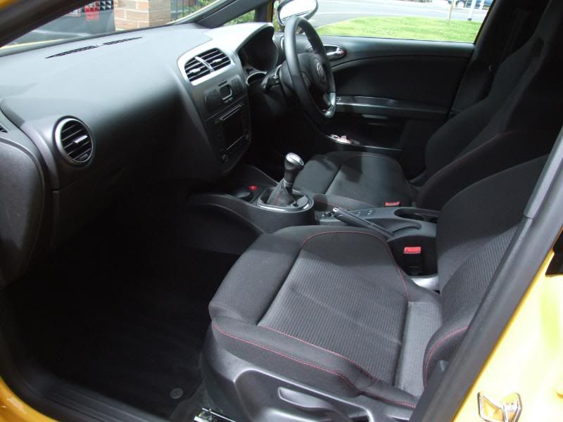

Some before on the Cupra:

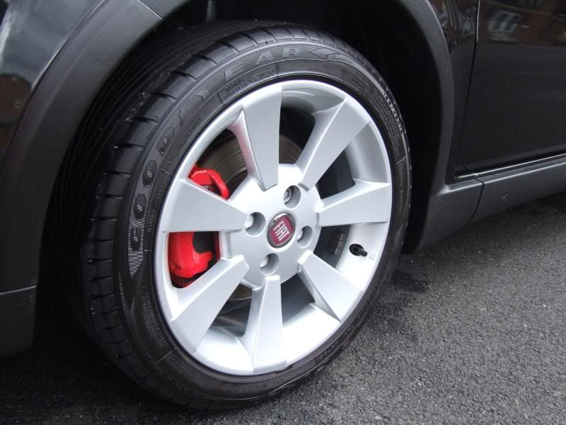

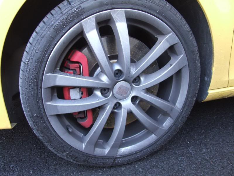

Wheels washed first, then the paintwork:

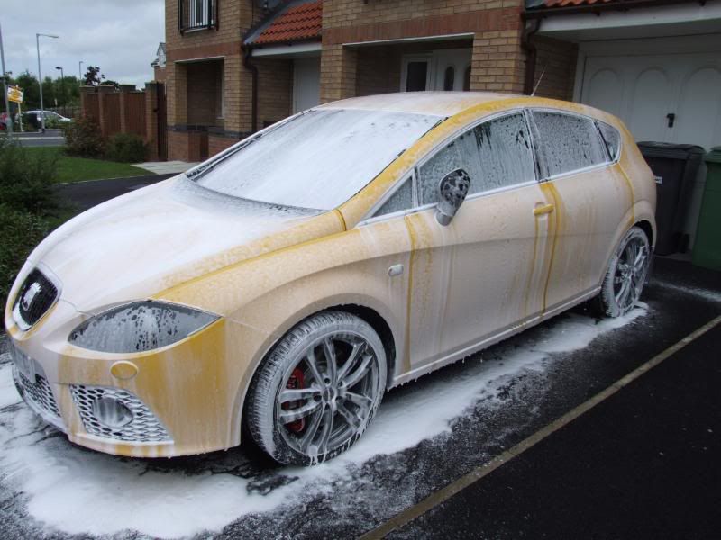

The custard- its coming off and its really white underneath :D

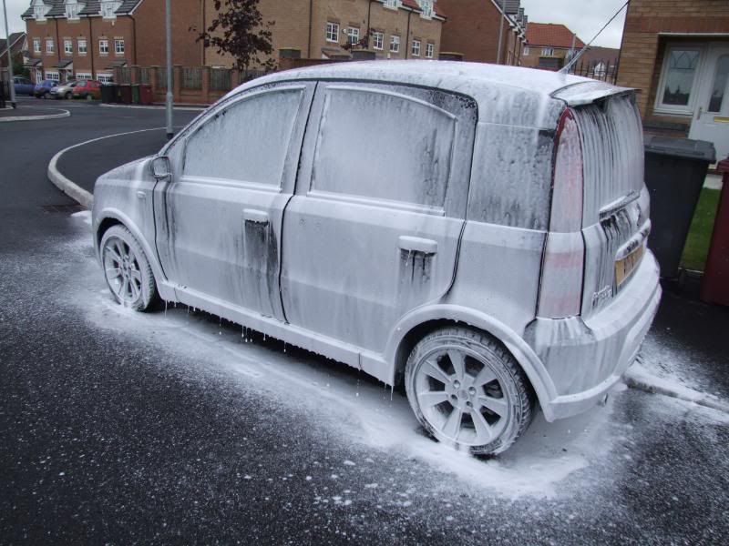

didnt need quite as much foam for this one:

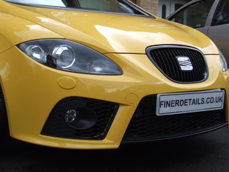

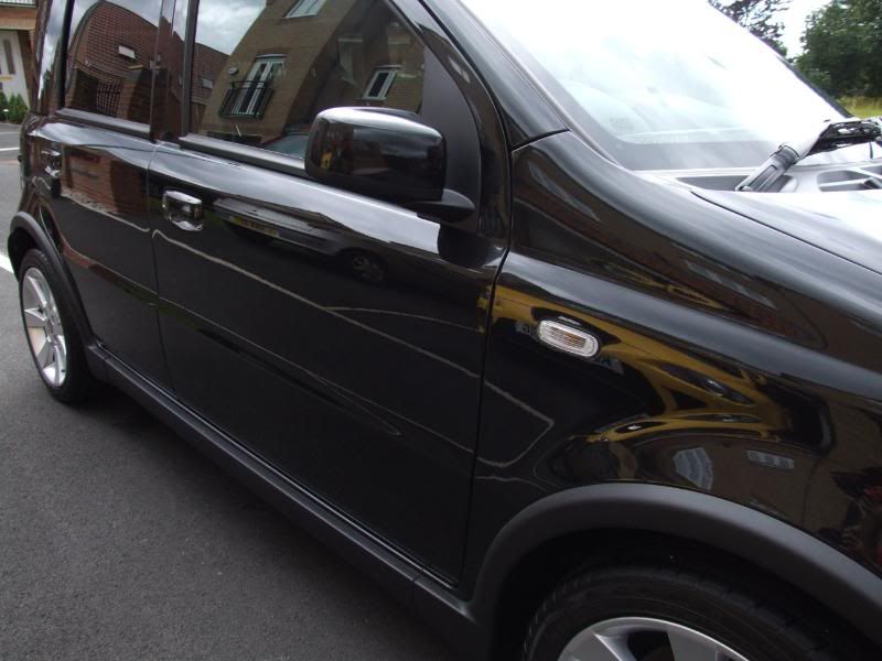

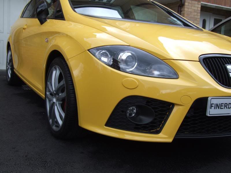

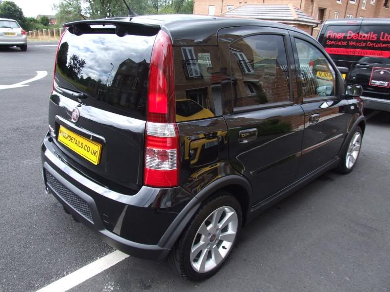

After this both cars were clayed with Pinnacle Ultra fine, then Tardis tar remover - more so on the cupra, had a fair bit of tar on it. Then rinsed and dried. I then used Duraseal cleaner sealant - enabling me to clean and seal each car in one go. And as the sealant would need some curing time, I could apply to one car, move to the next and not waste time. How efficient and effective!

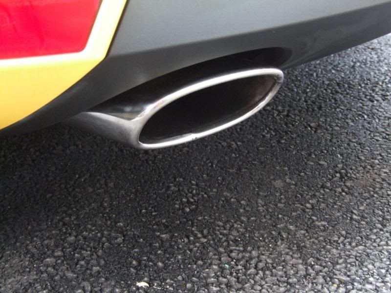

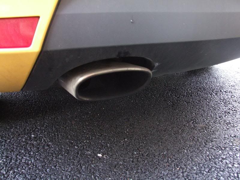

Whilst more sealant curing was going on I waxed the alloys on both cars, dressed arches, cleaned glass and the exhaust pipes. Then off with the sealant, and out with the Wolfgang Fuzion wax. Applied to bonnet and roof of each car and then removed. Weather was looking very dodgy now, so wanted to get the flat surfaces finished so i wouldnt have touch them again if it did rain. I then continued, and waxed all vertical surfaces on both cars. Tyres dressed, and a check round and wipe where needed. Both cars then vacuumed inside - the Panda had a bad water stain on the passenger seat, so that got wet n dried too.

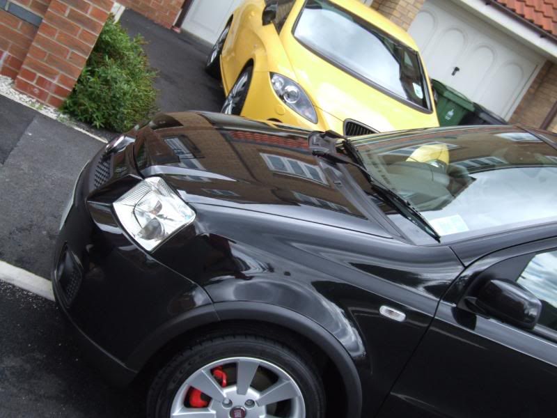

some arty ones:
