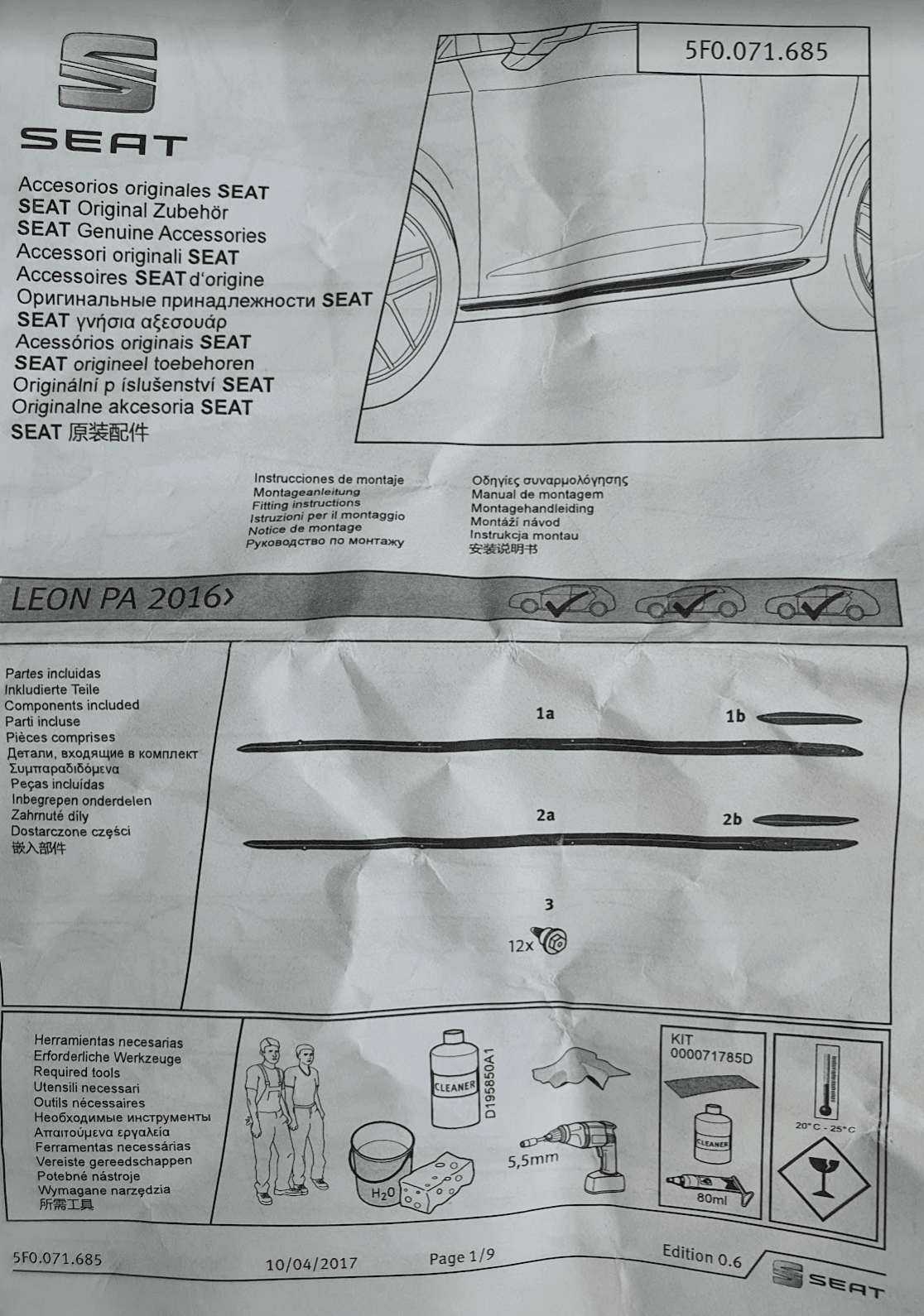

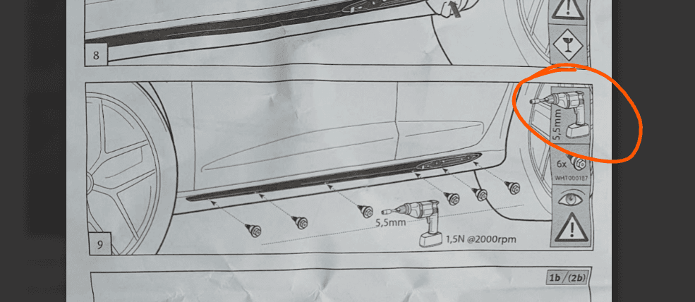

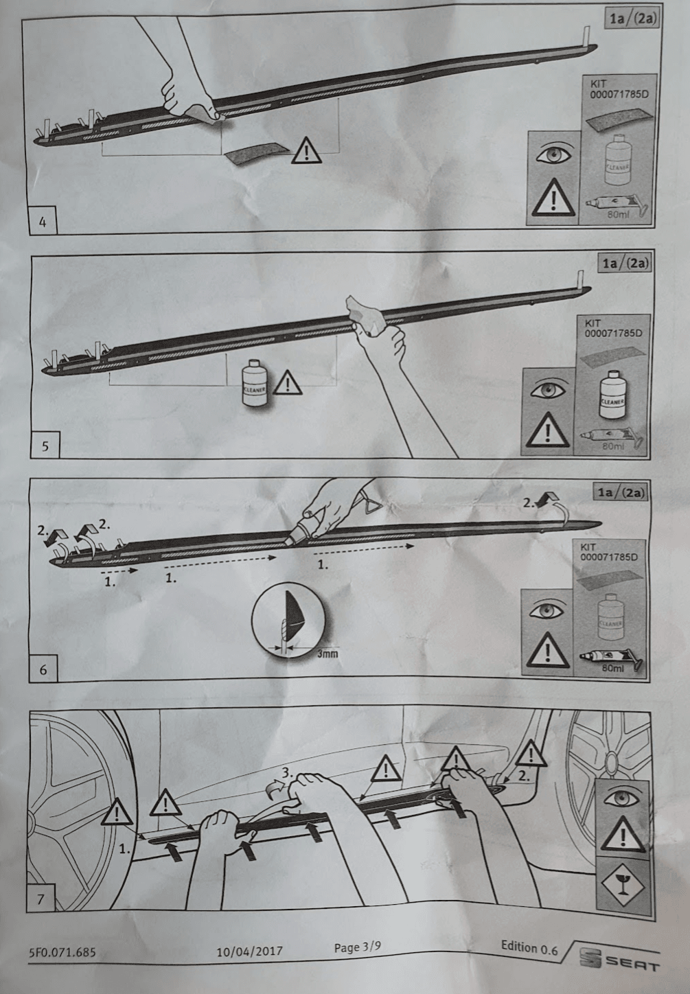

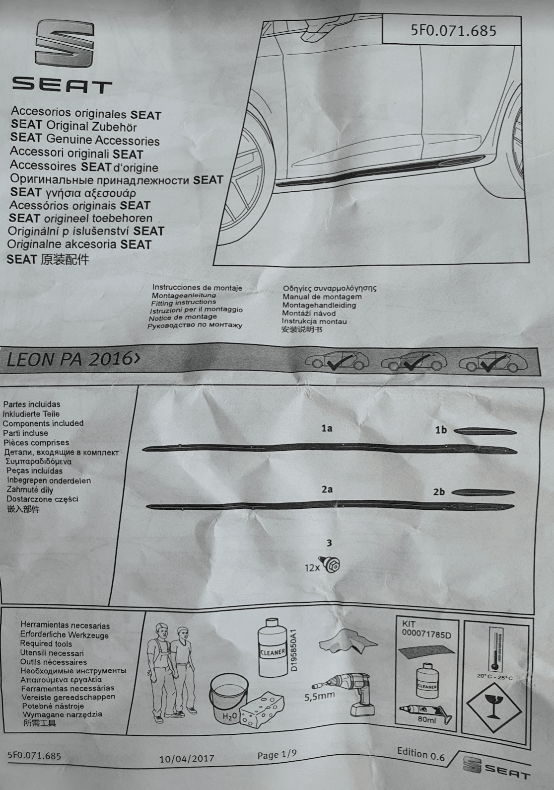

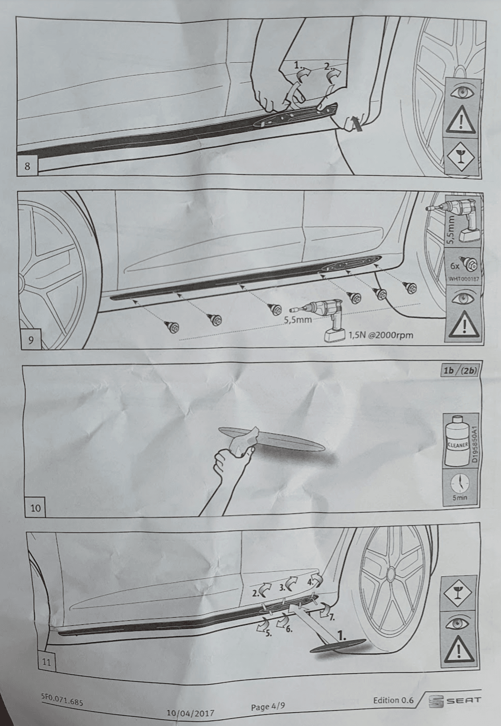

Was thinking to give it a go myself. The instructions are as follows:
It looks like I need to use a separate glue, the self-adhesive strips as well as screws.

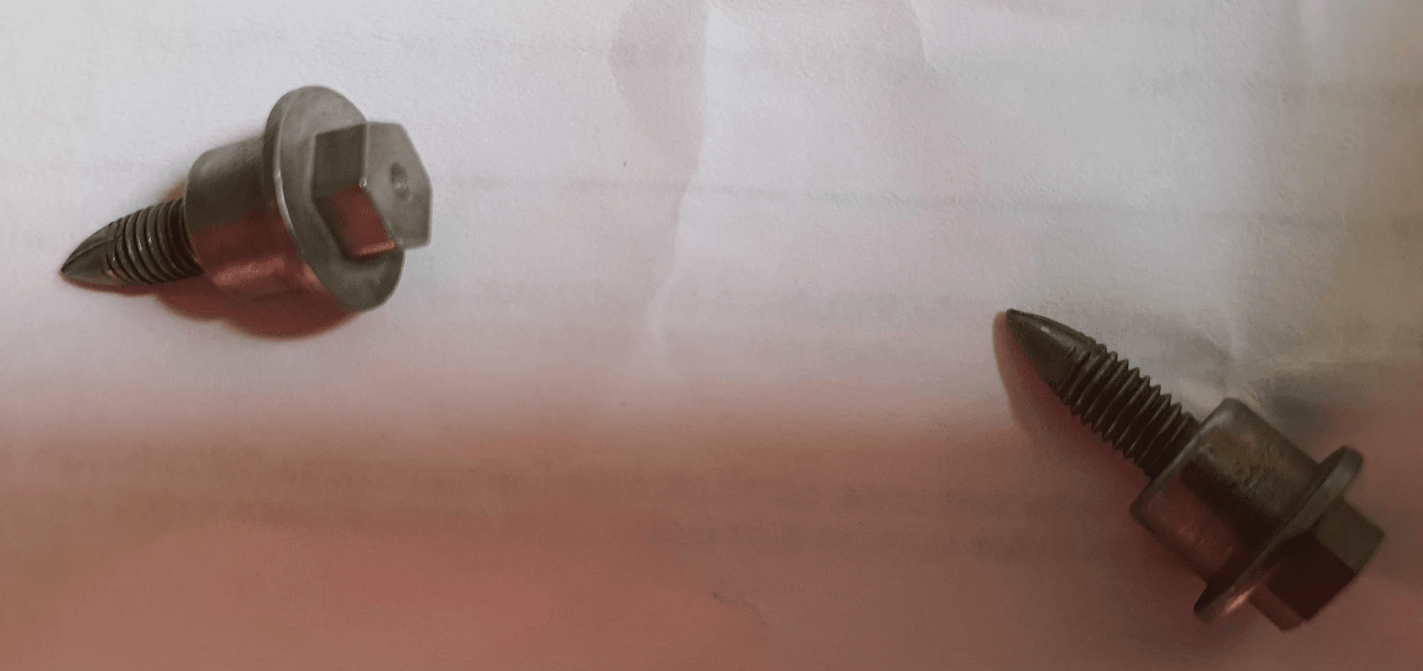

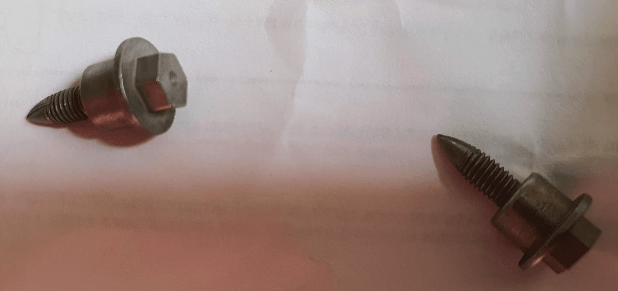

Am a little wary of drilling into the sills of the car but as it's a genuine SEAT part, I guess it's okay! The screws themselves look like this:
Not sure but they might be self-tapping screws, meaning I don't need to separately drill any holes(?) The instructions don't mention it but I would assume with holes in the bodywork, they should be primed and painted to prevent rust.
Has anyone here fitted these. Would appreciate some advice so that I don't screw it up! Thanks in advance :)

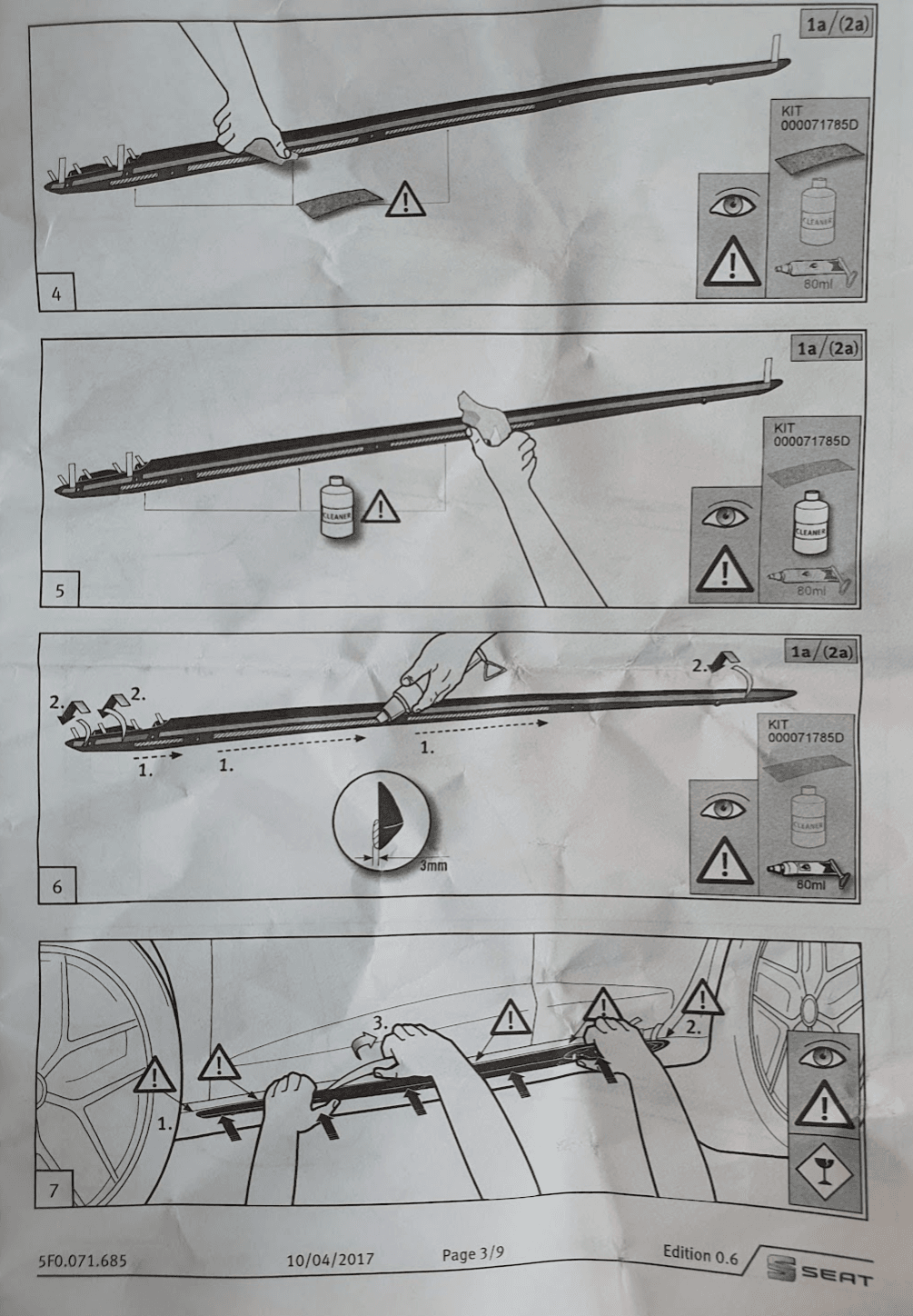

View attachment 33337 View attachment 33338 View attachment 33339

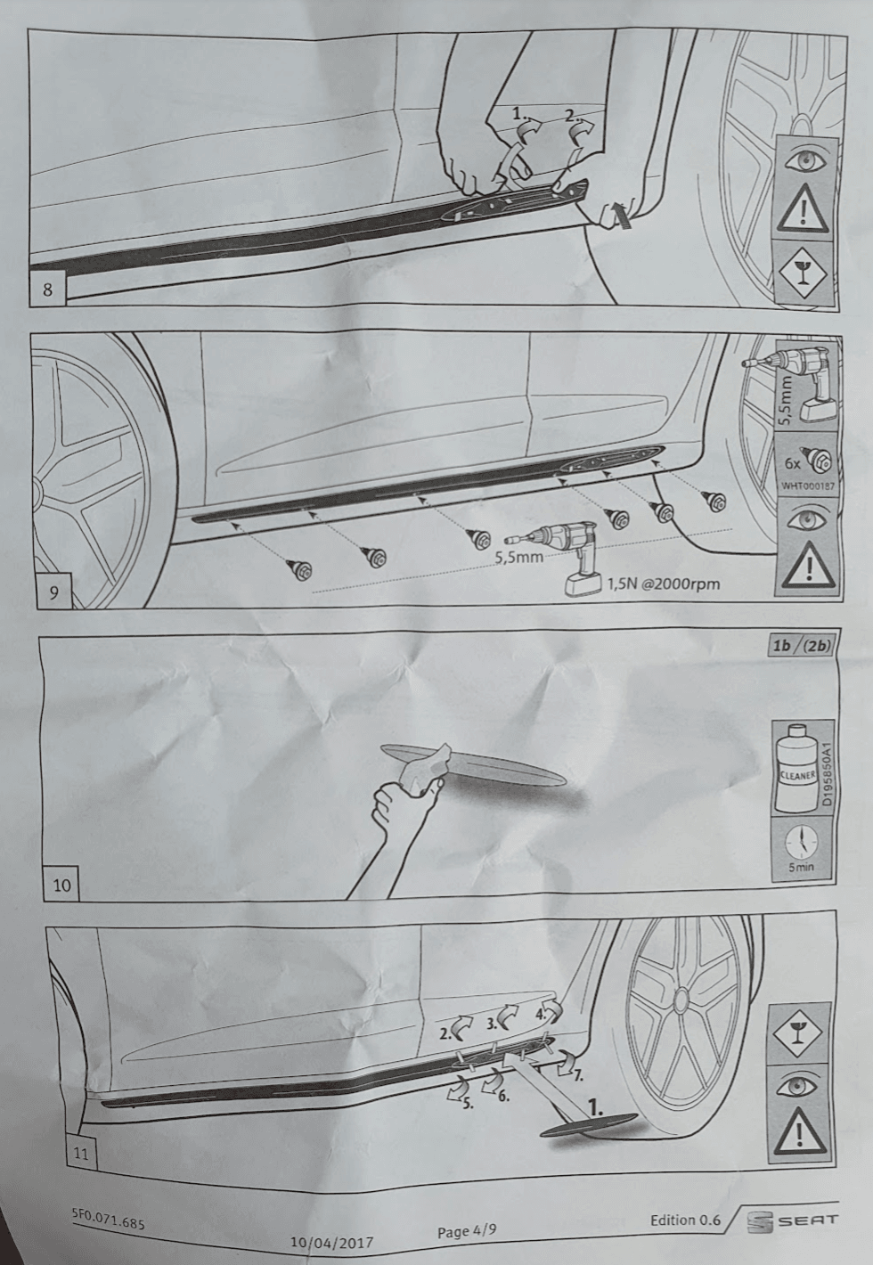

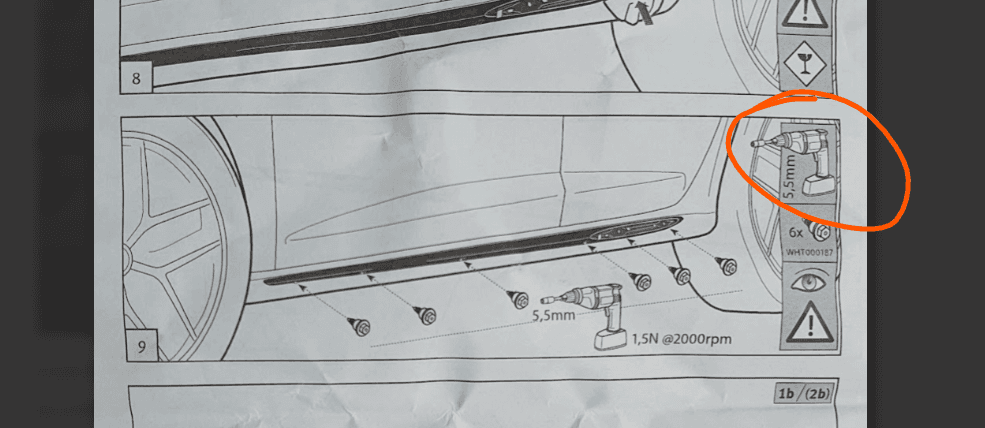

I've not fitted them as they came on my car from factory (Carbon Edition came with them, and in Europe the performance pack came with them).
However, I would believe this symbol is telling you to drill a 5.5mm hole...
Although looking at it again now, below the actual image it does have some rather ambiguous info around torque. and rpm.
Unless it means you can get a drill at 1.5N @2000rpm1?
Looking at the photo, the drill looks like its got a socket attachment on it and not a drill bit, so perhaps they are self tapping.
I wouldn’t be brave enough to drill holes in the sills of my car.
I looked into these before and they only list them for FL Leons, but I have seen someone with them on their PFL Leon. Sill wise, Cannot see what the difference would be.
I'd agree with @JCB360, the 5.5mm is the socket size needed to drill the self-tapper in. DON'T drill a 5.5mm hole!!!
Reactions: JCB360
Thanks guys! Agree with @JCB360 & @SteveGSXR600K1, it has to be referring to the head size and not the hole itself, will most certainly NOT be drilling a hole that big! @SRGTD am pretty nervous myself!
Will look through my socket attachments to see which one fits. @Damo H, have looked into the rpm / torque info re. power tools and I think it means that it needs to be on a slow setting, cordless drills apparently rotate at 2000rpm.
I reckon I'll try one to see how easy it is. If it doesn't go in easily, I might just get a pro to do it.....as this part does come on the Cupra R and the Carbon Edition, maybe dealers would know the answer to these Qs? Re. FL vs Pre-FL, there's no way that a facelift would modify the basic structure of the car, it's only new bumpers and lights in most cases....so doubt there is any difference between the two as far as this part is concerned.
Reactions: JCB360
Yeah agree it looks like a socket on the drill, and that was my initial thoughts, but a 5.5mm socket seemed very odd to me, That and the picture of the screws look a lot bigger than 5mm hex end, but then there isn't anything to show real scale.
A quick google seems to suggest 5.5mm sockets and self drilling screws are about, although for roofing lol

They are not self tappers or self drilling screws those. You will need a pilot hole.
However if you tiger seal those sideskirts on there is zero chance they will fall off. I have tigersealed full size skirts on before and they would not budge
Thanks @BigJase88 - wow, is it that tough? Will deffo get a tube. I think I'll still try one hole to see how easy it is. If it turns out to be super easy / barely an inconvenience, then I might put in the screws. Will update this thread once I've given it a shot. First step is to get them painted!
Yeah it is polyeurethane bond. I have heard people have accidents and the sideskirts are the only part still on the car ?
The sideskirts i got for my audi a3 thats what audi stick them on with obviously their own varient at big bucks per tube.
It won't come off so make sure you get them in the right place ?
Lol! How long does it take to set? Is it literally instant or are there a few seconds to tweak / adjust? I'm notoriously bad for getting super glue on my fingers, will need to be extra careful! :eek:
24hrs to fully cure.
I just stuck some masking tape on to hold it.
It does have some initial grab but enough play to position it where you like

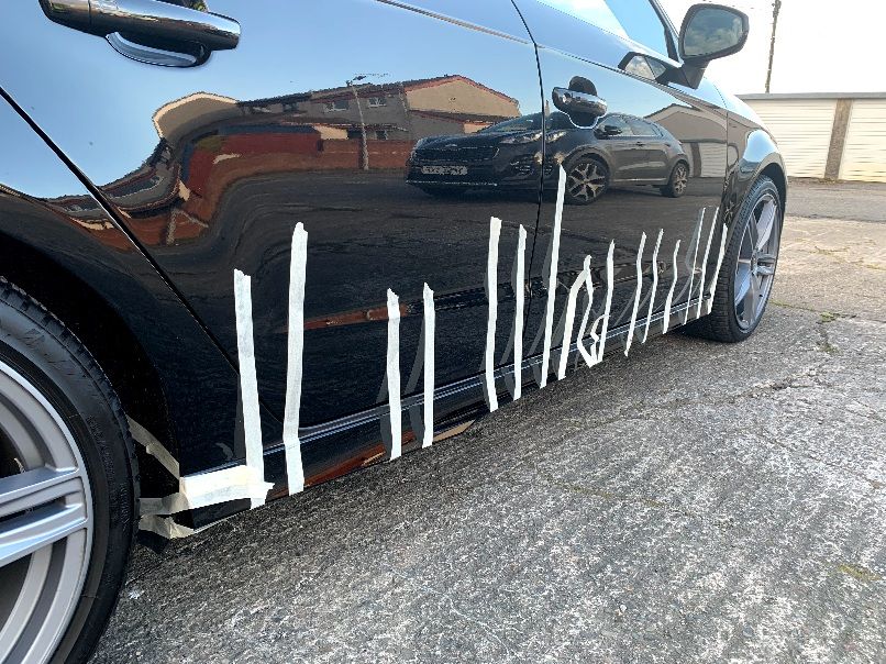

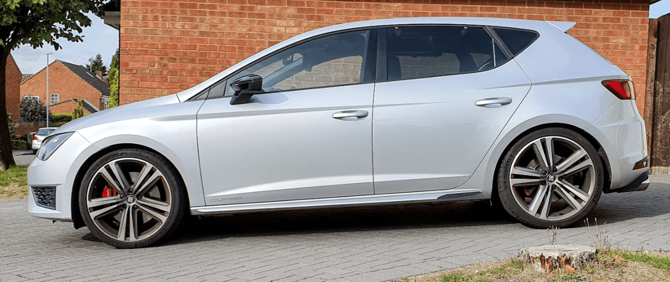

So finally got the side blades on this weekend. A local guy painted them both for £80 which was good value and I fitted them myself using a combination of Tiger Seal and the supplied screws. Was a bit nervous screwing holes in the car but as it's an official SEAT part, I decided to go for it.
Quite happy with the finished look:
Thanks again for the advice!

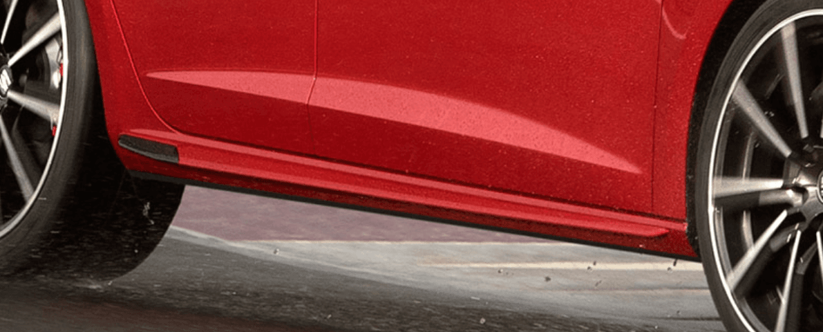

Im sure i read on this forum that the Audi aero sills will fit the ST ??
These are about £150 for the A4.
Thoughts - a worthwhile alternative or not to bother??
