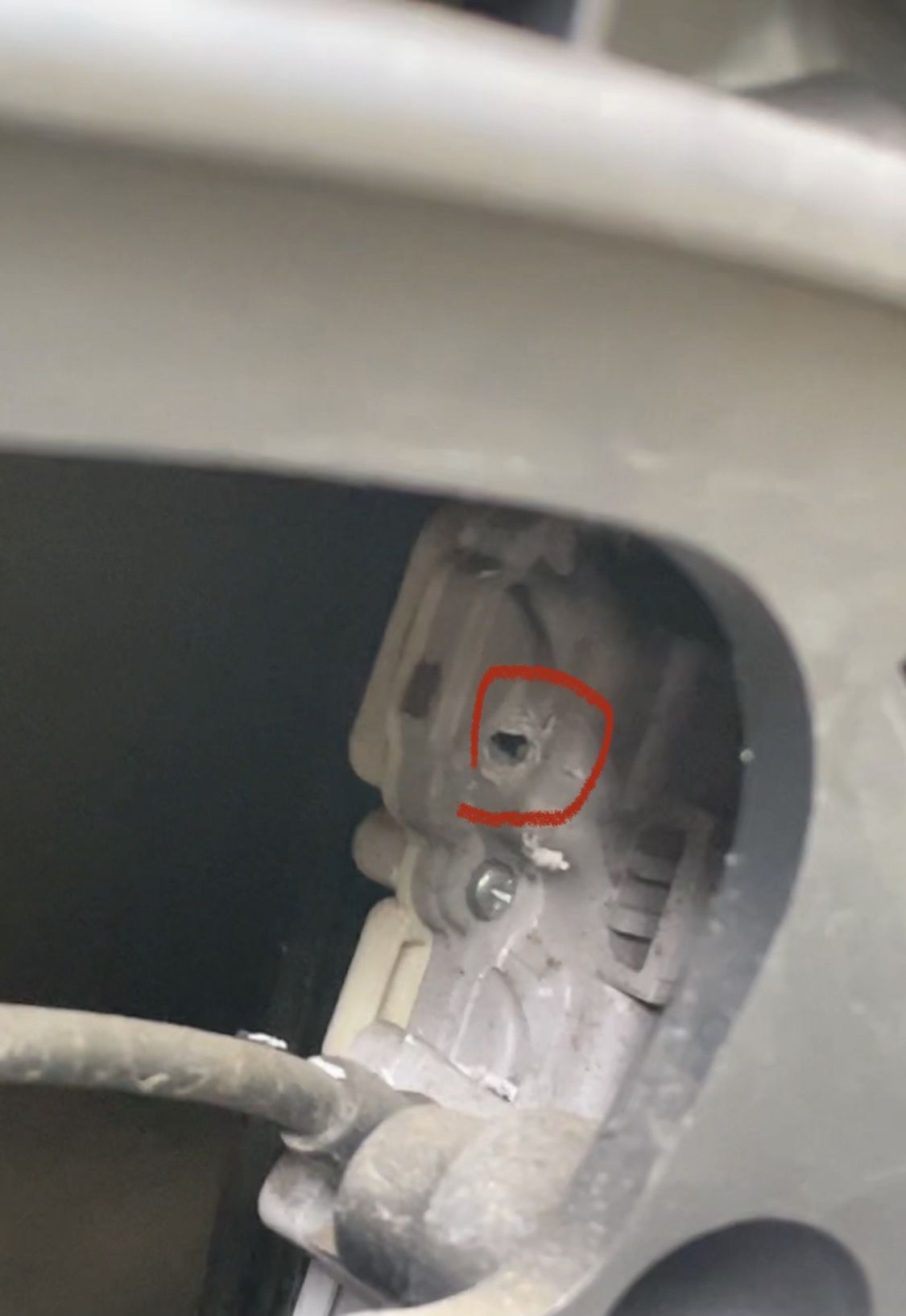

U need: 3mm drill bit, wd40, pry tool.
Open the little cloth panel carefully, and leave it hanging, no need to open the connector or handle cable, then drill hole into the module about 1cm is enough, then spray wd40 inside the hole. Put back the cloth little panel. Open and lock door a few times and it should work. Thanks
