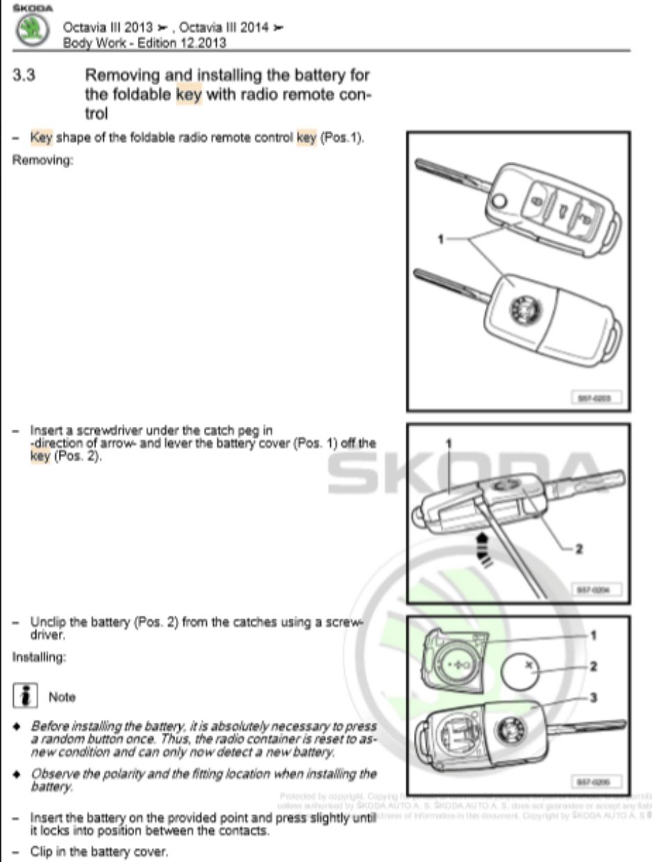

If you look at the other VAG MQB platform marques, then there is a key fob battery change procedure. I can’t find the equivalent in the Leon workshop manuals (in the guide sections).
However, when you remove the battery, you are supposed to press one of the fob buttons prior to inserting the new battery. This is supposed to calibrate the key to acknowledge the new battery. Even though the image is for the previous style key, the Mk3 Octavia has the same key as Mk3 Leon.
