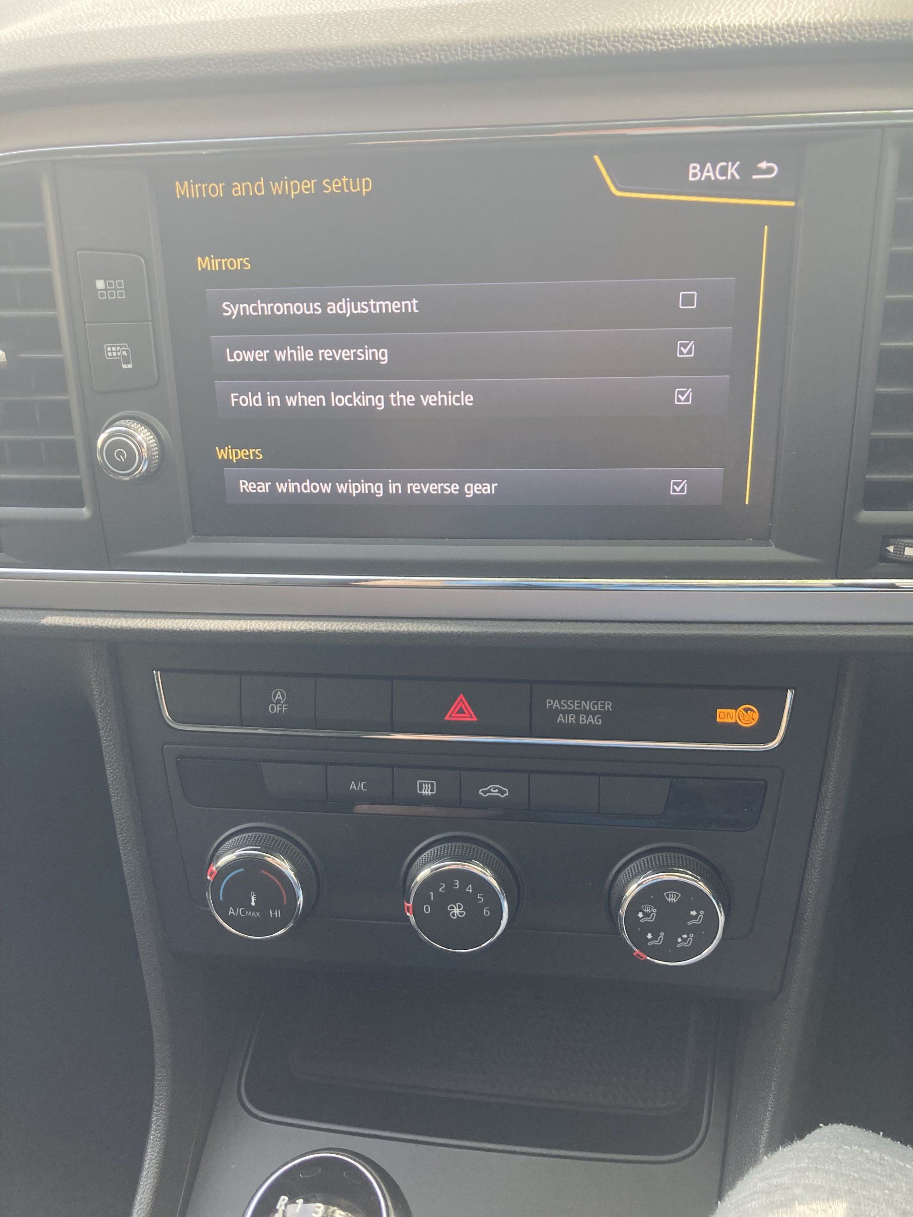

Recently bought a 2018 Seat Leon Dynamic Technology 1.6 TDI second hand. Wing mirrors weren’t folding in at all, but the in-car computer had option under “Rear view mirrors and windscreen wipers” for “Fold in when locking the vehicle” and it had in the user manual that wing mirrors would fold in when holding lock button on key fob. I also have a Mk2 Leon which has the electric folding mirrors in good working order, so everything pointed to the newer one having these. Tried reseting the window switch method (as explained in various threads on here), that didn’t seem to work with numerous attempts, but noticed drivers side window switch was very loose, as if someone had tried many times before. Eventually got it taken to the garage it came from, they ordered a new window switch and replaced it, advising this usually resolves the issue.
After replacing the window switch, they called to say they found out that the car never had electric folding mirrors and came from the factory without. Got the car back and on the in-car computer, the option to fold mirrors when locking is gone, along with the option for lower while reversing. The garage say that when they replaced the switch, these options disappeared.
I can’t believe the car never had this feature, but had the option for fold the mirrors when locking on the in-car computer and reference in the user manual. I think the garage don’t want to pay to figure out the issue.
Has anyone ever heard of these options being there when the car didn’t have the feature? Can anyone point out where I can check whether the car had these from new? Any advice would be great

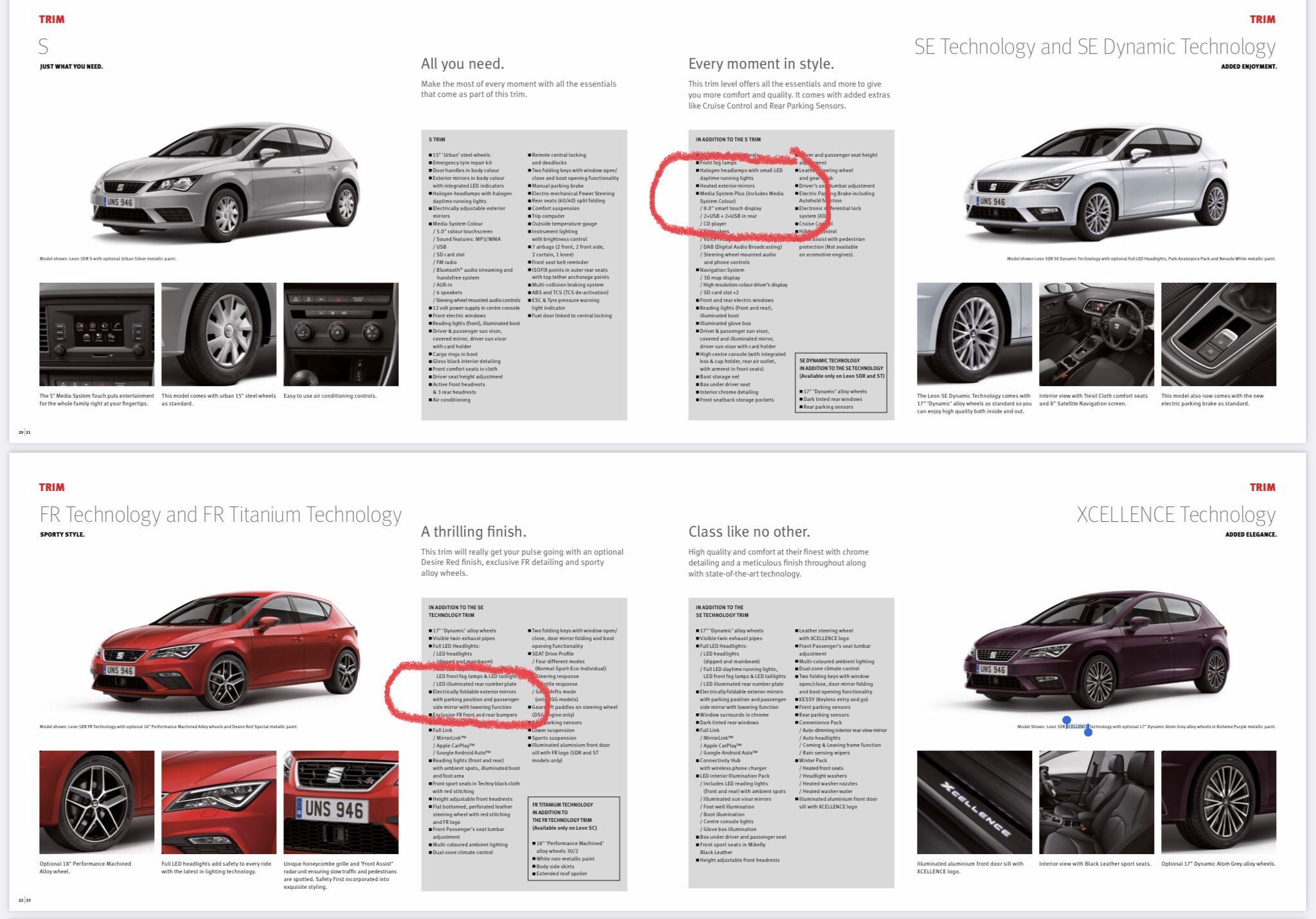

According to the Jan 2018 brochure at the link below;
  • the SE Dynamic and Dynamic Technology models had electric heated door mirrors as standard (pages 20/21) but not electrically folding or kerbside dipping (to aid parking) functions.
  • You you needed to move up to the FR Dynamic Technology and Titanium Technology models to get electrically folding door mirrors and the kerbside dipping function as standard (pages 22/23 in the linked brochure).
Link to brochure; https://autocatalogarchive.com/wp-content/uploads/2018/03/Seat-Leon-2018-UK.pdf
Screenshot of the relevant pages;
I couldn’t find an ‘options’ brochure for the 2018 Leon but did find one from May 2019. It looks as if there were changes to the Leon model line up in 2019 (was the mk3.5 facelift introduced in 2019?) as there’s not a Leon SE Dynamic Technology in this 2019 brochure, but there is an SE Dynamic model. On page 23 it shows that folding mirrors are not available for the SE nor the SE Dynamic models but they’re standard on all other models.
So irrespective of the model (name) change, it looks as if folding mirrors weren’t a feature on the Leon below the FR. Maybe a previous owner of your car had tried to activate the folding / dipping functions via coding, hence why the options appeared in the vehicle settings. However, if it is possible to retro-activate these functions then I’d assume it may be necessary for additional hardware to be fitted In addition to making coding changes.
If it had electric folding mirrors it would have a position to manually fold them on the mirror adjustment switch which has 5 positions, L, Off, R, Fold and Heat.
