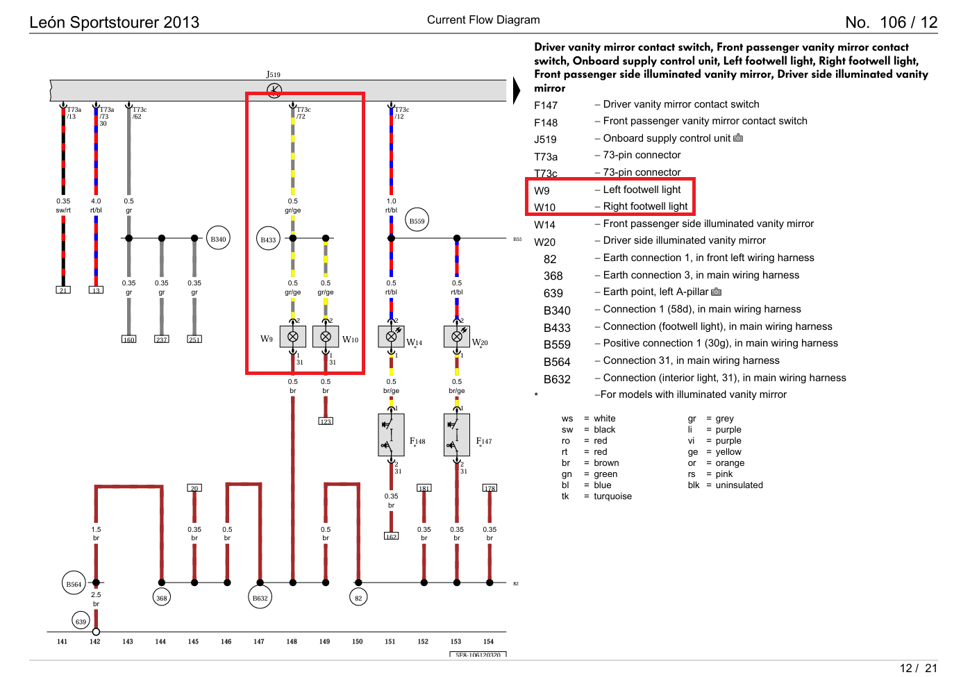

If You remove panels where footwell lights should be, probably wires is there somewhere behind other wires. if no, then they should be sourced from BCM T73C connector pin 72... grey/yellow cable for positive connection. If You want to retrofit it then Original LED (from face lift model) footwell light part number: 4E0 947 415, and connector part number: 8W0 971 832

If both lamps are missing, and the wiring is missing too, I would say it's safe to say they have never been fitted. Someone has probably been playing around with the coding, and ticked the box saying the lights are there. If you do a diagnostic scan, you will get an error saying they are not present. Easy retrofit though, one single cable from pin C72 of the BCM that splits to each lamp, and a ground (earth) lead from each lamp too, plus a bit of coding to get the dimming function working. I have posted a previous guide to this.

The menu will be on screen if someone had been playing with the coding. It's only a tick box, if it's ticked the menu will appear. As said if not installed from the factory the wiring will not be there. Any later retrofit needs wiring installing from the BCM to the lamps you fit in the slots already cut out in the bottom of the dash panel as it will not be there
I would start with looking at BCM T73C connector pin 72... grey/yellow cable, if its there, somewhere should be connectors for lights. If its empty then its clear.
