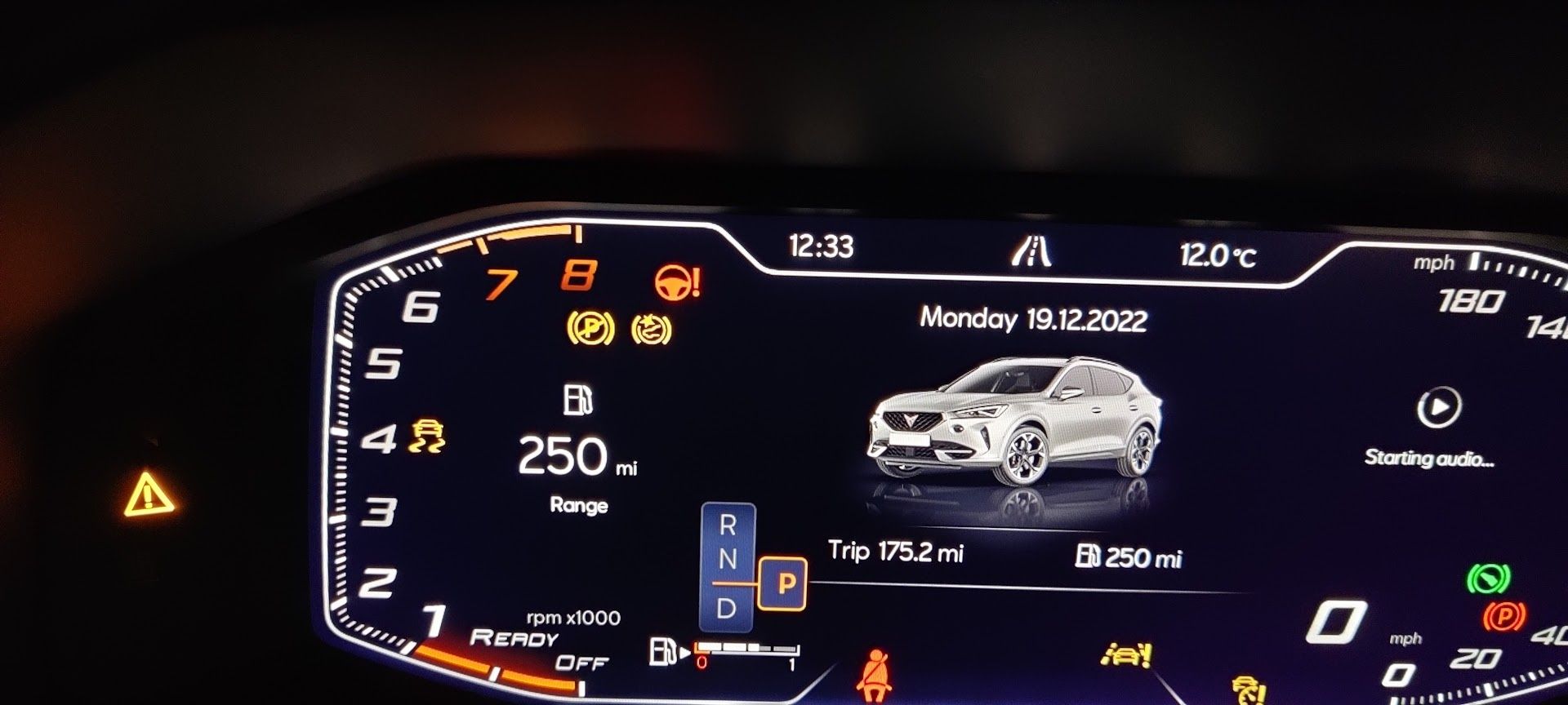

Hi All,
New Formentor owner, got my new V2 150 about 6 days ago, done about 160 miles.
Love the look and feel of the car and the driving experience. Well, most of it.
Today I was out driving on an A-road and the car shut down the driver aids, including the power steering assist, and almost killed me! (I was almost not quick enough to catch the failure and react accordingly - I had to pull it over hard with non-assisted steering to avoid going into oncoming traffic). Quite a shocker - LOL.
Anyway, there are 9 lights on the dash now and I've called SEAT/VW who are sending a mechanic.
So the reason for the post is to see if any other owners of brand-new Cupra Formentors have had the same thing? Anyone else experience this?
This is the dash when I start-up:
And these are some of the lights that go on:

Jesus... Happy to say I've never experienced that, or heard of it before. Good you're okay! That right there needs fixing

Well, at least it tells you to take it to the service, how else would you have known???:eek: NOT FUNNY at all and its also the first time I see so many systems failing and especially failing to control the car. Could be the next time you start it up to have all disappeared but that should not comfort you, better to still be there so the dealer can take a serious look at it. It is common, even in mine, to have thus far a few glitches, like the park pilot or emergency braking or manoeuvring to show being temporarily off but never a case of not been able to control the car. On my next start up they disappear, also the radio/infotainment system failed to start /load a couple of times, I long pressed the power touch button a couple of times and it came back to its senses.

First time I've heard about this type of catastrophic failure and I am here off and on for almost 2 years.
Usually people complain their front assist is not working but never did I hear about power steering issue.

My 2.0 190 went crazy a couple of months after getting it.
lots of warnings coming up on the dash ( I think I had 7 of them ) a few mins after starting the car.
It turned out to be a wiring issue although they wern't very forthcoming with where the issue was.
No issues since I got it back.

Got it to SEAT Milton Keynes and they looked at it and found the steering rack had broken (although I think it was the pump or controller as I was still able to drive it, with a lot of effort, but still able.)
Cost - about £2,400 normally, but of course, it's covered by the warranty.
Problem - no parts! they have an Ateca there that uses the same part, and its been on jacks "for weeks" (Service manager was very open and honest). I've asked the finance company to cancel the car and contract, will see where that goes.
