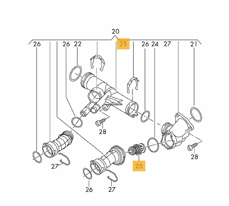

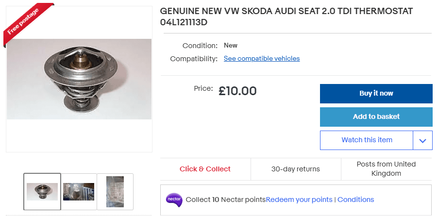

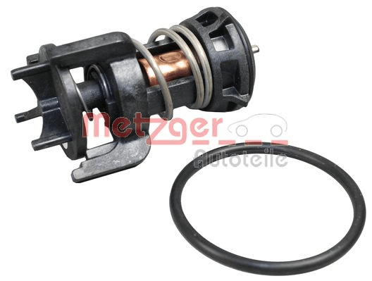

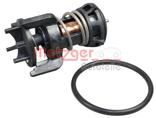

Thanks, yes good points - I did notice following posting this there are two versions of thermostat and my part catalogue with VIN lookup usually lists exactly the correct part but it still offered two versions JOOP 04L121113C or GEIGER 04L121113D - looking at my engine the housing I can see is the one linked to the more unusual plastic thermostat design you posted a pic of which is the JOOP version 1.
Mine is the twist to remove version 1 vs the unbolt to remove version 2.

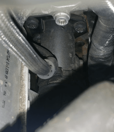

Right - these are pics of the codes on my old housing.
04L.121.111 is the housing that the thermostat sits in. There appears to be no specific version number.
I can see the t/stat and it does indeed look like this:
Looking at the t/stat, there is an amount of debris (sand, silica gel leftovers, general crud?) in there. Tried to take a photo but hard to show properly.
