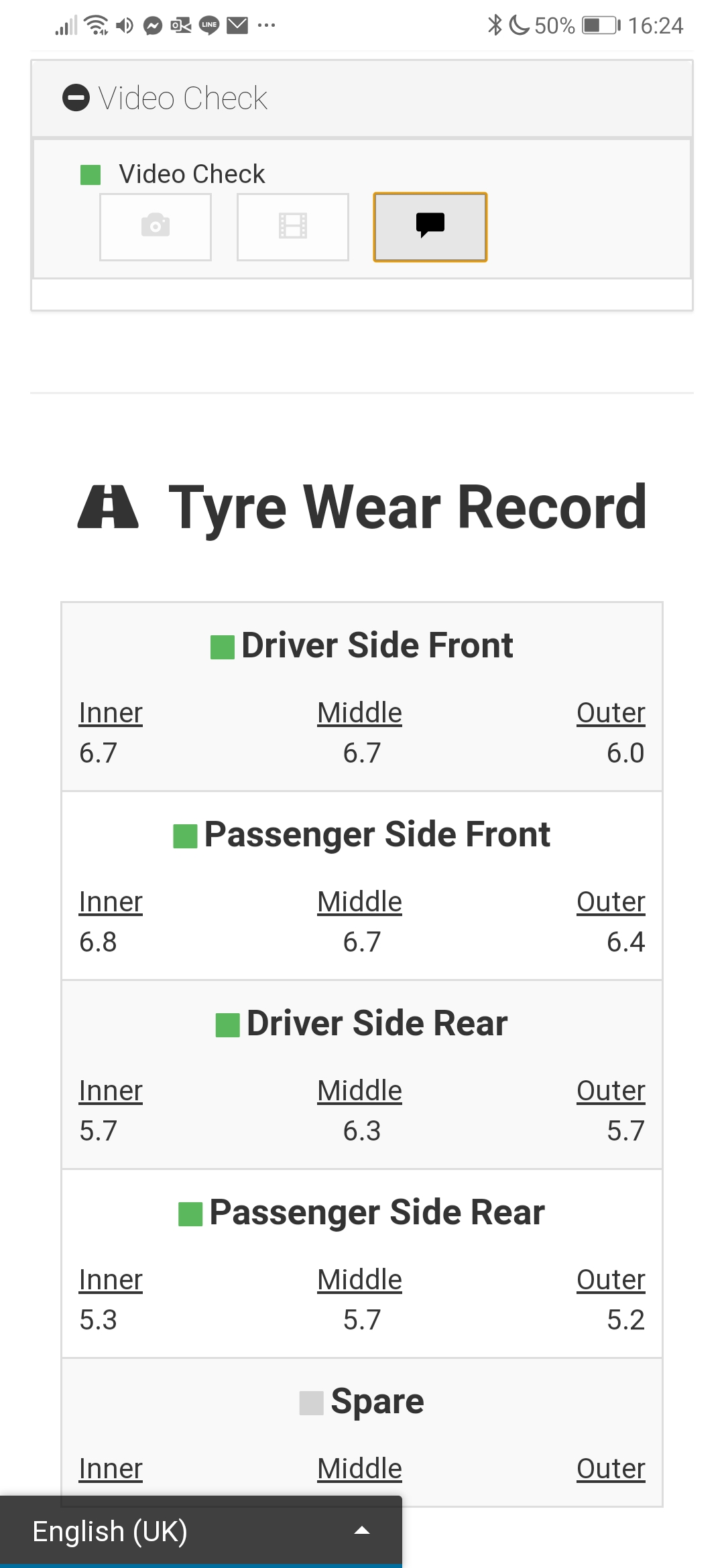

According to Seat they're not split ‍♂️. Don't know who to believe vw specialist or stealer... Will have to get it in the air to look myself now. Not sure what I'm looking for where exactly is the rear bush on the front arm. Perhaps old Google will help me.
Although I must say my front tyres are wearing more on the outer edge. Only been on for 3 weeks started at 7mm, is that something to worry about?
Front tyres always wear more on the outside edges, going round corners does that. Front nearside is the worst, 'cos roundabouts. Typically, if you've got worn suspension the wheels will end up toed out rather than in and the tyres will wear more on the inside.
